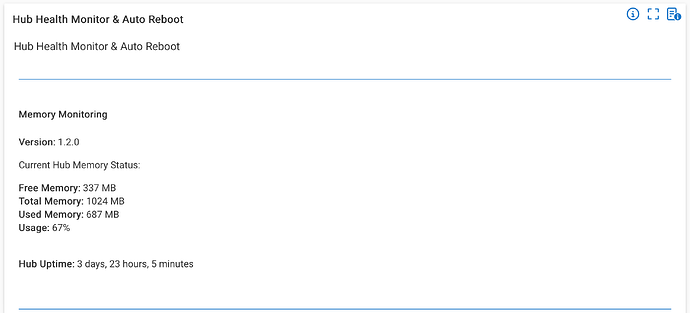

[RELEASE] Hub Health Monitor & Auto Reboot Application
NOTE: This app has grown in scope and been renamed to: Hub Health Monitor & Auto Reboot
I've been meaning to write this app for a while, and finally got around to it today with my new best mate, Claude - this app is standalone and requires no additional drivers.

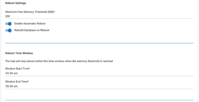

  • Minimum available memory to trigger a reboot
  • Configurable Reboot window. e.g. 4-5am when you are asleep
  • Configurable polling intervals
  • Test Reboot function
  • Option to rebuild the database as part of the reboot.

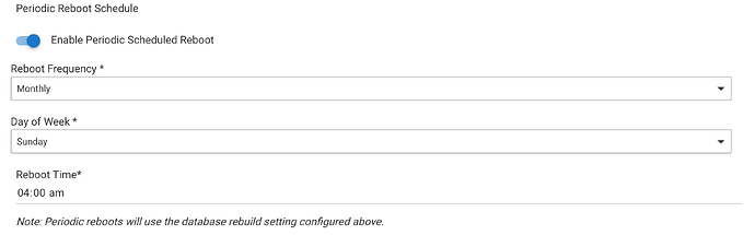

  • Optional Periodic scheduled reboot feature eg weekly etc

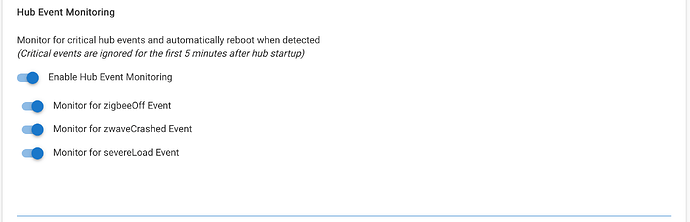

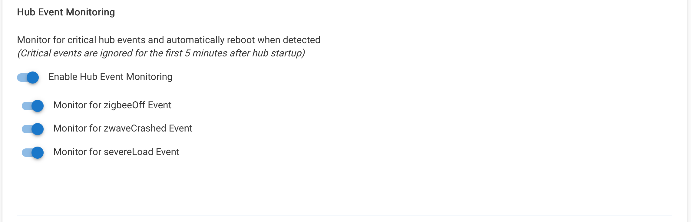

  • Reboot when critical hub events are detected (Zigbee, Z-Wave and Hub Severe Loads)

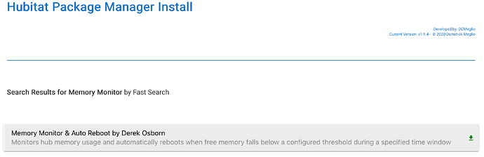

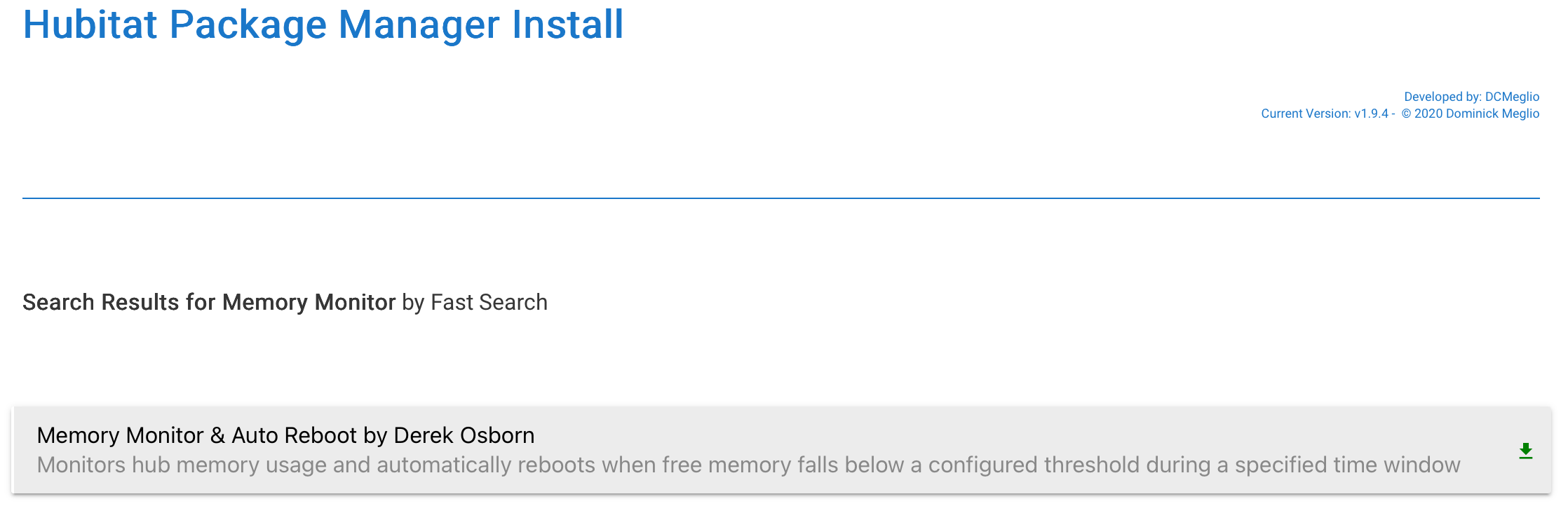

The "Hub Health Monitor & Auto Reboot" app is available via HPM (Fast search for "Memory Monitor"), and also on GitHub:

v1.2.0 - Renamed to "Hub Health Monitor & Auto Reboot" and added hub event monitoring for zigbeeOff, zwaveCrashed, and severeLoad events with 5-minute startup grace period

v1.1.0 - Simplified memory detection to use actual total RAM from hub data
v1.0.5 - Added hub uptime display and periodic scheduled reboot feature

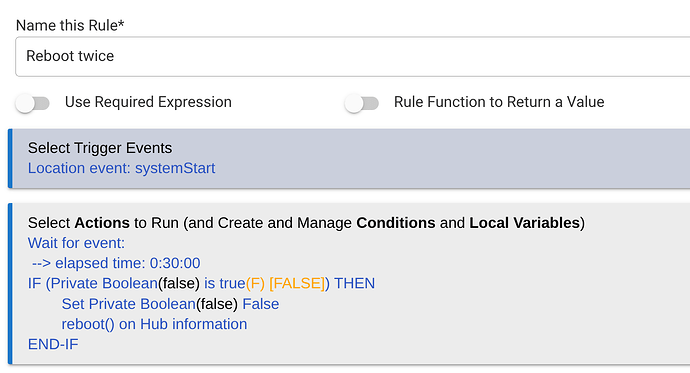

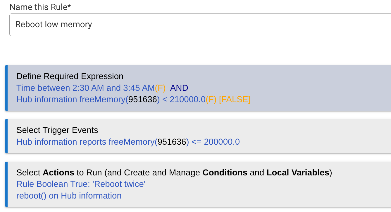

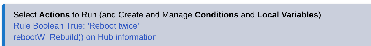

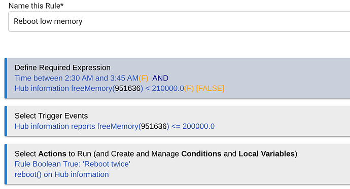

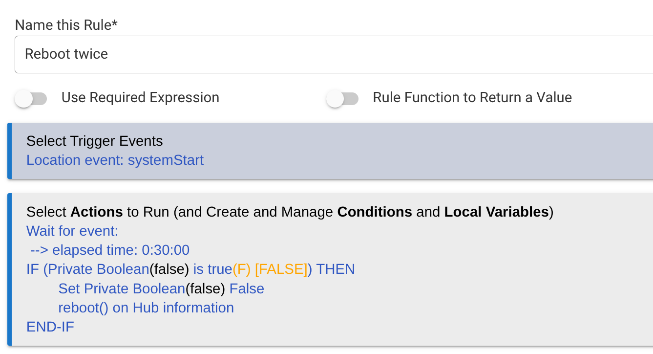

I've been doing a version of this in rule machine with a second reboot after 30 minutes which seems to add a nice jump in free memory from the first reboot.
Could you add the option to the reboot command, to include the DB rebuild option? -
I could get rid of some RM code, and would actually prefer to have a Groovy app - Looking forward to seeing it in HPM..
I’ve been using an RM rule for this too, but I’d always meant to make a proper app to make it easier for noobs to manage their hubs.
Good idea, I’ll see what I can do.
That is an option in the @thebearmay hub information driver. I saw @GuyMan question and checked and added it to my rule. I couldn't get that syntax to work with Send POST to:
Release:
v1.0.2 - Added option to rebuild the Database on reboot
This uses the /hub/rebuildDatabase endpoint instead of the /hub/reboot endpoint.
EDIT: Now in HPM:
Before 2.3.7.14 the /hub/reboot endpoint with the additional rebuild parameter works; from 2.3.7.14 on that option is replaced by the /hub/rebuildDatabaseAndReboot endpoint.
Cheers, I'll update the app,
Release:
v1.0.4 - added import url and updated endpoint for reboot with db rebuild
Btw, if one of the more experienced devs can assist, I've broken my HPM entry for this app and can't work out what I've messed up. It's the first time I've published an app to HPM (my other projects are drivers), so I've prolly missed something obvious. :man_facepalming:
https://raw.githubusercontent.com/dJOS1475/Hubitat-Memory-Monitor-Auto-Reboot/refs/heads/main/packageManifest.json
https://raw.githubusercontent.com/dJOS1475/Hubitat_WU_Driver/refs/heads/main/repository.json
Need to have a version parameter in the main metadata.. Usually after the author..
do you mean in the PM or Repo file?
EDIT: NVM, I realised you meant PM file.
I've moved the version to after the author - I assume I dont need it in two locations?
	"packageName": "Memory Monitor & Auto Reboot",
	"minimumHEVersion": "2.2.1",
	"author": "Derek Osborn",
	"version": "1.0.4",
	"dateReleased": "2025-12-31",
	"releaseNotes": "v1.0.4 - added import url and updated endpoint for reboot with db rebuild",
	"communityLink": "https://community.hubitat.com/t/release-memory-monitor-auto-reboot-application/160272",
	"apps" : [
			"id" : "75008c0e-a035-4bfb-ad92-fd9c0f690874",
			"name": "Memory Monitor & Auto Reboot",
			"location": "https://raw.githubusercontent.com/dJOS1475/Hubitat-Memory-Monitor-Auto-Reboot/refs/heads/main/memory-monitor-reboot.groovy",
			"namespace": "dJOS",
         	"required": true
That looks like it should work
Cheers, I'll check HPM in half an hour and see if it reappears.
Ok, it's finally fixed and working on HPM, I found one other silly mistake in the repo file too. :man_facepalming:
Thanks @thebearmay for the help, much appreciated. :pray:
