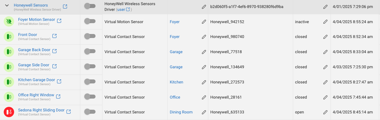

Installed, with child devices setup, you devices tab might have something like this:
