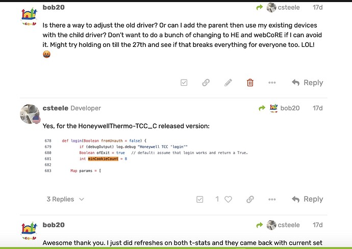

I made the change from 8 to 5 and things are working. We will see if it's still working after the maintenance.
I did find that I had to use the thermostat ID from the Resideo app. You still get the ID the same way using the TCC website. Maybe something happens when you do the import from the TCC app to the Resideo app.

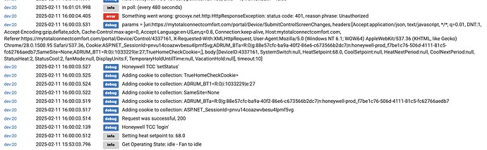

So I'm missing heating set points. Day 2 of it missing the 4PM change on 1 or other of my t-stats. Here is the log from today's miss.
You’re showing five cookies in the logs. If you scroll up a couple of messages you’ll see where I’ve advised others to make a change to reduce that count to five. Give it a try, see if it works for you also
Are you referring to the mincookiecount=5? I did that change before Honeywell did the system upgrade on 1/27ish.
The Honeywell site is telling us you are Unauthorized (code 401) The reason is that one of the cookies is invalid/incomplete. your 5th cookie is "TrueHomeCheckCookie="
My normal set of cookies is a LOT larger than 5 and I never get that particular cookie.

There's a cookie or two we have in common but fewer than I'd expect. As mentioned before, these drivers don't care about the cookies, it just saves them up to spit back out. Spitting them back out yields code 401, unauthorized.
Analyzing your logs and 'translating them" into plainer english is about all I can do, since I don't know how Honeywell is getting us here.
