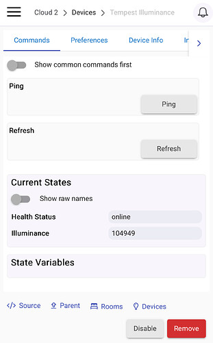

Here’s an example of what I’m talking about.

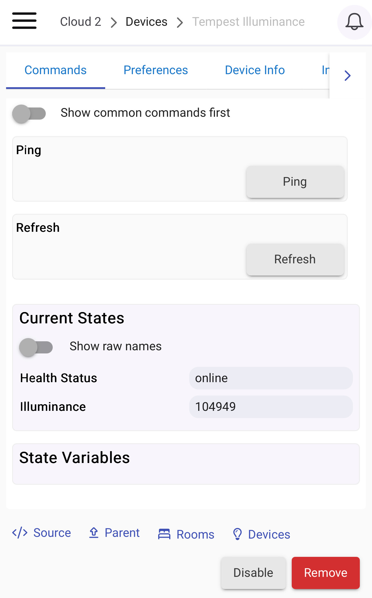

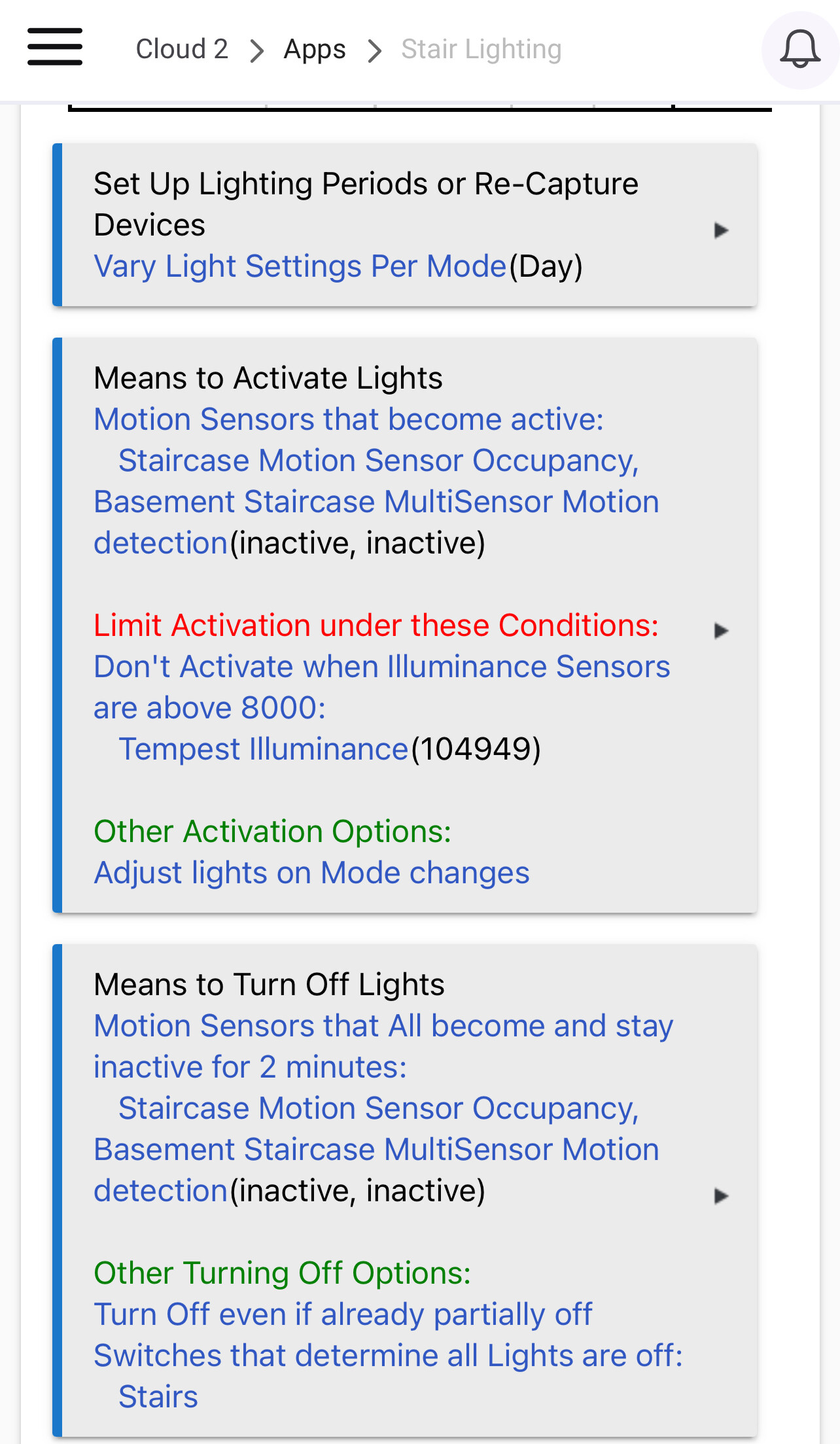

I have a rule to not turn on the lights if illumination from my tempest is above 8000.
The rule shows it’s one 10,000 from earlier this afternoon. But now, it’s below 8,000 and the rule hasn’t updated to reflect the new value.

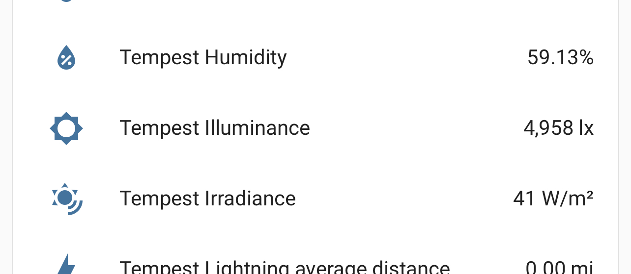

In HA it’s showing
In HADB child it’s showing:
I have pressed initialize but it’s made no difference.
You said you are migrating between hubs. Is it possible you have multiple instances of HADB running between your multiple Hubitat hubs?
Yes actually I do. Should I disable the other instances?
Yes. Should only have one active and pointing at the same HA installation.

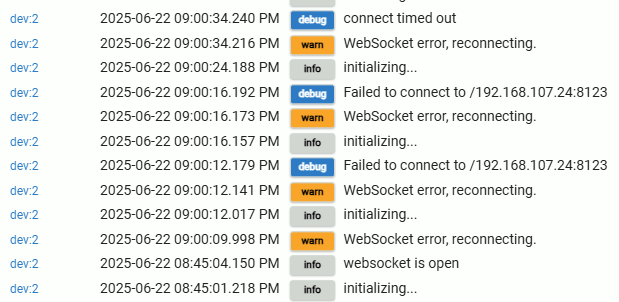

Thanks... I dug into this a little more since all my rules were broken... found this in my logs.
Went back through and retraced the steps for setup, and found in HAOS, I was missing my long lived access token. So created a new one and updated the app. Hopefully this is the smoking gun for me.

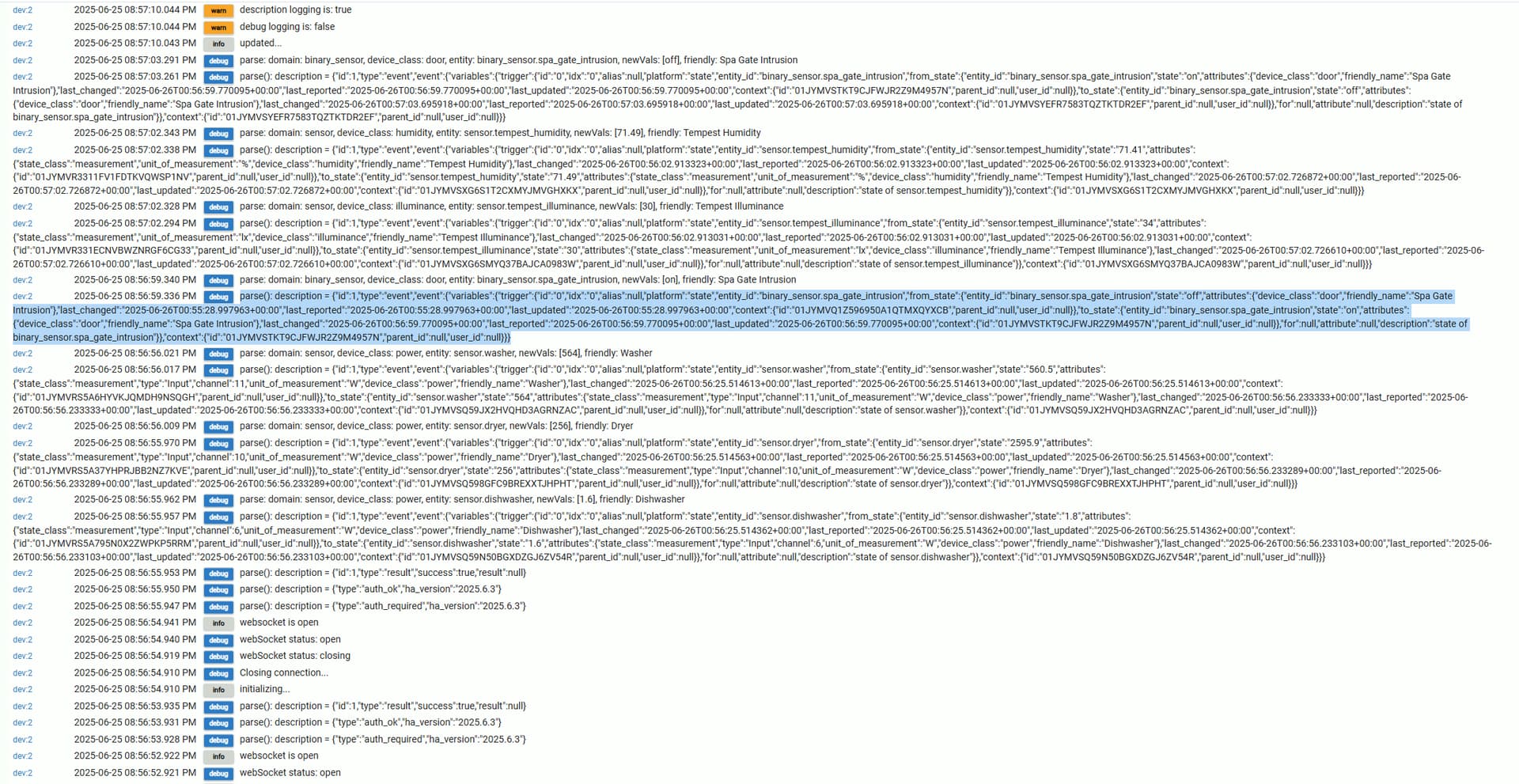

See the attached debug log:
Thank you for any help you could provide.
As your logs are showing, it is a binary sensor with a device_class of "door" which is essentially a contact sensor. This is what HADB use to define the device type to map it to (door --> contact sensor). The mention of intrusion is only part of the default name given by HA and can be change to anything you like.
