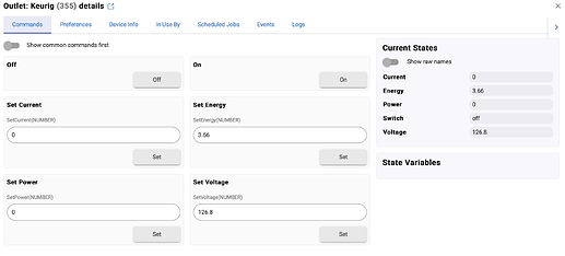

I do this for devices that I paired with zigbee2mqtt but use in Hubitat. Here's an example for an energy monitoring outlet. Like HADB, outlet control is bidirectional. And my virtual device driver permits all the entities shown to be populated in the virtual device.

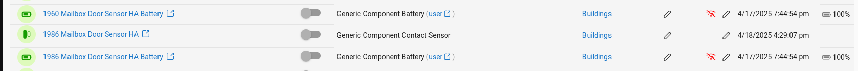

When I updated HA and it restarted the battery level device in HADB is showing offline on my devices section in Hubitat. I have several battery power devices coming from HA right now that consist of Moes Door/Window Sensors and Tuya Water Leak Sensors. The battery in the health status shows offline and has the red wifi symbol. The devices however all function properly with no issue. It is just the battery entity showing offline. I am currently using the most recent version of HADB in HPM for reference.
I removed the battery from one of the devices and left it out about 10 seconds but this did not change anything.

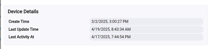

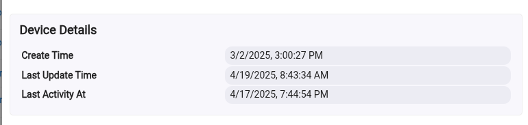

The devices started to show offline several days ago but when I go into the devices info tab it shows activity since then. I am attaching a screen shot of the devices I took the battery out of and another device. The one I took the battery out of shows the last update as of today. The other device shows the last update of 4/13 but has activity on 4/17.
Device I removed the battery today:
A different device that also shows offline:
Is there a way to get the battery entity to not show offline?
What does the HealthStatus attribute report for the battery device?
Anyway the "online" status is relevant for a device but not so much for its battery. Much time may elapse before a change occurs in the battery status even though the device itself reports activity.
I don't know what Hubitat use as a criteria to decide when to report a device as being offline.
The health status attribute for the battery showed offline as well. It isn't a huge deal because I have noticed in the past when the level would change they would come back online until another update and HA had to restart. Then offline again. Also I have notifications through HA as well for those specific devices.
Here is an odd thing though, but may make more sense to you. I installed something there today and had to restart HA. When I did the battery devices showed online again. Maybe it triggered communication or something.

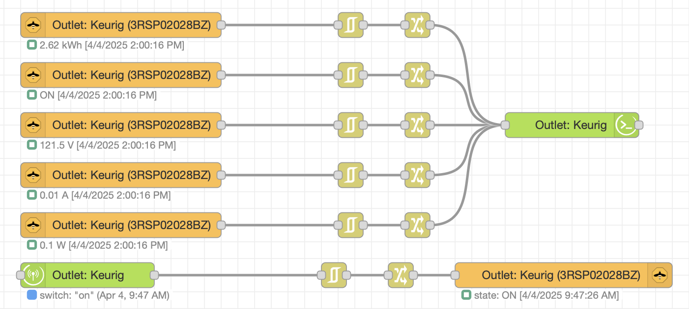

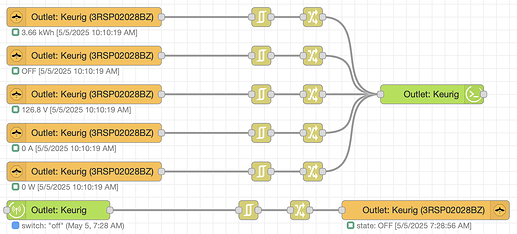

I also didn't like different entities for a single physical device coming in as separate Hubitat devices. So for some of my devices, I bring them into Hubitat in the following way.
  1. I write a simple virtual driver that has all the attributes/capabilities that I need.
  2. I import the HA device into Node-RED (if the device is a zigbee device, then I directly bring it into Node-RED using a z2m pallette).
  3. I create a simple sequence in Node-RED to populate the Hubitat device based on input from the physical device. If the z2m/HA device is controllable, I also create a Node-RED sequence that controls the z2m/HA device based on the state of the Hubitat device.
This meets my needs. Here's what the Node-RED sequences and Hubitat device look like - in this example for a zigbee energy monitoring plug:
I started doing this several years ago - before HADB was available.
Also, tagging @ritchierich - who has considered alternative ways of achieving a similar end result.
