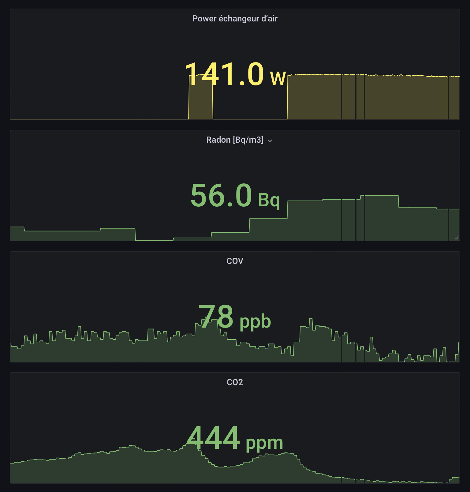

For the benefits of people here. A few days ago, Home Assistant just added native support for BLE devices, and in particular, support for AirThings devices, which I have. I opened a pull request to add support for CarbonDioxide, Volatile Organic Compounds and Radon Short Term Average sensors. Pull request is here:
I am running this right now and it works great. I used this to automate turning on and off my air exchanger based on the readings and to export the metrics to Prometheus to plot them in Grafana.
