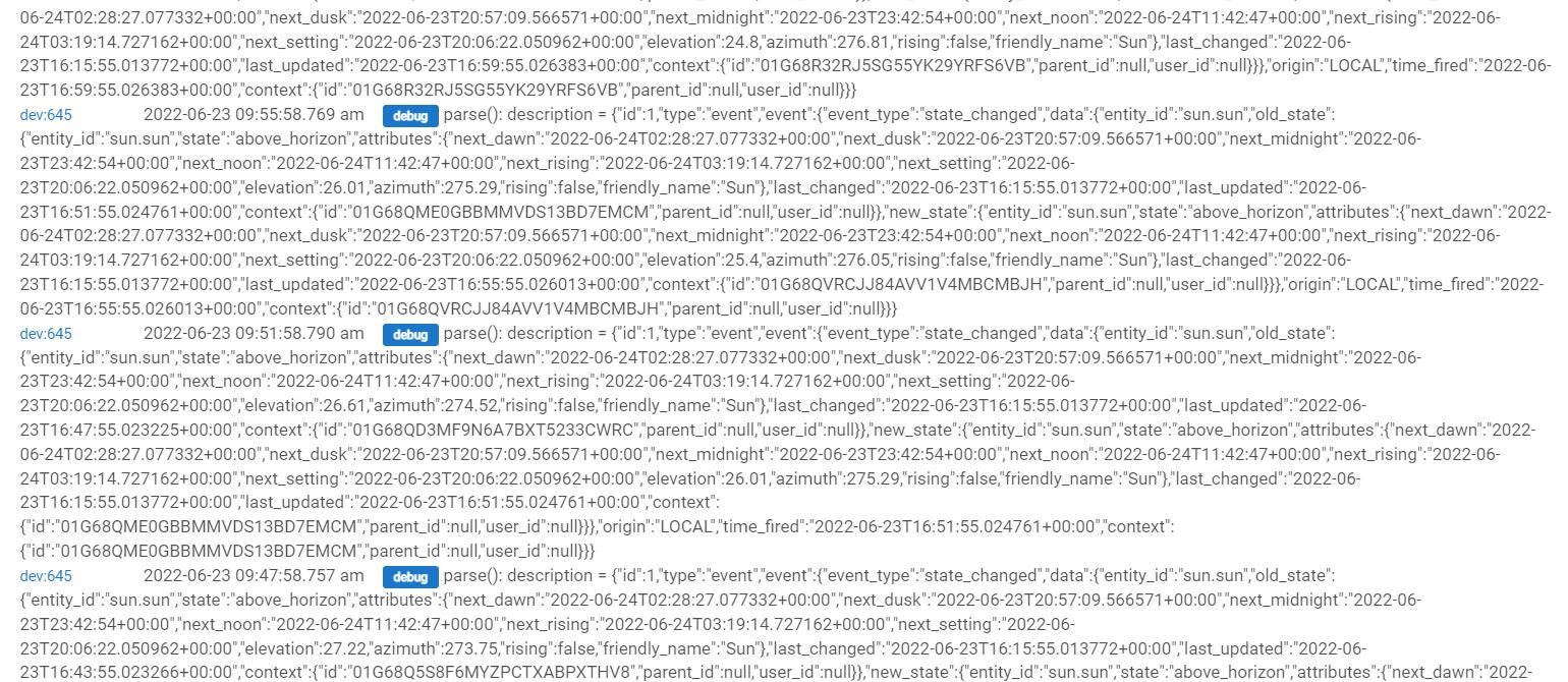

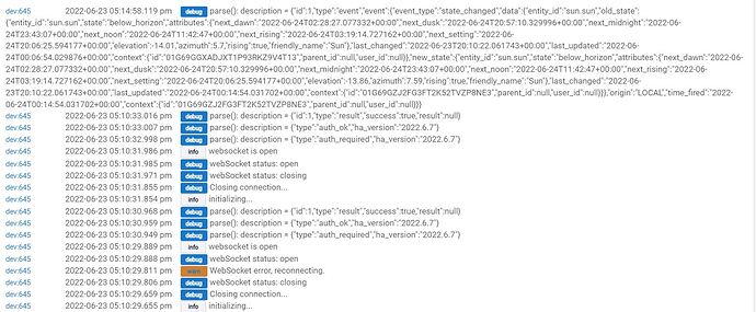

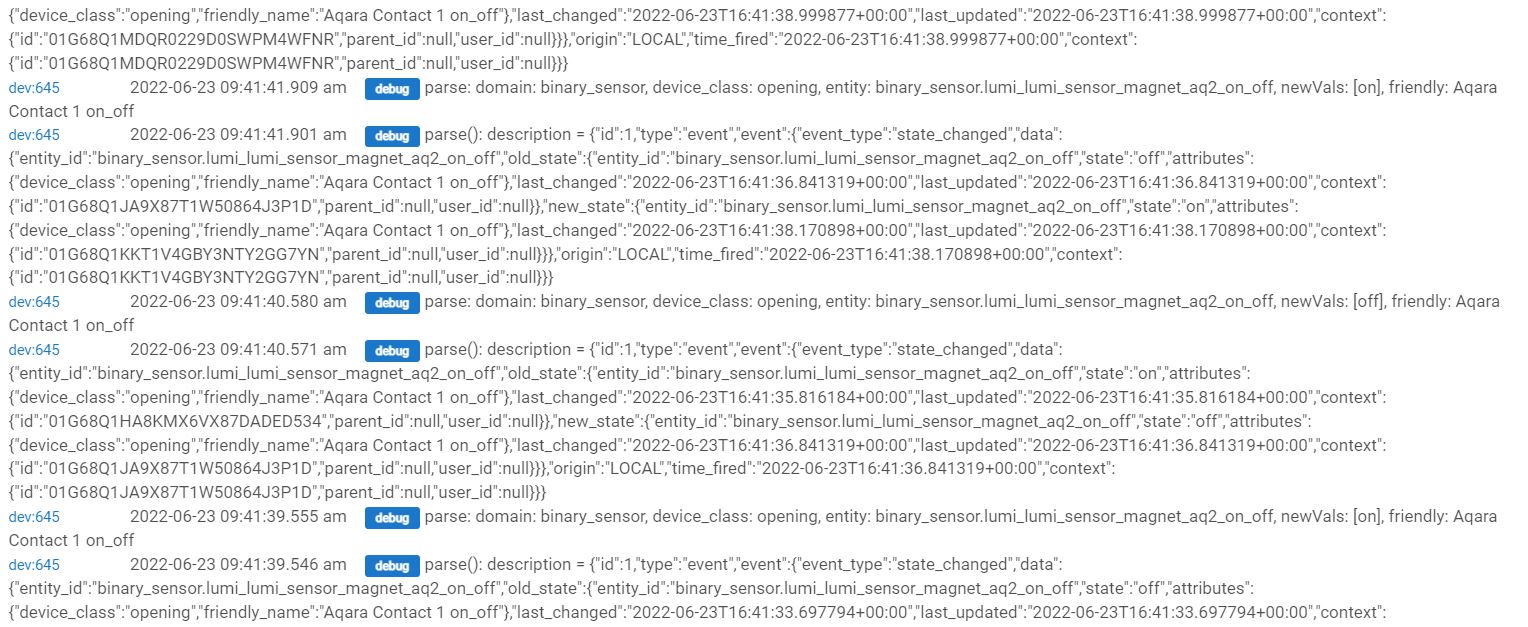

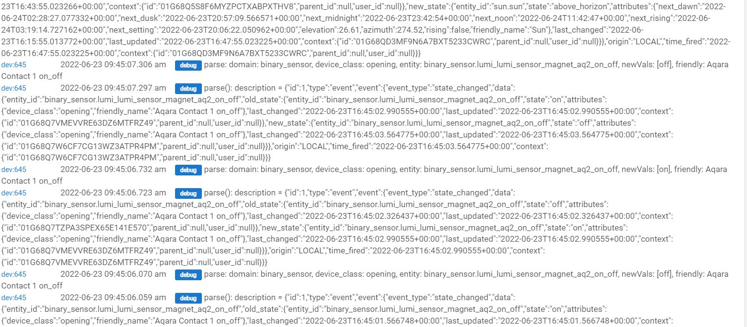

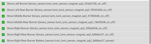

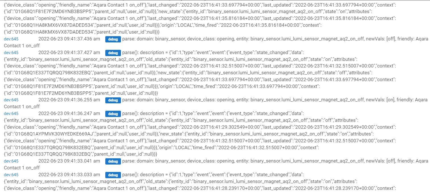

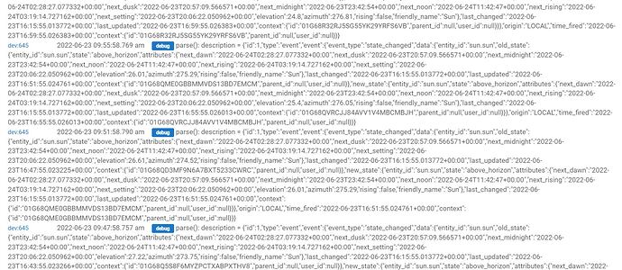

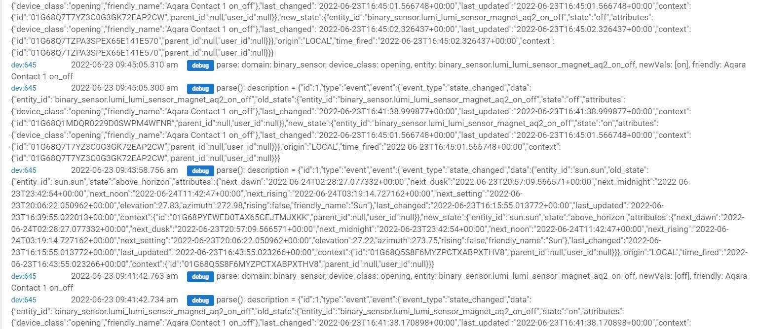

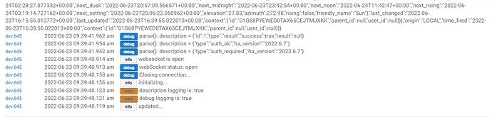

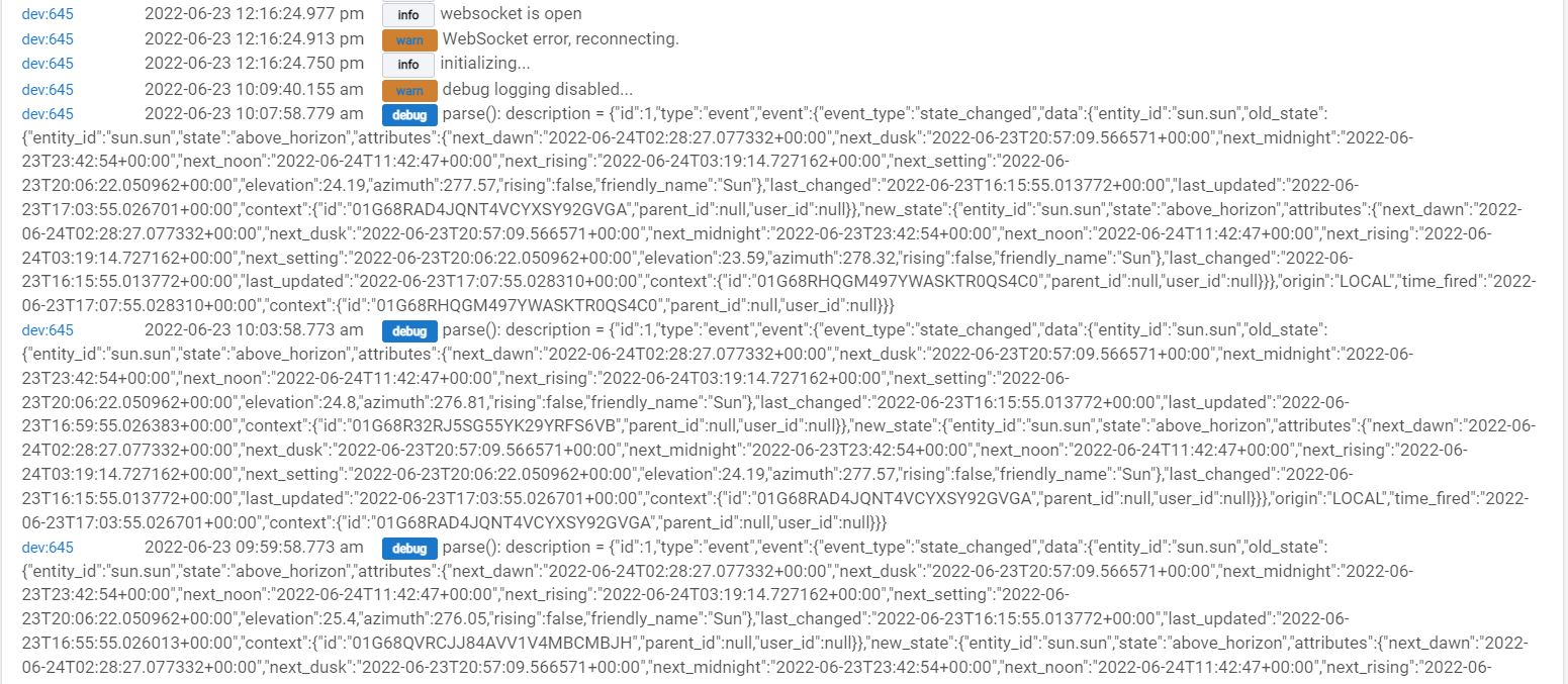

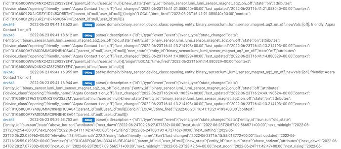

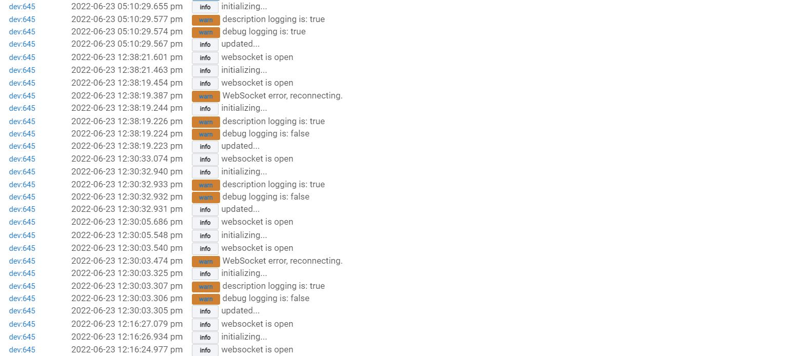

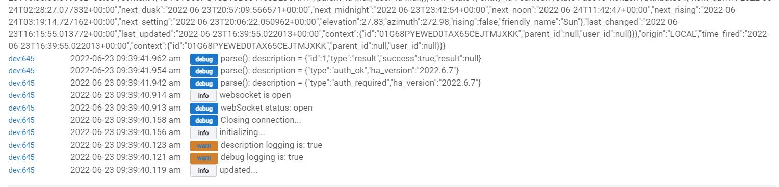

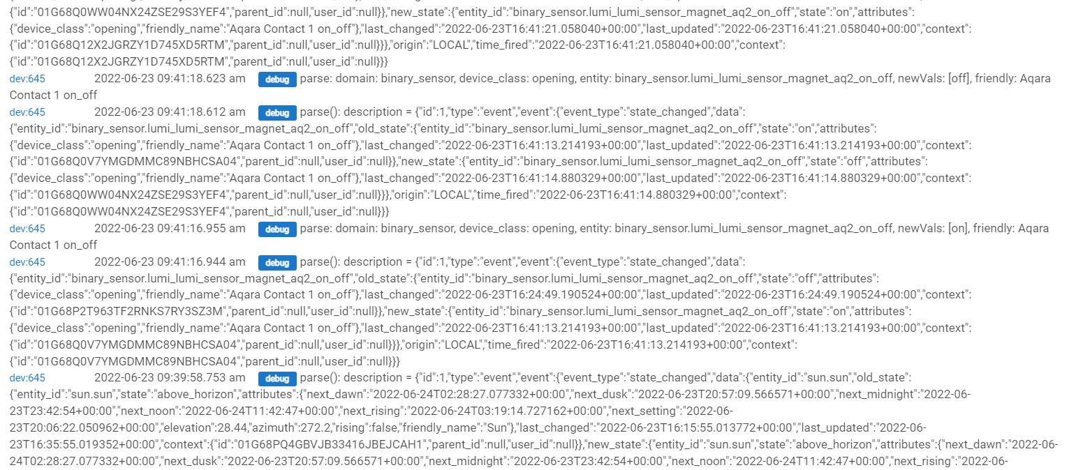

Funny...I went to turn on logging, and found that battery events showed up for one device that I had tried to get battery info for previously but it hadn't shown up. What I did for that device was:

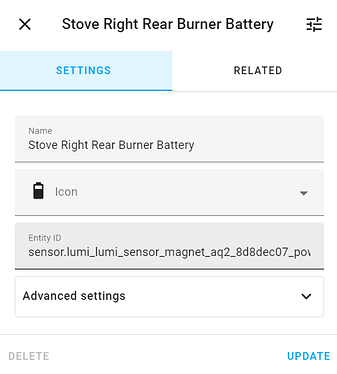

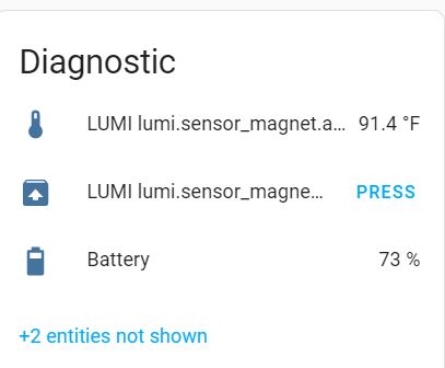

Clicked on the Battery option in the list below for the device:
The "Stove Right Rear Burner Battery child didn't show up for quite a while so I figured I was barking up the wrong tree. But I guess it just too, a long time to report...if this is the way it should work, then I'll just do the others as well. If there is a way that the battery info can show up in the same child details that has the open/close info that would be preferred, of course.
Checking for understanding... You were saying that giving it that name and saving had the effect of enabling the battery entity, correct? It wasn't that it was always enabled but the name change caused it to start working somehow?
Because we use the generic component virtual devices, there isn't really a possibility to add the battery info to the same child as contact state
Thanks...and yes, giving it the name and saving seemed to allow it to show up in HE as a device (at least none of the other contact sensor's battery info has appeared).

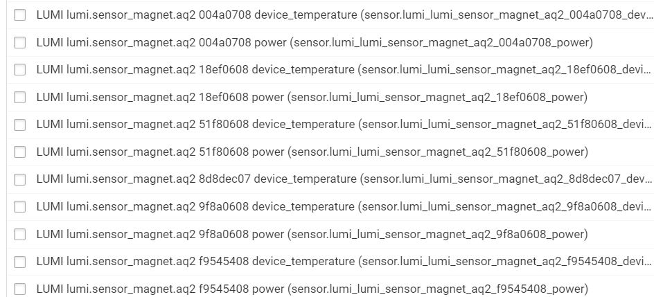

Ah, wait...when I set up Home Assistant Device Bridge, two entries showed up from each contact sensor in addition to the entities based on the name I used when I added the sensors to HA:
Looking at this again, I think I'm understanding it better now. It seems like providing a name at device discovery only names the "contact" part of the device, while the power (battery) and temperature reporting entities don't also get named for the device name I entered. Hope that makes sense. So I have three entries for each device:
The contact sensor aspect of the device, using the name I provided at discovery in HA
The power and temperature aspects of the device, which retain the lovely "gobble-di-gook" naming that HA uses...
One of the devices, 8d8dec07 only has a temperature entry in the upper section, because I had renamed the power entity for that device to "Right Rear Burner Battery."
Yeah, I know it's a bit of a crap shoot, but it gives me at least an approximate idea of how things are going w/the battery and when I should be watching it more closely. Over time I'll know better from change dates, which I track, how often I need to change.
Absolutely. Thanks for asking the questions - they made me think about this more and differently than I had been thinking about it. Off to do some more renaming...
