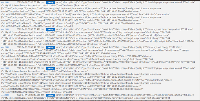

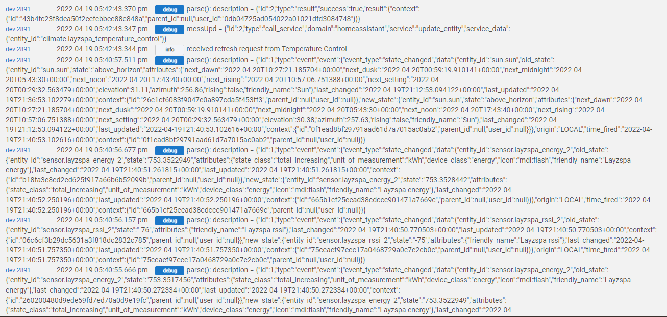

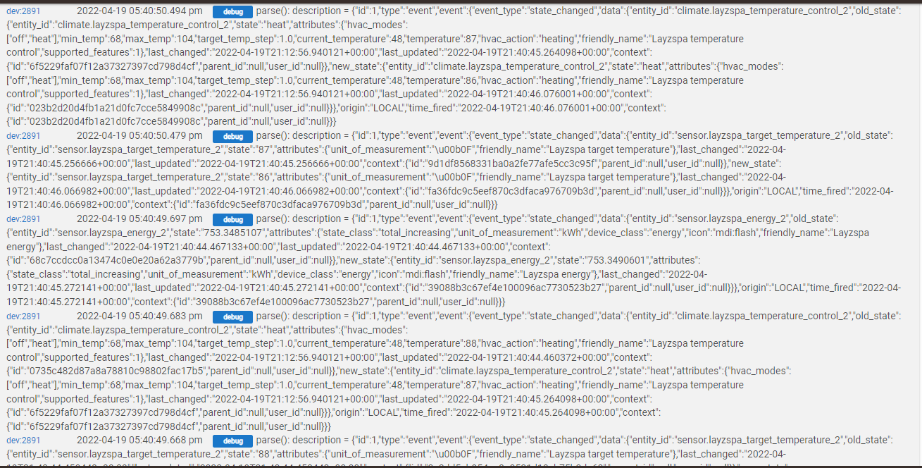

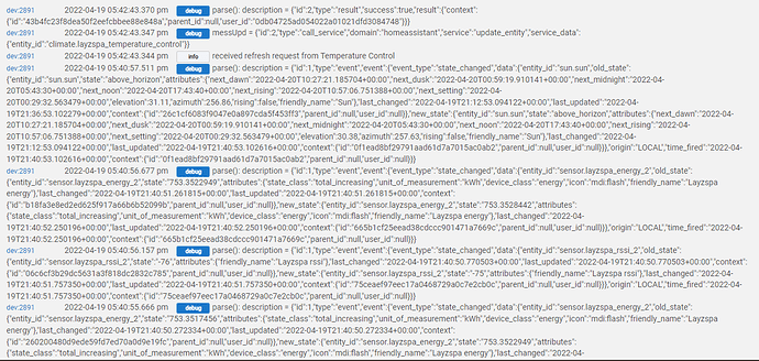

I have Home Assistant running for the sole function of bringing our MQTT enabled hot tub into HE. It had been working perfectly. I just discovered that at some point things stopped updating. The device to HA seems to working fine however, Hubitat doesn't seem to be reflecting the correct states etc. I've tried reinitializing the connection but no luck. I am totally clueless about where to start with trouble shooting this.
Turn on logging on the parent device and do some operations on the hot tub that would normally have shown up in HE. It'll be necessary to see what (if anything) is coming across from HA.
HOLY CRAP! a ton of stuff is flooding in with debug on
SOMETHING is getting through....
I wonder if I will have to delete child devices and re add. Man that will be a pain cause I have them set up with several things
Which attributes are you trying to track? Energy?
Temperature and also some switch controls
I only see energy and rssi in the logs you posted. Are you seeing temperature and switch state coming across? Is it configurable how often they report from the spa to MQTT?
I went through the huge amount of info and found that temperature is coming through.
Edit: Is it possible I made a problem by changing the device names in HE?
Edit edit....scratch that. I only changed the labels. the names have remained the same.
I think I'm on to something! I see that somehow the name became climate.layzspa_temperature_control_2
SOMEhow a second entity got created. hmmmm
Now...how to fix this
Just went in and added the randomly appearing second entities.
Those names come directly from HA. I would recommend looking over there in the configuration to see what happened.

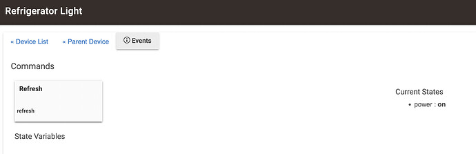

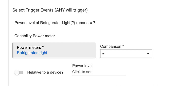

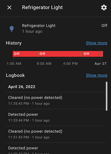

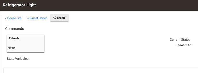

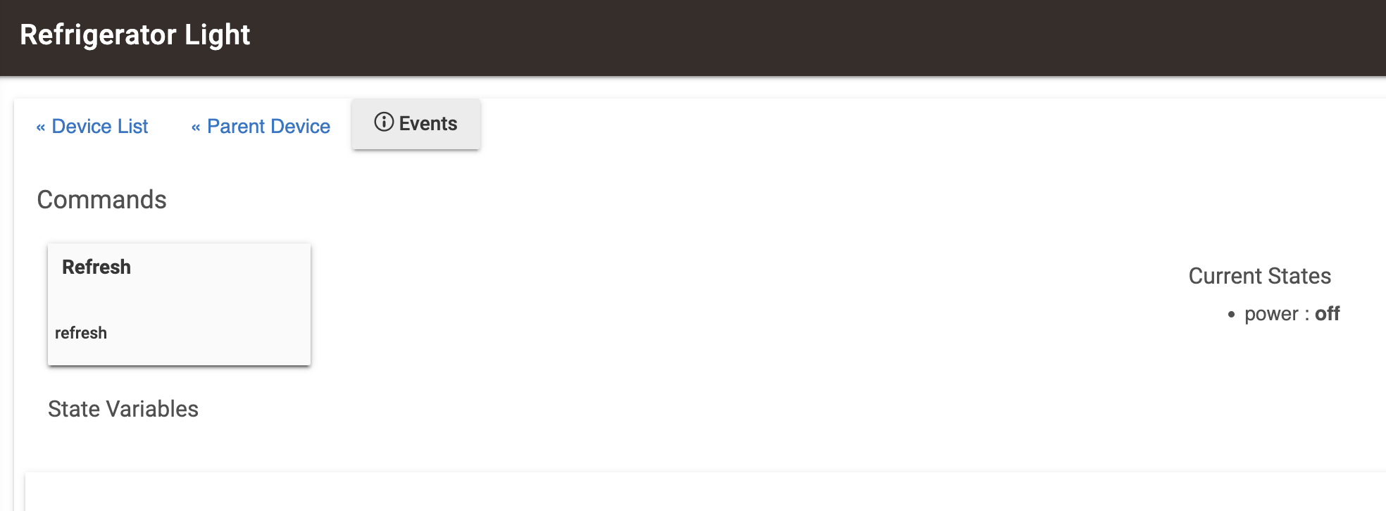

@tomw Wondering if anything can be done with this. I'm using Sense for my home power monitoring (Yes, everyone who said not to, I ignored you and did it anyway :stuck_out_tongue_winking_eye:) and for me it's working well. I've added the HA integration and it reports when devices turn on/off as using the Generic Component Power Meter driver</> that @mike.maxwell created for us.

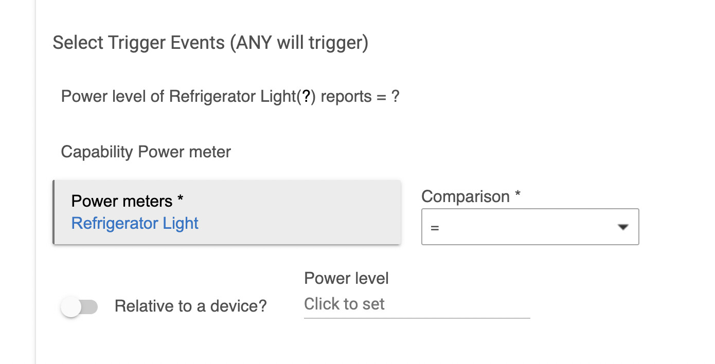

Unfortunately, I cannot use these binary devices in Rule Machine, because it's expecting a numeric value from a power meter, but the power status that HA is reporting is a string value. Can this be addressed from HA Device Bridge, or would this need to be a change that would require a modification of Rule Machine?
This is where the change should be made.
