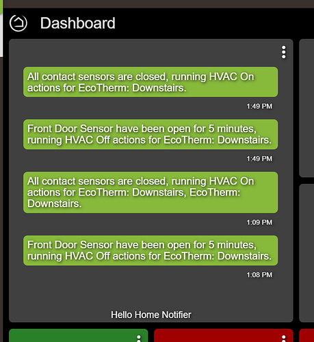

Hello Home Notifier (child)
Receives messages from the Manager and generates HTML display content for the Hubitat Dashboard in the
myText
attribute (works best in a 2x2 Dashboard tile).myTile
is limited to 1024 bytes; older messages are simply deleted. -
Defaults to keep only the last 10 messages it displays; this can be changed in the Device preferences.
