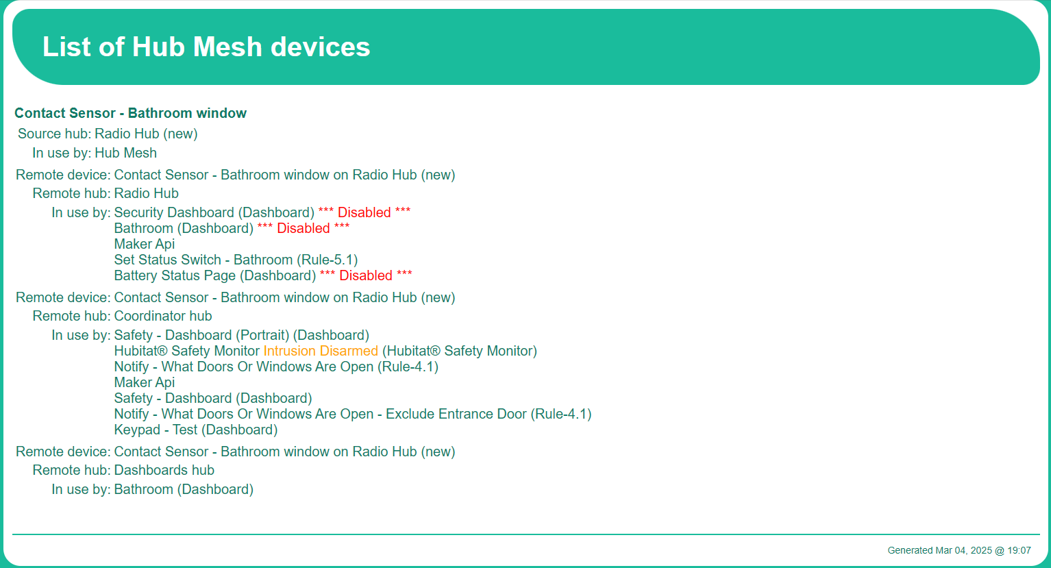

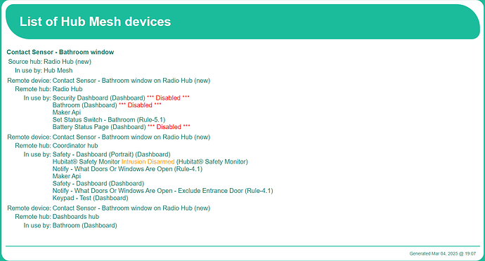

A search for a device using the Hub Mesh source/remote device relationship layout looks like this as HTML:
Note that every line that is for an app or a device on that page is a hyperlink to the HE app or device page.
The full device list looks just like the search result above, just with all devices on it.

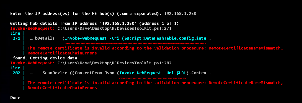

Yep, you have set the execution policy to accept the running of the script correctly. It is failing because the invoke-webrequest command is rejecting the certificate on the hub. To help me troubleshoot this further, can you tell me if you have added your own SSL certificate to the hub or is the cert you’re using the one that came with the hub?
I've added a check for PowerShell version in the tool now and if PowerShell is of version 6 or above, it will use the -SkipCertificateCheck parameter with invoke-webrequest. I have installed PowerShell 7.5 on another computer now and tested it on there, and I'm able to connect to my hubs now at least. @dnickel download the new version from Github and let me know how you get on :slightly_smiling_face:

So the scan fails and the IP.
You have changed the code with flags so it's nothing I have to pass as a parm invoking
HEDevicesToolKit.ps1?
From GitHub
$Version = "2025.03.04.1826"
FInger trouble, everytime I copy $Version = "2025.03.08.2219"
I get .1826 in the paste.
I deleted and downloaded the version from GitHub instead of editing it in PowerShell and trying to overwrite the code.
Works!
