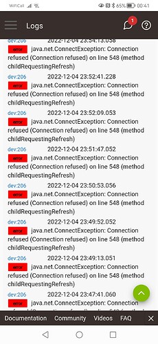

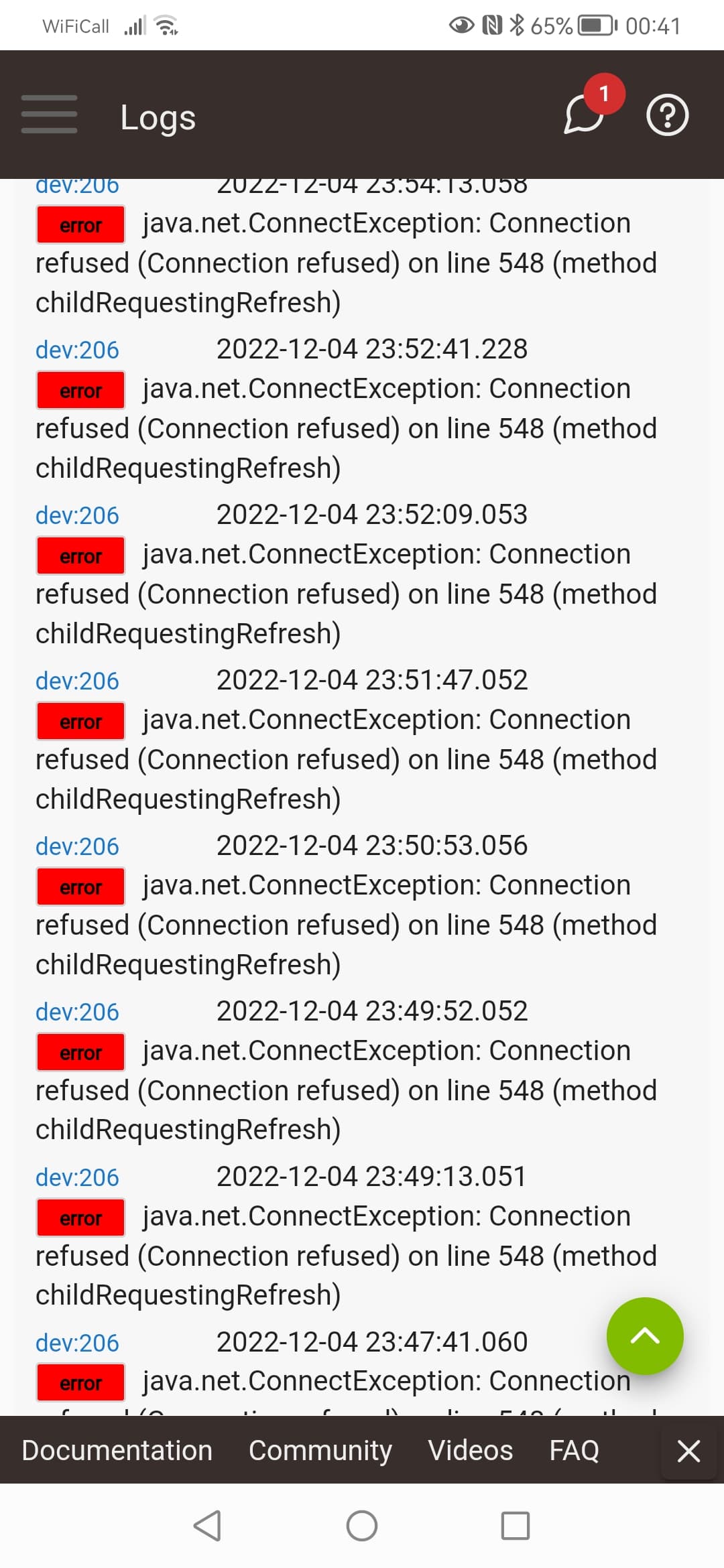

Your integration has been working seamlessly for me until 2 days ago. I'm not a techy so please bare with me.
Basically our ISP did some work on my router and all of the IP addresses in my house changed. I've managed to get Hubitat working again but the Heatmiser integration has stopped working.
In the parent app I've add the neohubs new IP address but to no avail. I've also added the Mac address to device network ID field but still no joy.
These are the logs if it helps. Please please guide me through this
Probably need to enable legacy API as with the person a few posts above.
