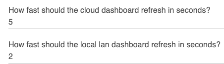

Looks like the HE dashboard (not to be confused with this app, Hubitat Dashboard.. shame on me for the confusing name..) does a refresh every 5 seconds in cloud mode. I'm refreshing every 30 seconds when in cloud mode. I can make it 5 seconds to match and make it a setting as well.

version 1.0.837 (beta)
  • make cloud refresh faster (2 secs)

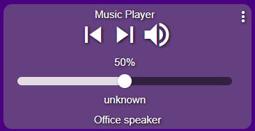

I updated the 'speaker' device type layout to use the same one as the new media player layout.. I tested on a chromecast which doesn't support many features like next/prev track or album art.. the tile will only show buttons which the device supports (play/pause, prev, next, mute/unmute, volume)
I also turned the animations off (except for the initial app open).. I like adding little animations to give the app a professional/polished look but I'll make sure any future ones are a lot smaller and not distracting
Speaker layout looks good. In order to allow for more items on the tile, can you allow tall as well as wide?
Play pause work once they've connected. Played spotify on a couple and radio on another. Can pause and play on each. Pretty slick.
What items are you looking for? If you're talking about Chromecast devices, mine don't support actions like prev/next track. 1 of my Google Mini devices doesn't have volume or mute attributes either so I'm hiding the volume slider and mute button.. I could still show them but I wouldn't know the current state (ie: does the mute button call 'mute' or 'unmute'?)
