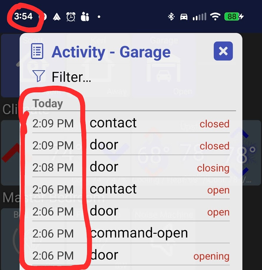

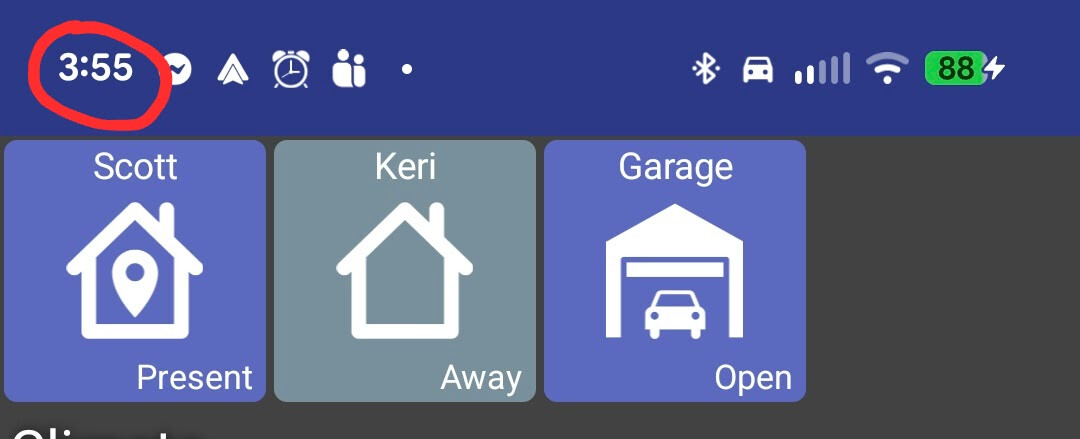

This issue still occurs. Got home today and realized HD+ was showing the garage door open, so I waited until I could see it and the door was definitely closed. Pulls down on the dashboard to refresh, and the garage door icon didn’t change. But HD+ knew it was actually closed. The culprit is using something else to close the door, in this case the wireless remote in my car. I normally do it through Android Auto, but I was running late and the backup camera was using the screen in the car so I just used the remote.
I looked at this - and also asked AI to try and figure this one out. Neither found anything obvious why this would occur – just wanted to ask some follow-up questions and maybe get some extra logging.
The activity dialog shows results directly from a Hub API call where the main screen comes from a different API (devices/all) so that doesn’t help too much.
What’s the garage door device driver? I have MyQ but because the MyQ driver doesn’t work anymore I ended up using a contact sensor.. so just want to check if there’s something going on there too.
As for HD+ the only way to really know would be to see the logs when the app is in debug mode. If you’re close to home maybe the phone is between wifi and cellular data? I know I have to do some extra work for geofencing because leaving the house there’s often a dead zone where your phone still thinks you’re on wifi and won’t switch to cellular yet
The Zooz Garage Door Opener. It creates a virtual device using the relay the controls the door and a contact sensor (I use a tilt sensor for this).
I can PM you the log file. I ran this particular instance through chatGPT and it seems to think the issue might be connection stability. But in the past I’ve had it happen while I was at home the whole time.

The best I could figure out (also using AI to help
) is related to moving between different networks (cellular/wifi). When the app detects a network change, it does it’s ‘cloud check’ to see if it should use the cloud endpoints or not and if that changes it’ll close all connections and re-create them (ie: from using 192.168.0.X → cloud.hubitat.com). On every change like this it should do a full refresh and then connect to the websocket (local only) so no future device updates are missed.
Here’s how I’m reading the logs:
06/19 15:54:18 D HubitatManager fetchAllDevices: FIRST_SYNC: 548ms: CLOUD: updated:8, devices:10
- at 15:54:18 the app does a full refresh and at this point I’m assuming the garage door is closed. I can’t say when you opened the garage door outside of the app but guessing it’s around this time
06/19 15:54:39 D DashboardFragment onRefreshing: pull-to-refresh started
- at 15:54:39 you do a pull to refresh (app is still in CLOUD mode)
06/19 15:54:42 D HubitatManager checkCloudMode: LOCAL: mode:MODE_AUTO, hasPermission:true, ...
06/19 15:54:42 D HubitatManager createNetworkEndpoints: connecting to LOCAL IP: https://192...
06/19 15:54:42 D DashboardFragment handleDeviceLongClicked: TYPE_GARAGE, {"attributes":{"door":"closed"...
- before #2 can finish the network changes to LOCAL mode which cancels the pull to refresh that was started a few seconds earlier. The app should do a full refresh here but it’ll take a second or 2 to get the update that the garage is open.
06/19 15:55:53 D DashboardFragment handleDeviceLongClicked: TYPE_GARAGE, {"attributes":{"door":"open"
- the next time you long-click on the garage it’s showing ‘open’ so I think this is what you were expecting to see 9 seconds earlier. I can’t tell exactly when the app got this state (I don’t log every device update to the log file as that would be too much)
Anyway, that’s my read of the logs. AI did find a single change that could help speed things up and it’ll be in there the next build.

I pulled up HD+ and thought “I thought I closed the garage door when I came in from mowing.” so I went and checked and it’s closed. The dashboard shows open. The device activity shows the close.
Thanks for the logs - I haven’t fully reviewed them yet but I did just push the changes I made a few weeks ago to try and address this. I think I was hoping to have more changes to test but this one seems worth it on it’s own. It should be version 1.0.2818 - hopefully it’ll make it’s way to devices in a day or 2
