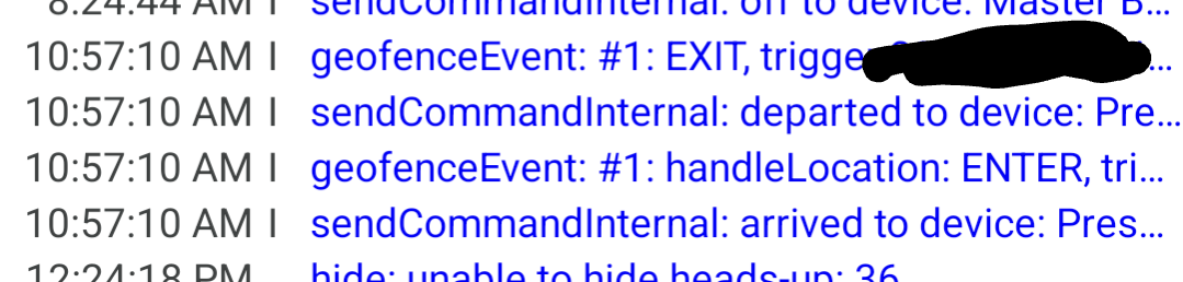

I keep having an issue where HD+ will update the presence sensor for presence tracking with a location about 1.5 miles away, which triggers a depart, but immediately (less than a second) sends another location event saying it entered the geofence.
It’s happening randomly on both my phone (Pixel 7) and my GF’s phone (Samsung Galaxy S24). It happens while we’re at home and not even using the phone.
I assume the app just gets the location from the OS, but I’m not sure if there is a way to see location changes at a system level. I can look in Google Maps and see my timeline, and it shows me taking my kids to and from school today from 7:08 - 7:47 but then says I have been home ever since.
HD+ has this in the log for 10:57:
I do have it set in permissions so that HD+ can see location all the time and to use precise location, and the physical activity.
Just wondering if anyone else has this issue or if there is something I can do to prevent this.

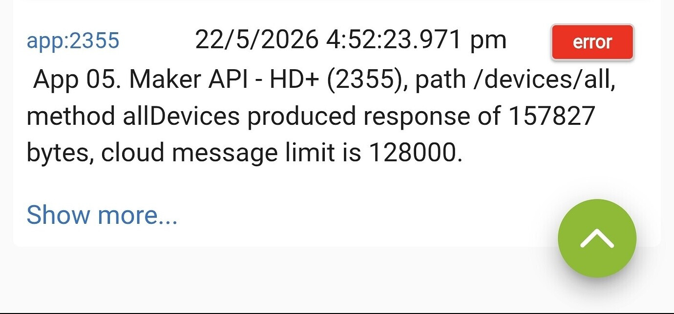

Guessing it’s Nest only. Can you send me the device details as seen via MakerAPI? Also, how do you detect and enter into ECO mode? Driver Capability List | Hubitat Documentation
I wonder if newer Hub versions log this now.. can’t say I’ve seen it before. Also, it’s good to know the exact cloud limit (128k).. don’t remember if that was documented anywhere.
How many devices do you have configured? I’ve got 118 devices and it looks like that API results in 68k. I’ve got 73 devices added to MakerAPI.
Of course some devices return a LOT more data than others.. look at this blink camera:

If I can detect or ā€˜guess’ when there’s too many devices to be returned via cloud mode I could break up the /devices/all request to a single /devices request and then fetch individual devices’ attributes.
There’s a link in the first post - apk download - You can tell you’re on this version if you see a check for updates option in about menu
I’ve did a lot of testing when I first implemented this and what I’d do is drive around and then go through the device logs looking for events like what you shared.. it used to take some time to go line by line but when working on the iOS version I did the same thing and this time asked AI to look at the logs and it reduced the process down quite a bit..
All to say that if you’re willing to send the logs I should be able to track down the issue. You’d first have to put the app into debug mode and then just wait until you see the issue happen again. I think there’s enough geofence logging in debug mode to really narrow down what happened. Anyway, if you send them just let me know here or via DM and I’ll look.
Perfect! This version solves the issue. I am now up and running again with a new token. Thanks :slight_smile:
I just sent you the logs from today.
version 1.0.2813 (beta)
  • better geofencing logic

Geofencing should now verify spurious OS events that aren’t very accurate. I also made some image picker changes to match the newer version of HD+ – adding Iconify as an image source.

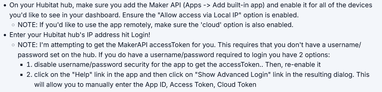

Hello - Pretty new to Hubitat and am trying to make use of your app but am also getting blocked at the first step of just trying to detect the hubitat with an ā€œInvalid Access Tokenā€ error.
I have tried installing the Maker API app in multiple ways (I am still not sure exactly what settings I should use for the install). Fully updated the package manager and my Hubitat OS. I have also tried manually entering the settings. My Hubitat may have had another IP Address in the past, but I am not sure how I could check that or whether that is actually an issue. Pretty stuck at this point and any help would be appreciated!
I presume that you are doing all of this…

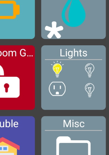

@jpage4500 I’m still very interested in having the folder icons reflect the state of its content items, including color.
Mine do.
That’s the new multi-platform version of this app. I’m referring to the original.
Do you mean like this? (android version)
