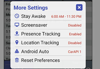

Great app but I'm running into an issue with the presence. It works fine except when I reboot my phone it won't recognize I left the zone. In order to fix it, I have to go back into the app and save the presence setting again. The presence settings are still there but they seem to not be active. I simply go to "Presence Tracking" and save what's already there. Very strange.

Typically, the app will register it's geofence locations when the app starts as well as when the device boots. What device do you have?
You can exclude any device from the battery monitor by long-clicking that device
Thanks for the reply. Even if you open the app after a phone power on it still won't work. For me, I have to save the presence settings (I press the check mark). After that its good until the next restart.
I have a Honor and my wife has a Samsung. Both phone have the same problem.
Does it show as Enabled when you first open the dialog? I'm not sure how to debug this one.. maybe the device logs would help if there's an error in there?
Sometimes its the smallest things. I had the "Disable Feature" ON. How stupid of me, I didn't see it.
no worries.. it's not a good name/label for that setting. I remember wanting a way to keep locations but not enable the feature.. there's probably a much better way to handle that
Thanks for the feedback. Your app is so intuitive, that I have been too lazy to read the documentation. ![]()
My suggestion is to put it at the top of the settings
yeah, that would be better.. probably anything would be better than what's there today. The flag was added late and is to 'disable' it rather than enable it (because I didn't want to break things for existing users). If I get some time I'll try to simplify things
