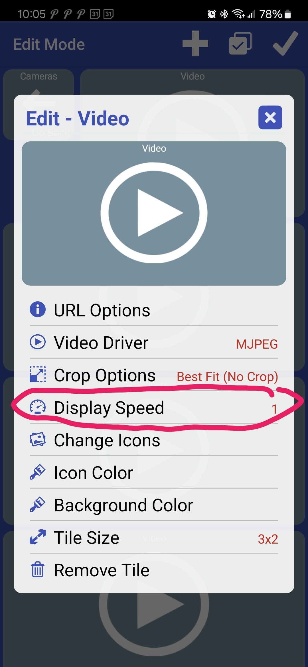

I had to do the same thing to get RTSP feeds to work on my Fire HD pads. It's a camera setting, not an HD+ or pad setting. These are my settings (from my NVR software camera settings) for a Fire HD 10 pad...
As suggested above, I use the Sub Stream for full-time viewing, and use the Main Stream when I touch the image and want a full-screen view.
It's specific to MJPEG video streams.. the library I'm using has an option to skip frames. It's something I noticed that benefited slower devices and keeping the video from lagging behind
