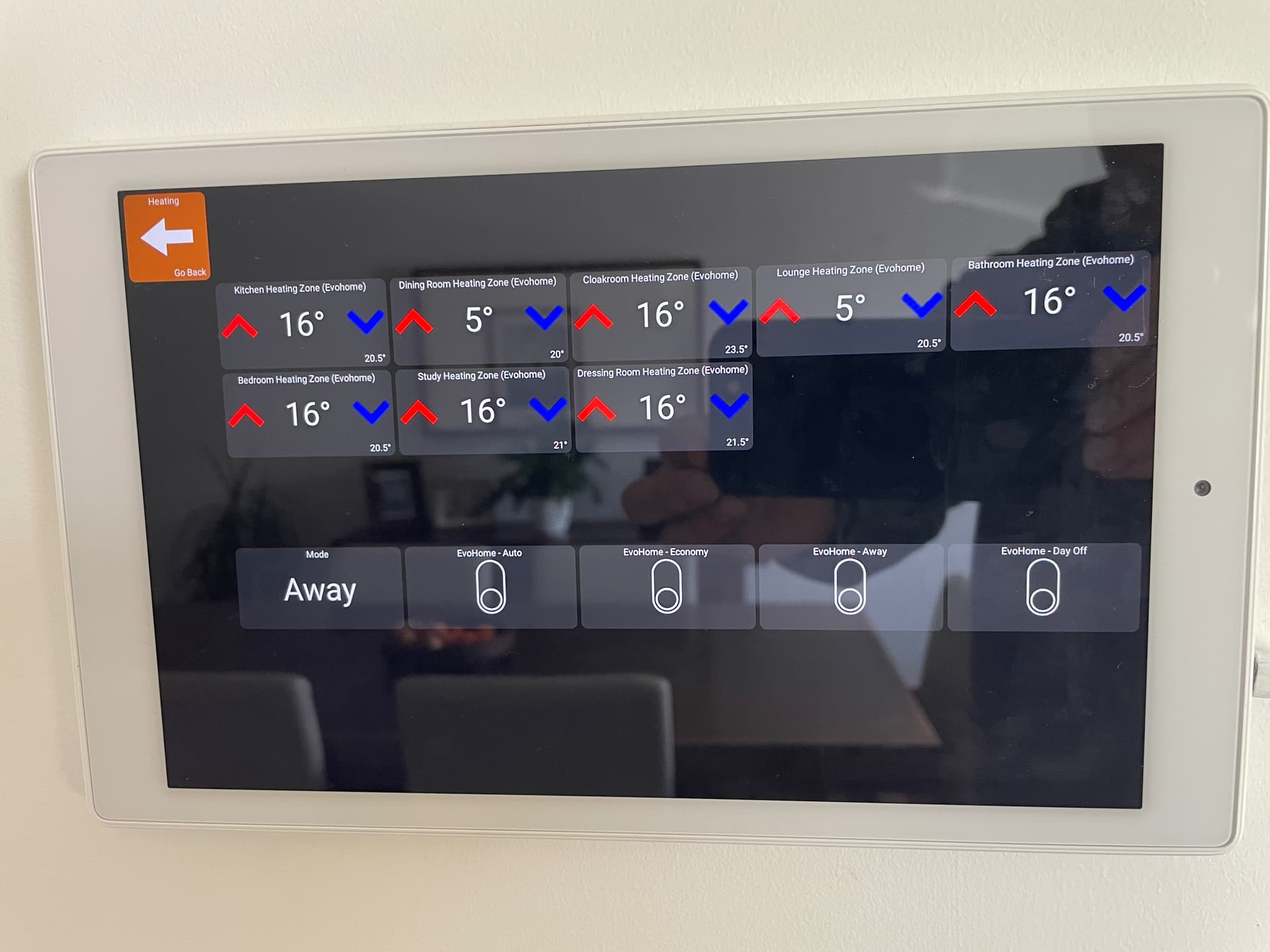

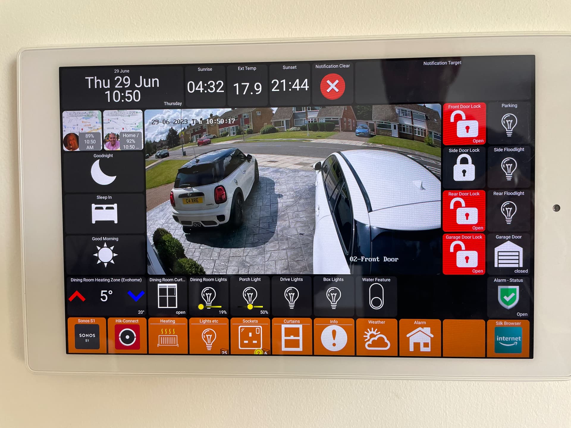

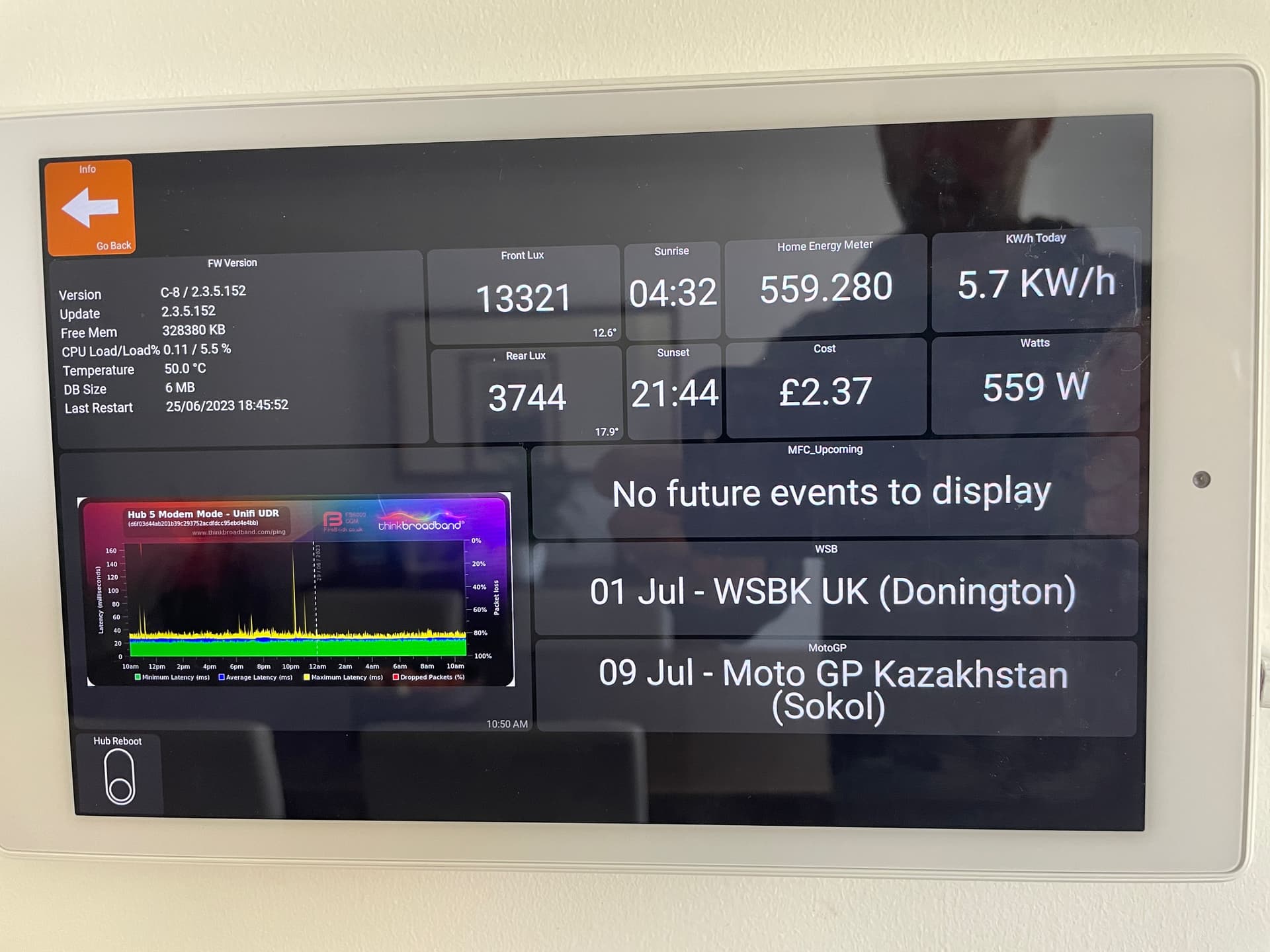

The way I've done mine:
  • Create a seperate instance of maker api with only what I want for any dashboard that I have, initially everything is on one page
  • Create folders - 'Lights', 'Sockets', 'Curtains' etc. I've done them by device type but these could be by room or whatever you want. These become separate dashboards/pages
  • Organise - In edit mode, drag and drop each item into it's respective folder
  • Open the folder - put it in edit mode and add a 'Back' button so you can return to your main dashboard
  • Duplicate - My dashboards are primarily the same on each tablet in different rooms of the house. But what I've done is to go into the respective folders and copy specific tiles, then put them back on the main page. For instance in my Lounge, there is a line of icons for items that are specifically in that room - Lamp, Lights, Thermostat, Curtain etc. That line of icons differs to match the room it's in.
  • I've a different colour for the bottom row of folder icons. Also in that row are shortcuts to launch apps - Sonos, Hik-Connect and resources - Web browser, BBC weather for my location etc
Awful photos but you get the gist....

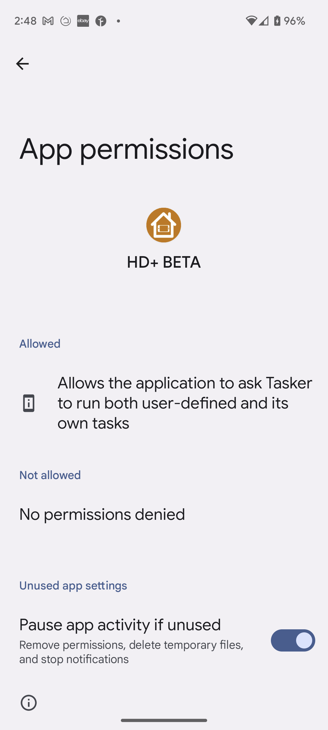

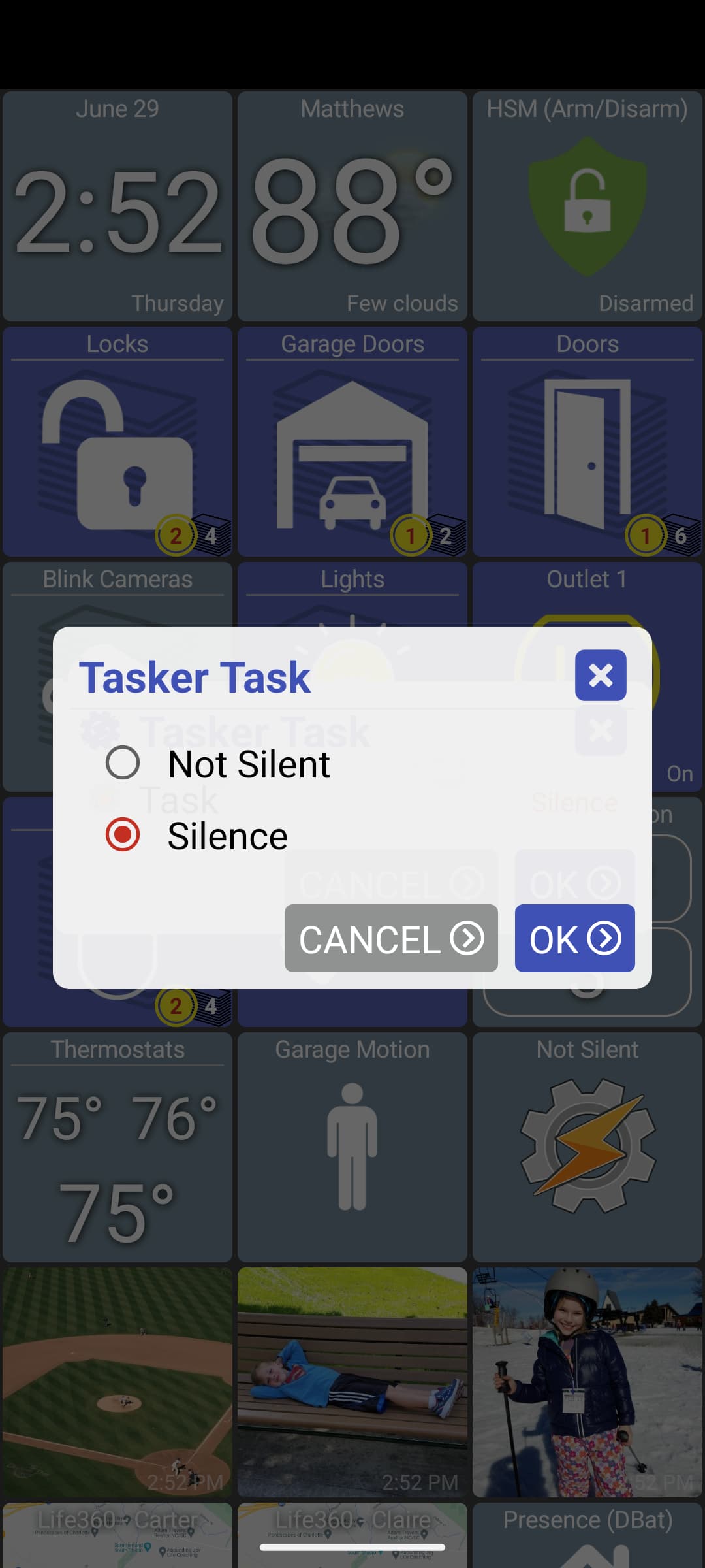

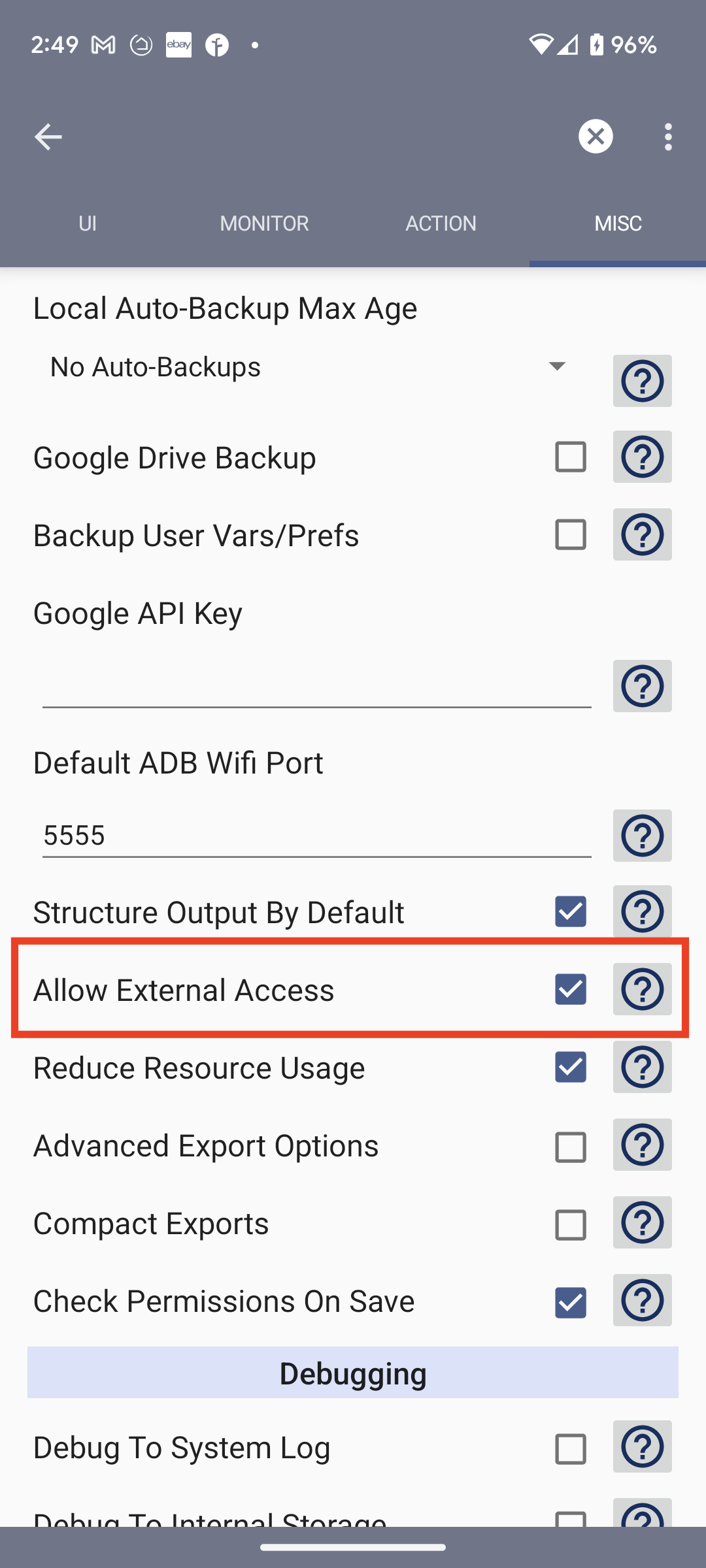

  • add Tasker tile to select and run tasks in Tasker app
I had never used Tasker before so this is probably a pretty simple implementation. You can add a Tasker tile -> select the task you want to run and then when you click on the tile it'll run that task.
One thing to note is - you have to grant permission in Tasker to allow other apps to launch tasks. This required a few steps including accepting a new permission in HD+; Anyway, let me know if any issues or additional feature ideas..
