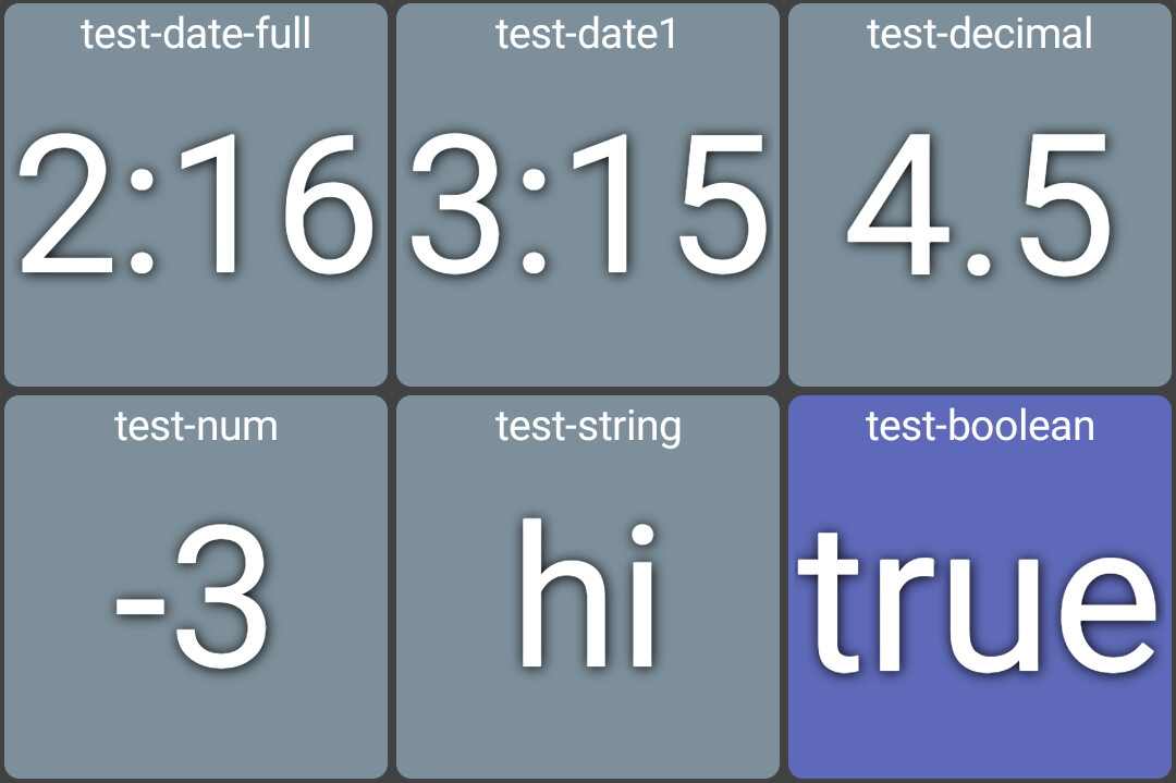

version 1.0.1387 (beta)
- add "variable boolean" device type
This goes with the post above and adds support for Hubitat 'Boolean' variables
- If you click on it, it'll toggle the state (true/false)
