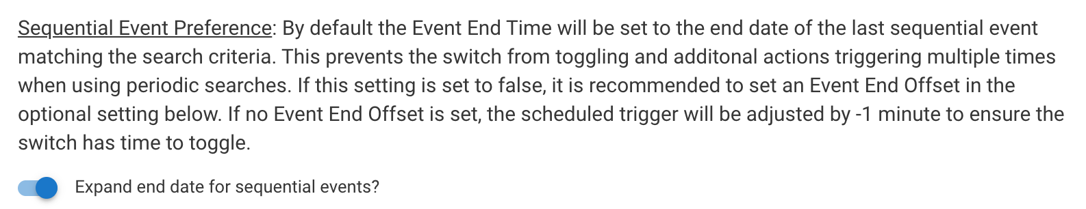

I see. So what about this option:
If the toggle is off for "expand end date," what exactly is the difference? It seems to suggest that the switch can keep toggling for multiple events.
This enhancement came up where a community user wanted to alert his family he was on conference calls and to not disturb him. There was a light outside the office that he turns on based in the calendar events. When he had back to back meetings he wanted it to remain on through the end of the last meeting. So in this case the switch turns on at the start of the first meeting found but instead of the off at say the end of a 30 minute meeting, it checks for back to back meetings and sets the off time to the end of the last meeting.
So this only applies to events that immediately follow the prior even in time?
Example:
Event 1: Monday 10am-11am
Event 2: Monday 11:30-12pm
Is this toggle irrelevant for such a sequence?
Your example has a 30 minute gap between the first and second event so child switch would toggle at 10 and then at 11
If the events were the following and that preference enabled:
Event 2: Monday 11am-12pm
Child switch would toggle at 10 and again at 12
Edit: the only idea I have for you is to enable the Next Event setting and that will capture whatever details of the next event into the child switch’s nextEvent attribute. Once populated maybe you can parse it with custom code or a rule. Unfortunately not something I can help you with here. Please note this only captures details of the single next event, not all matching events found.
