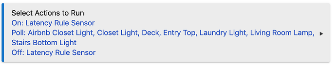

For example:
or
Measure how long an RM4 rule takes:
Or measure how long it takes to for a Zigbee lamp to reply:
