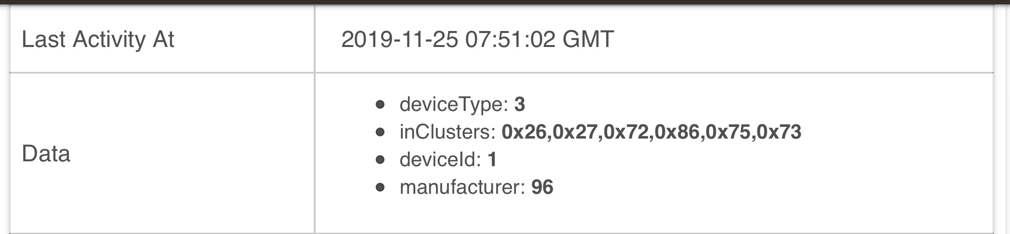

This is what you would see in the data section of non secure.

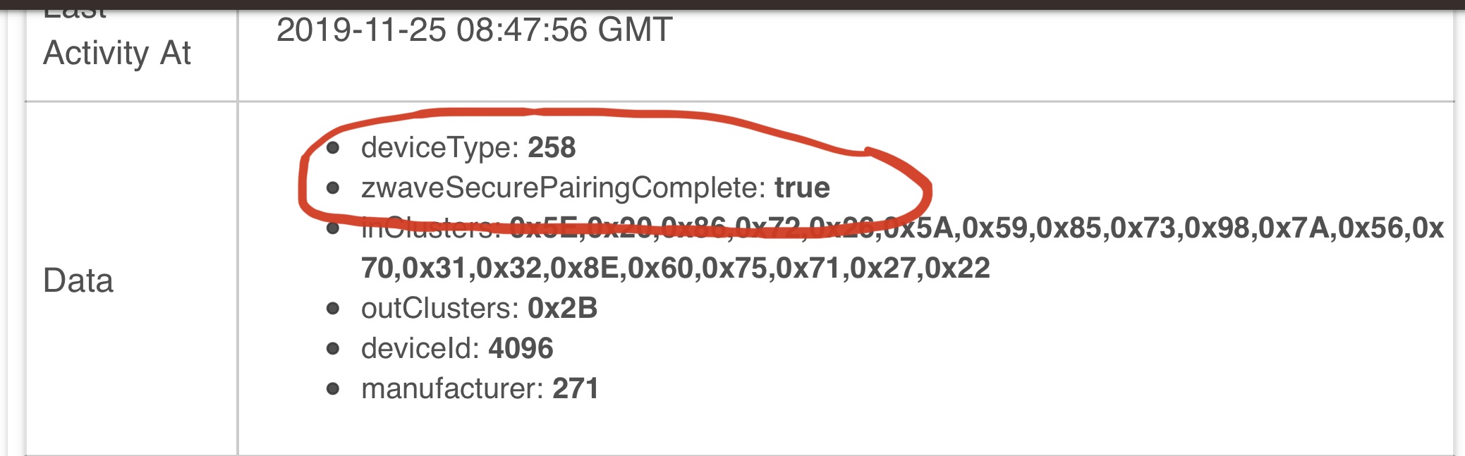

Whereas this is what you would see if secure.
Hope this helps everyone!
And on a side note... to pair in secure mode make sure you have z-wave pairing mode set to all secure.
