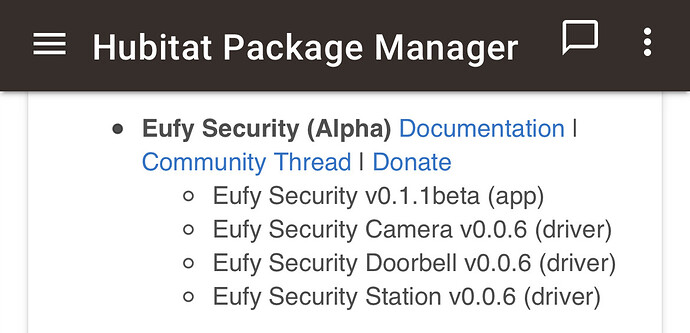

That's the right version. Seems that the floodlight is marked as optional, did you choose to install the optional floodlight?
There’s a chance I’m missing something, but I swear I’m doing this right. I updated, repaired, and even totally uninstalled and reinstalled. Not seeing an option for the floodlight.
Hmm, not sure why HPM isn't showing the package in the modify section (that happens for me too), but mine did install the floodlight camera driver. I'd probably just try installing the floodlight camera driver manually from https://raw.githubusercontent.com/amosyuen/hubitat/main/eufysecurity/beta/Eufy%20Security%20Floodlight%20Camera.groovy and maybe see if HPM can match it up.
Thanks! Manually installed the driver no issue, but then the app itself was giving me fits after the earlier uninstall/reinstall. Uninstalled and reinstalled again just to be safe. Same errors...

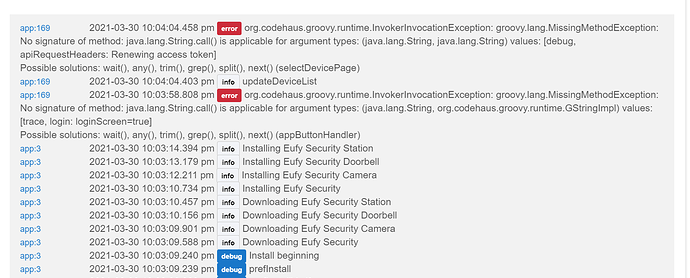

Im in australia and have not been able to get this working, when i try and login i get this error in the log.
app:7432021-03-31 03:41:38.258 pm errororg.codehaus.groovy.runtime.InvokerInvocationException: groovy.lang.MissingMethodException: No signature of method: java.lang.String.call() is applicable for argument types: (java.lang.String, org.codehaus.groovy.runtime.GStringImpl) values: [trace, login: loginScreen=true] Possible solutions: wait(), any(), trim(), grep(), split(), next() (appButtonHandler)
Ah sorry, looks like there was a bug in some logging code. Fixed in v0.0.7. Also I fixed the manifest so that the floodlight shows up as optional.

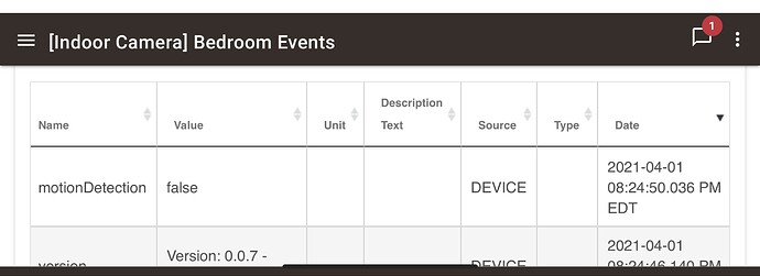

Any advice when it comes to Indoor Cam 2k and motion detection? I was trying to see if I could turn off motion detection in the HE app, I see where it recognized it in “events”, I think I see where it’s recognized in the logs, but the camera then triggered motion...
I don't have any indoor cameras so haven't been able to test it. But they might use a different param for motion detection. The logs screenshot is from you making the change in hubitat right? Could you make the change in eufy app and see what logParamDeltas records after a refresh?
Unfortunately nothing when it comes to motion detection...
