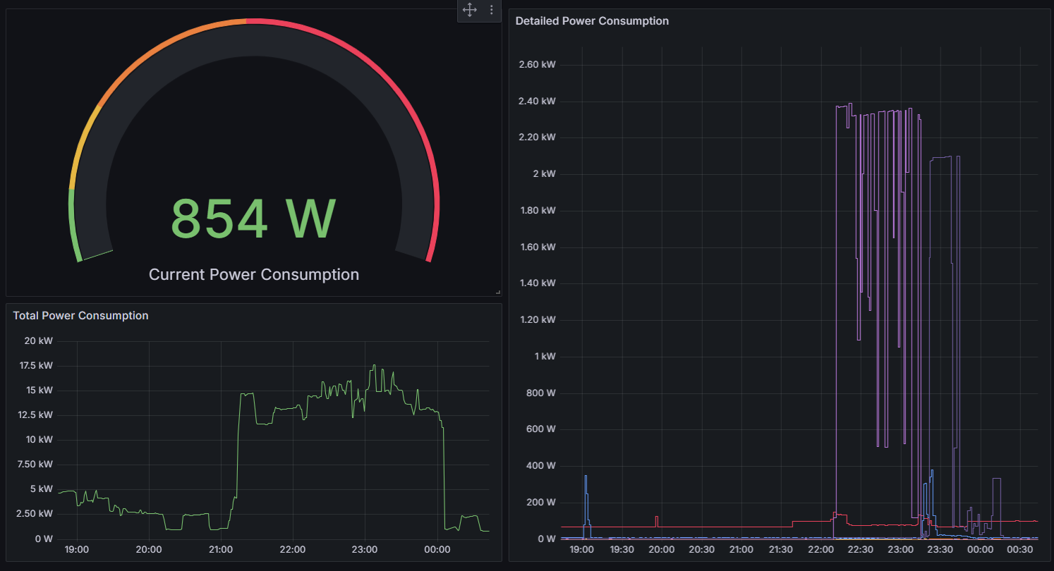

I am testing the use of InfluxDB and Grafana to bring the data as graphs to my dashboard.
This is how my tests results look like for now.
I am using the great comunity InfluxDB Logger app

This is my Grafana dashboard for now:

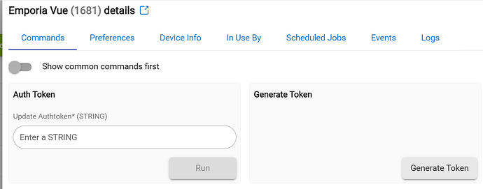

Where do we find the auth token for the utility driver? I've got the accessToken, idToken, etc. Is it one of those?
If i recall correctly the app uses the idTokan as the authToken. But... where did you have to use it manually?
The app shows a token, but the device page does not, and I don't see the child devices. I figured that was the problem.

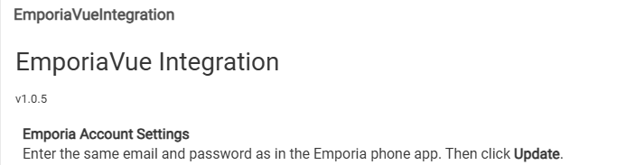

  1. What app version are you using?
    App verion can be seen at the app page
  2. What is the device driver you see for the parent device created by the app? The app should create a parent device using the EmporiaVueParentDriver
  3. Please attach the app logs
EmporiaVue Integration
v1.0.5
I created the device first, because I was installing a different app. Should I remove it and reinstall? I get this for the logs.
