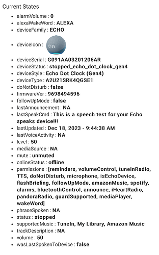

One of the devices in question:

Same result. I get all the logs from ES to indicate that a notification has been sent, but nothing. The Echo works, if I ask the time so that is all working. for whatever reason it just does not work.
