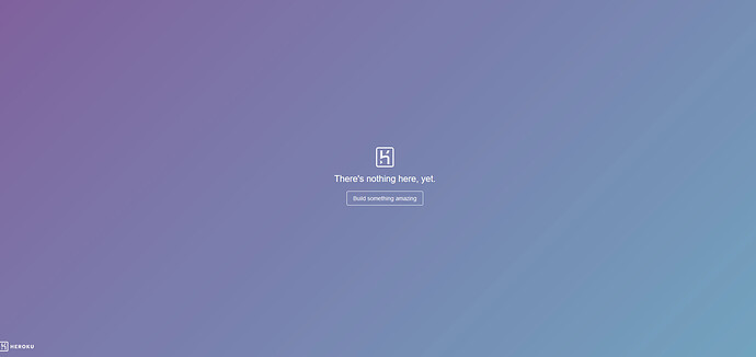

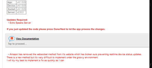

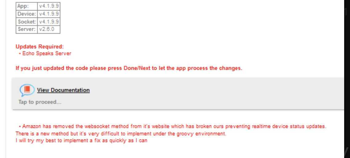

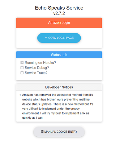

So went to go set up Echo Speaks and got to the server setup. At this point during login I get to the page that said that amazon removed the websocket method and no longer works with it through groovy. Am I missing something or do I just have to wait until a solution is found?
I get this
and when I click goto login
You guys are always so much help for me, I wish I could help more. Had this many months ago (before Amazon broke the link), before this latest update and it worked. I removed it back then and was sad. I recently reinstalled this version and it works perfectly. I still show the error message "..broken link...", but it all works beautifully.
I can only encourage it can work. Someone more knowledgable will have to help get you there. If I stumble on to the "magic" step I will let you know. sorry I'm not more helpful.
Just wanted to follow up to say I now have it working. I just removed the app and then ran through all the (very clearly detailed) installation steps again.

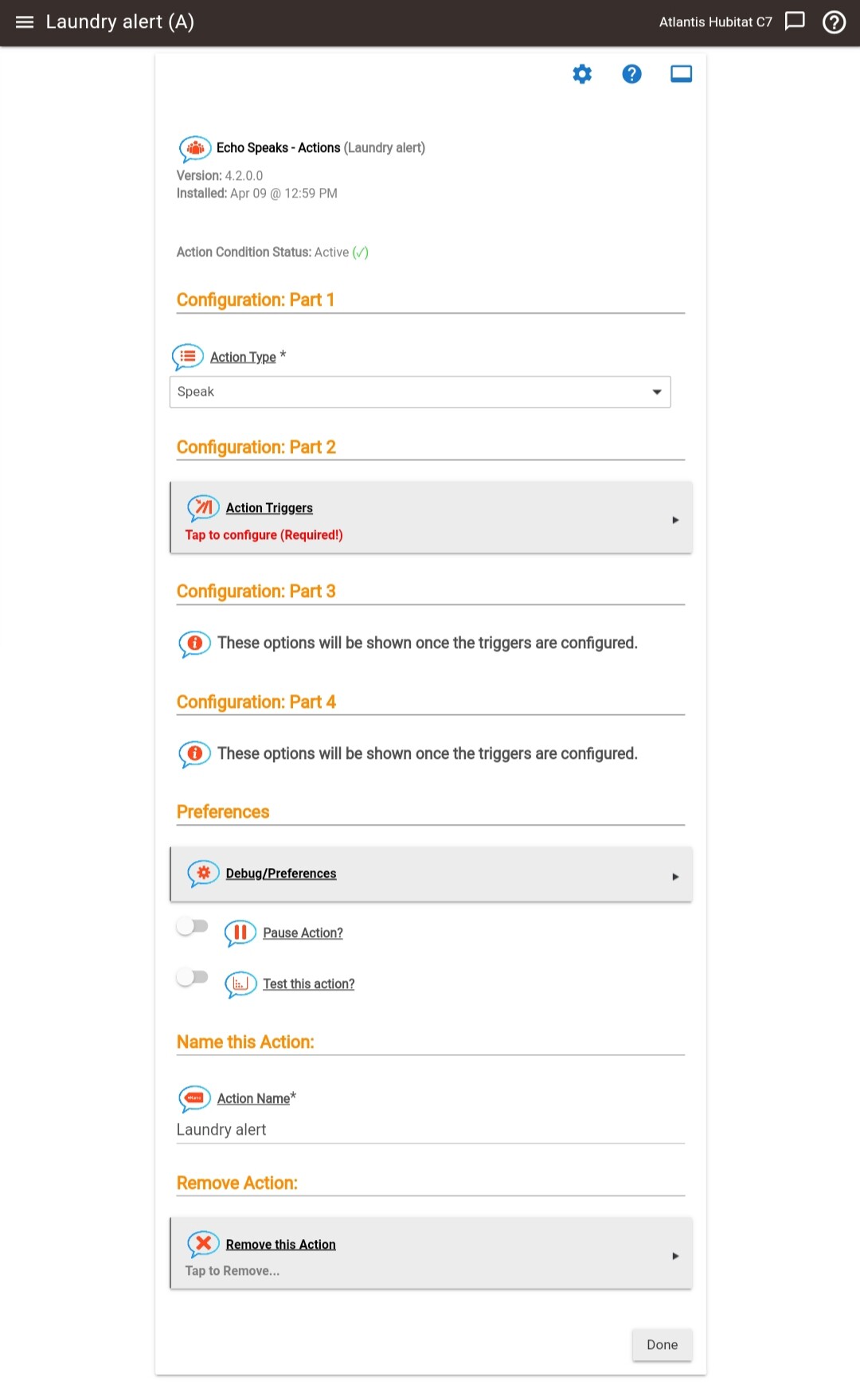

Just installed this - amazing app already, so tyvm op - but I'm having some trouble setting up a particular trigger. I'm probably missing something very obvious.
I want to trigger on my Samsung Washer/Dryer completing a cycle or other triggers. They're currently all set up through Smartthings and working fine pushing notifications to my phones/TVs.
When I look under Actions for a trigger, I don't see any way to trigger Speak from the notifications. I'm guessing I need to do something further to make the washer/dryer visible in HE?
Under actions pick send, speak, or log a message, send http request
pick action (send/speak)
put in message
pick notification device

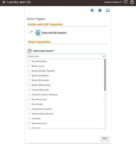

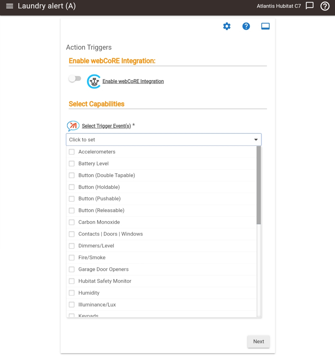

I select Speak, name the Action, that brings me to this page. Selecting Triggers pulls up a list of devices, but does not include the washer/dryer.
So what device are you using on HE for the washer/dryer?
What attribute does it flag for different statuses?
Ah that must be my issue. I'm still pretty new so I just assumed it could detect devices added in Smartthings. It worked with some of my other devices that way.
The washer and dryer are currently only added/notifying through the Smartthings app, not Hubitat. Any idea what I'd need to do to make them visible in hubitat? I also have a Smartthings hub, but I don't use it since I picked up the HE. I had thought Echo Speaks could see both HE and Smartthings devices.

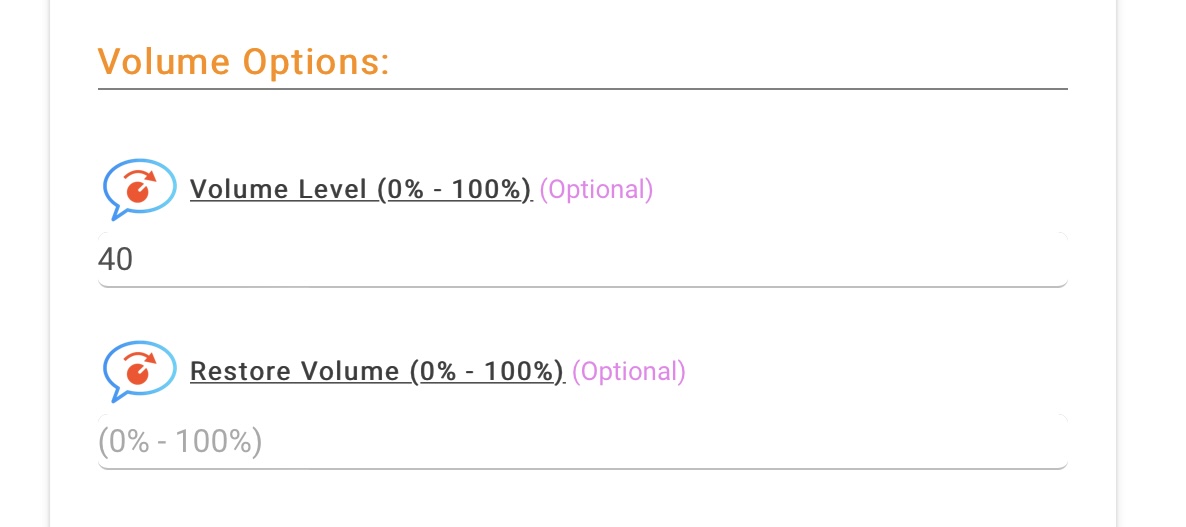

A simple newbie question however. In setting the volume of the devices (see below):
what is the functional difference and resulting expected behavior with the Volume Level and the Restore Volume levels?
My use case is that I would like security announcements to be made at a high Volume Level, but would like my Alexa devices to return to their “normal” quieter volume level settings after the security announcements are made.
The reason I ask is that I assumed that the Volume Level setting was the volume that my announcement would be announced at, and the Restore Volume setting would then reset or restore the volume setting of my device to the lower volume setting after the announcement was made.
However, when I set the Volume Level to 50 or louder so the announcement would not go unnoticed, ES would indeed make my announcement at “50”. But, when I would also set the Restore Volume Level to say 20, subsequent “normal” Alexa responses would stay at 50 and not restore to the lower volume level.
Also, if the Restore Level is left blank, does the volume of my devices stay at the Volume Level set in ES, or does it automatically return to the volume as set in the Alexa app? Thank you for any clarification as I cannot seem to get this to work the way I wish. I figure that I am missing something simple (as usual, lol).

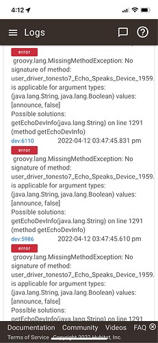

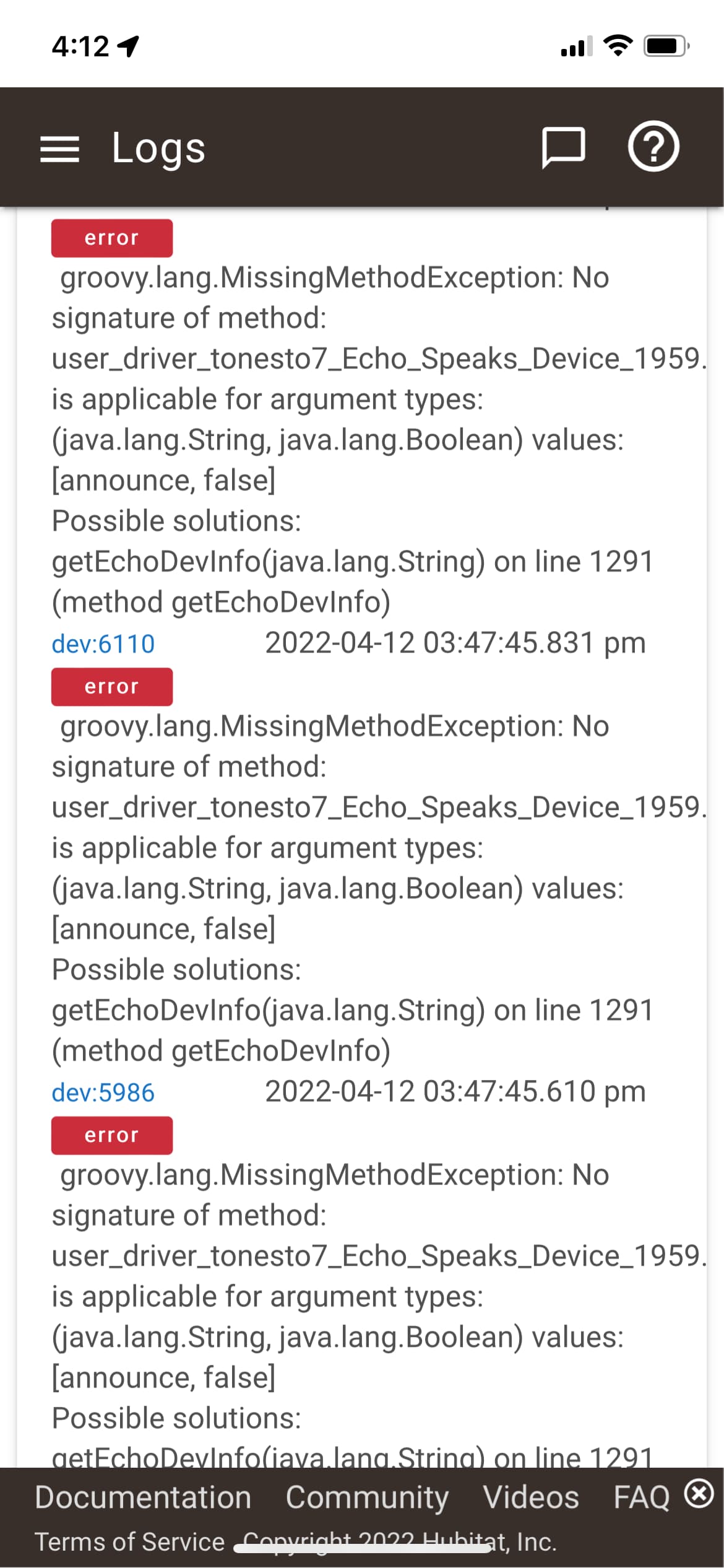

My Echo zones no longer work since the update and I’m seeing this error:
Only text and notifications speak, but are really delayed.
What update? I don’t see any ES updates.
It’s been a couple weeks, when the socket device was removed from it.
Reaching out to @tonesto7 and @nh.schottfam (or any others in the know). Any instructions on how the Volume Level and Restore Volume is supposed to work (per my question posed in my previous post). It seems that when I set the Volume Level to 10 (for a verbal alarm warning), and the Restore Level to 35 (my normal volume on my Echo devices), ES only plays the initial tone at 10 (not the announcement), then immediately lowers the volume to 35. When I look up my device volume in the Alexa app, it shows that the volume is indeed set to 35%. I am obviously not understanding how this is supposed to work. Thank you for any help/instructions in advance.
I see the bug and sent a pull request to Tony
the workaround is
  • set level(loud)
  • do the command but do not fill in optional volume/restore
  • send a noOp() command to device
  • set level(restore)
I would check that your devices updated - HPM repair or manually update the zone device and echo speaks device code
