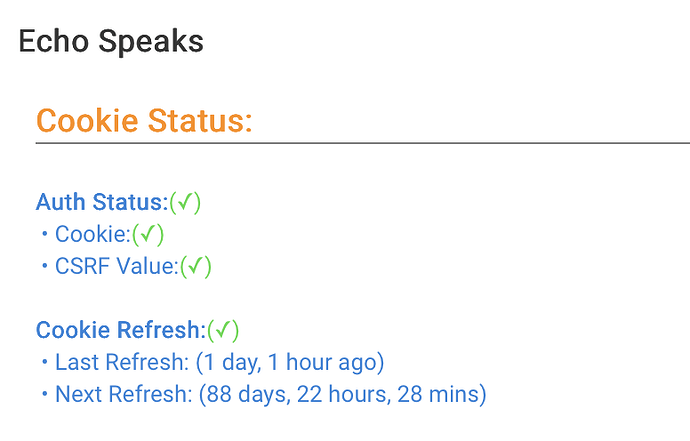

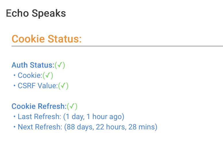

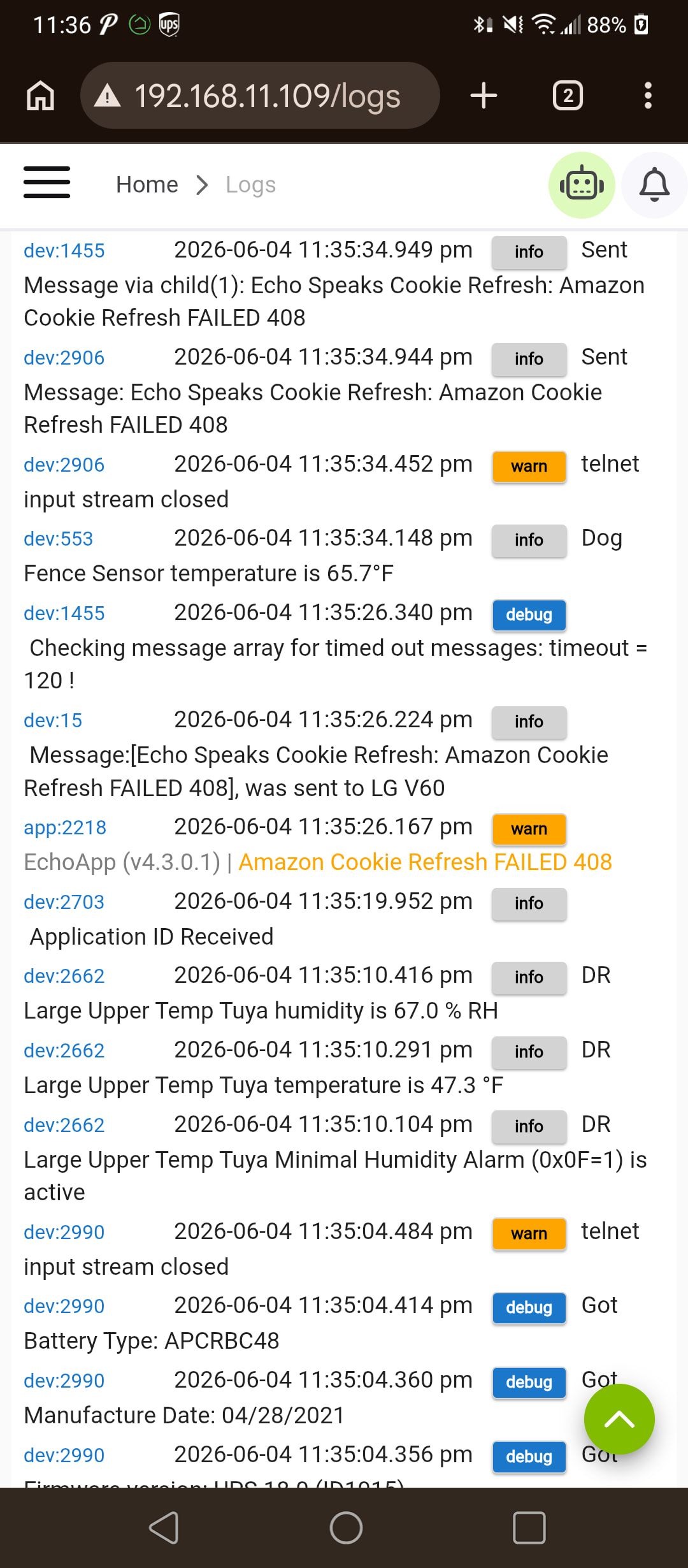

Mine definitely has to be re-authorized very 6 days exactly. I went in and deleted about 30 old “echo speaks #22 etc.” device on the amazon page. So @kahn-hubitat what did you do exactly that has you going on 29 days without reauthorizing? Mine started on 6/16 and has needed to be reauthorized every 6 days since.

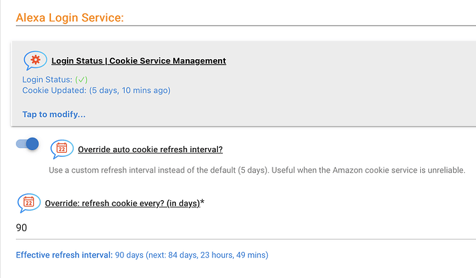

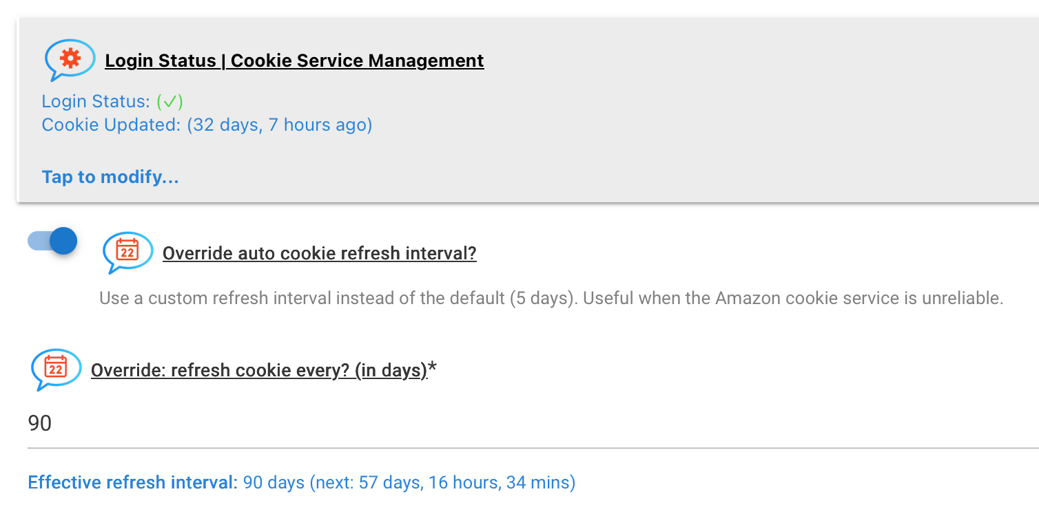

Look further up above. You need to either edit the Echo Speaks app code to allow you to enter a longer cookie refresh interval, use the override version here, use the ES Server version here or you can use this to refresh the cookie whenever you need to.

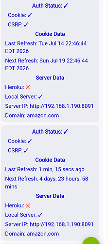

Whisper will refresh on its own when the cookie gets old. Right now that is hardcoded at 10 days.
If you configure it as the Echo Speaks server, it also listens for the refresh request from Echo Speaks and will refresh/send the updated cookie back based on your Echo Speaks refresh schedule. I think the ES default is 5 days. I have mine set in ES to 2 days just to make sure everything is working, and it has been solid for a couple of weeks.

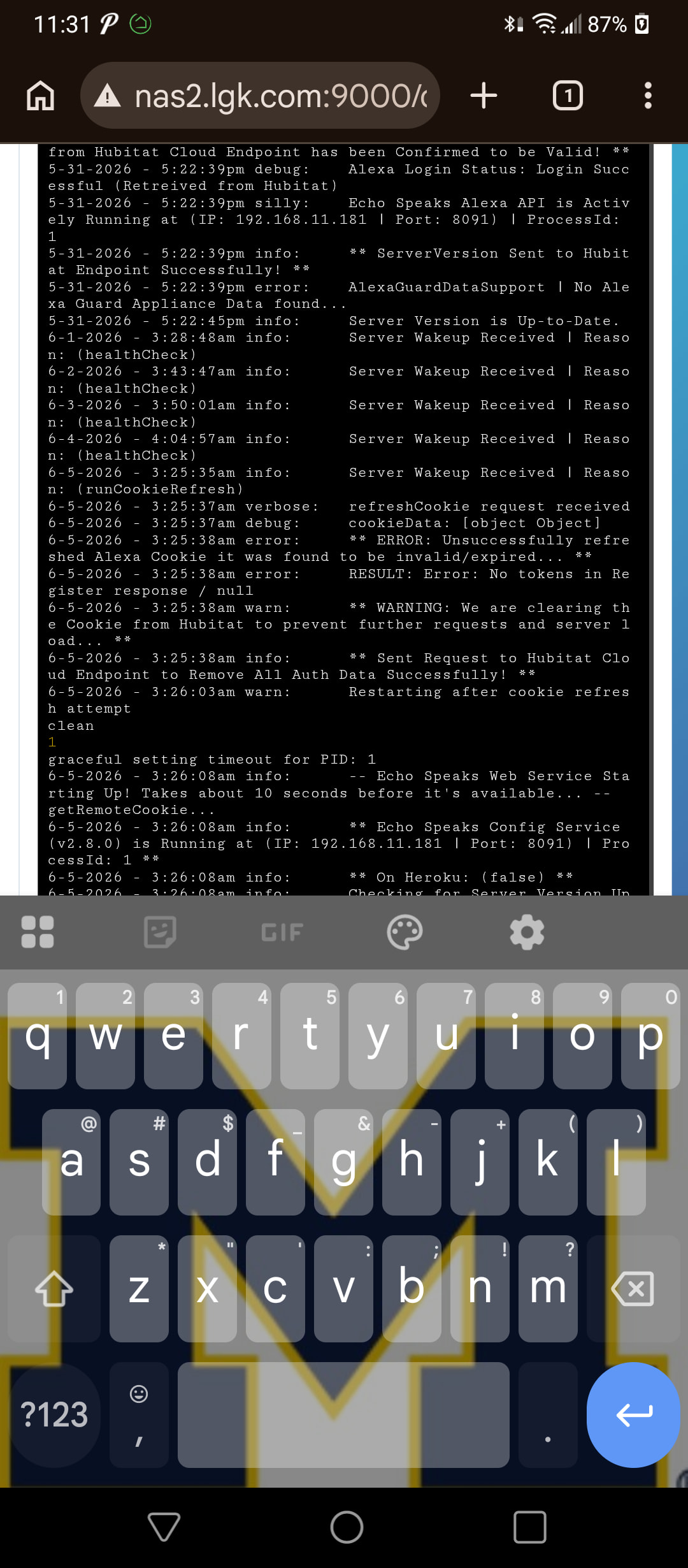

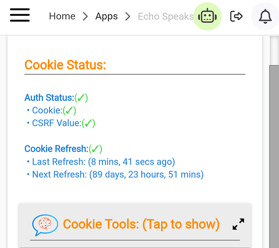

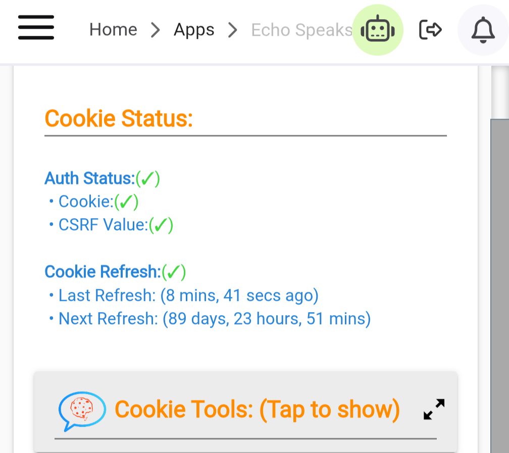

I've updated the server image for the Docker container and the ES code under applications. However, ES cookie checking still only shows 5 days until the next renewal. Am I assuming this is not working correctly?
Maybe I didn't import the docker image correctly, but I'm pointing it to the location that's listed above so I'm not sure what I'm doing wrong.

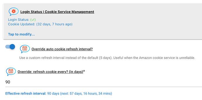

It is showing 89 days and change in your screenshot above:
Don't go by your 1st screenshot, which looks like ES Tile.

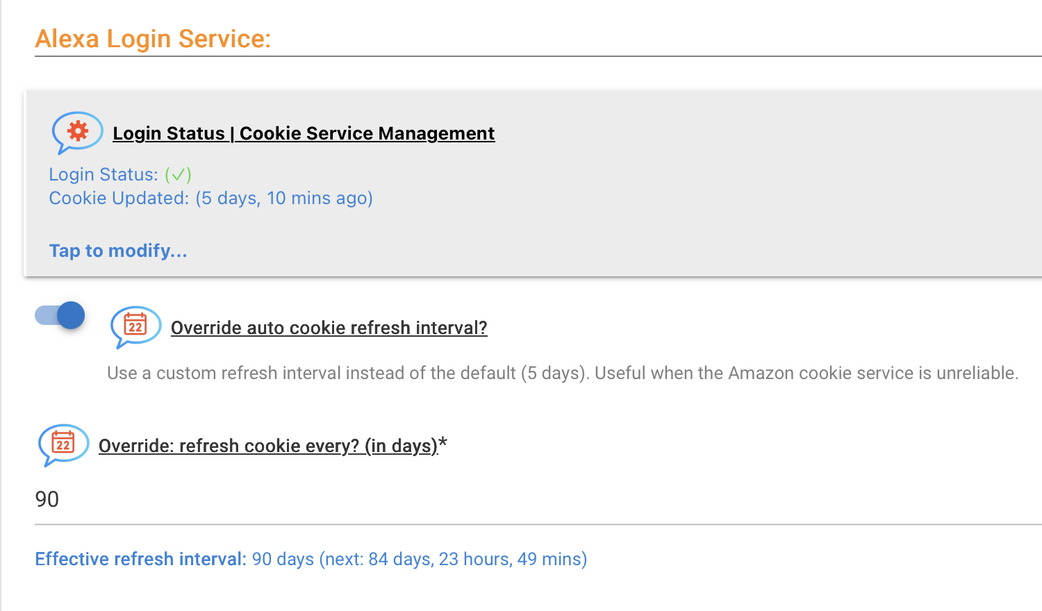

Thanks. I did install the override version. Set it to 90 days. So far so good!
For me, it still bombed out after the time listed above. I cannot seem to get past the five-day.
I guess I’ll find out in 9 hours.
So far, so good.
