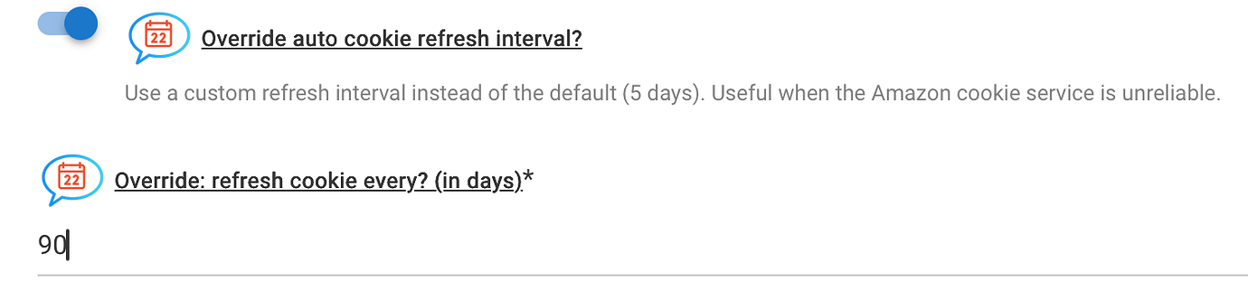

@dJOS I copied this code for the toggleable override into the apps code for ES and it compiled without complaint. But the strangest thing…. Echo Speaks has disappeared from my app list. ??? No sign that it exists or ever existed. The individual echo devices are still there and work fine.
Does this make any sense? Maybe a conflict with Package Manager (which had managed it previously)?

Well I’m fairly technical in general, but with all due deference to the comments here about possible solutions, Echo Speaks has always confused me. A lot. There are many moving parts, and getting and keeping the cookie server - which I run standalone on a Pi - going is complicated. I already downloaded a patched version of the Echo Speaks app that was supposed to only update every 90 days. Still went belly up in a couple of weeks. There are numerous approaches here. And if you (me) don’t really understand how Echo Speaks works, until a solution stabilizes that hopefully can be installed with HPM I’ll still be flailing about. I appreciate the efforts, but some of us are still baffled by the whole thing. Hence my musing about how nice it would be if Amazon would just charge me a fee to allow me to use their devices for voice announcements without kicking me out every couple of weeks.

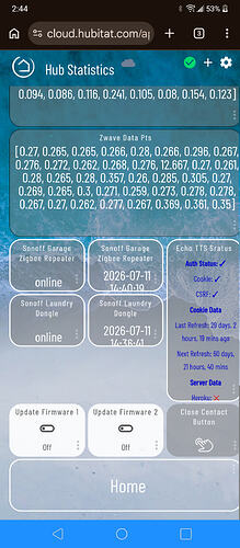

mine is still working going on 29 days
