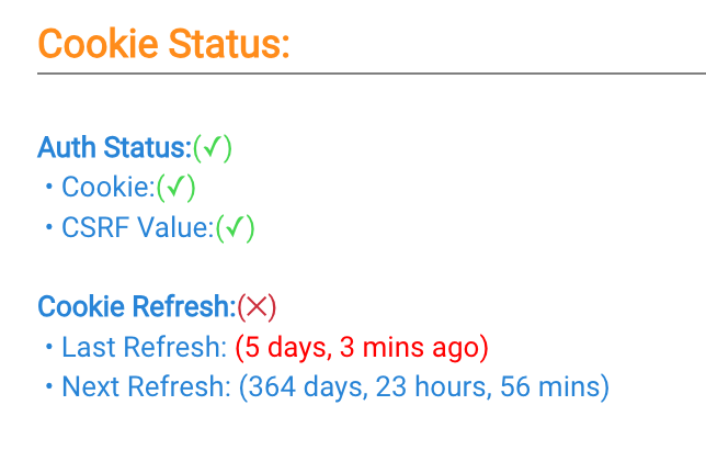

It took 5 complete run throughs. But now appears to be synced again with the correct number of days till next refresh
So, this is the way to fix it once it breaks (remedial or corrective action). What is the "why it broke" (root cause) and the "How to prevent" (preventative action)?

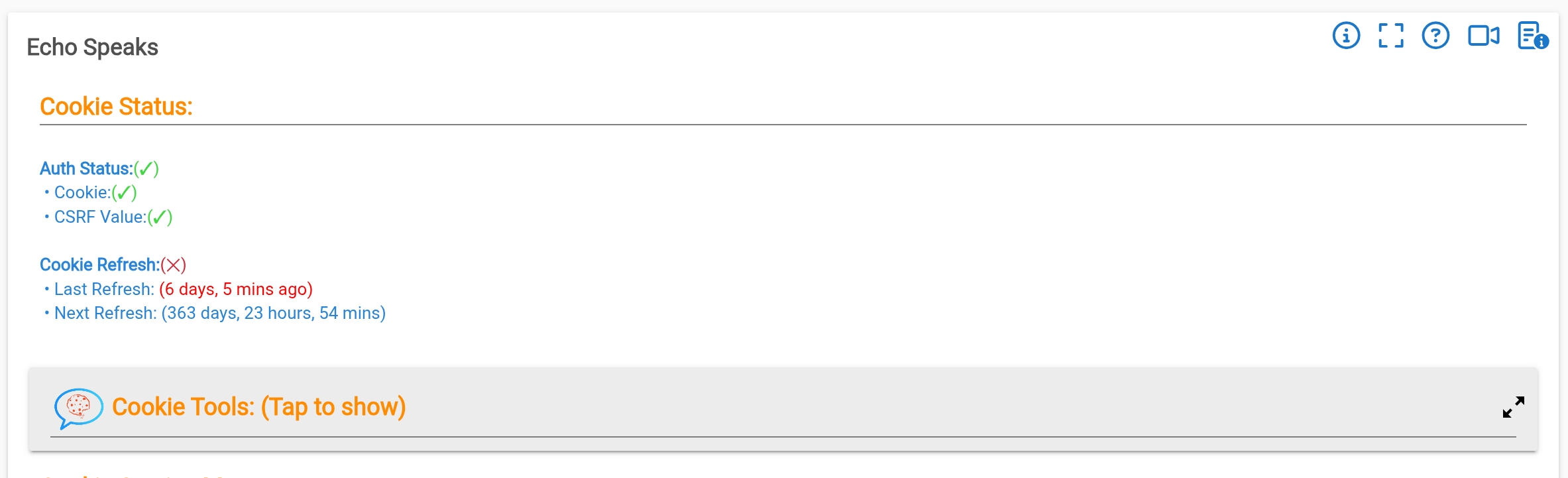

SInce it has been 5 days, and my next scheduled refresh was yesterday, I decided to check in.
Something is definitely not working right here:
Deleting credentials and logging in again fixed it for now. Will check in 5 more days.

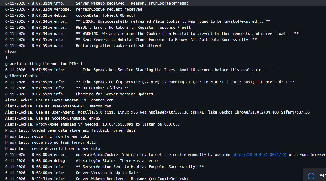

This is what the server was showing. Logged in to amazon again and it is working again.
Thanks for posting that. I’m no expert, but it seems to me there’s been a change on the Amazon side that is not allowing for/accepting the scheduled cookie refresh. So a fresh login seems to be the only way around that for now.

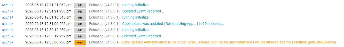

There appears to be something going on over at amazon. The native Amazon Echo skill is throwing bad server errors also
Error making Call to Alexa message gateway: < new weird error in logs??
