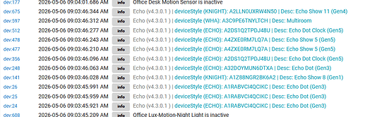

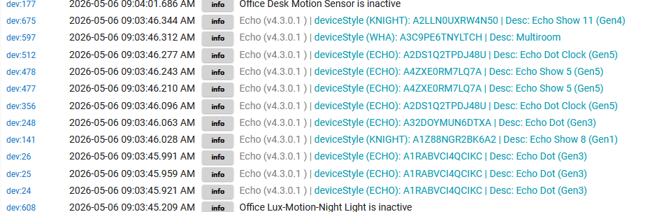

This AM I was scanning some logs and saw an anomaly and began to explore it. I had noted that 2 of my Echo devices were incorrectly identified in HE. Dev 477 and 478 on the left column say I have 2 Echo Show 5's. I don't.

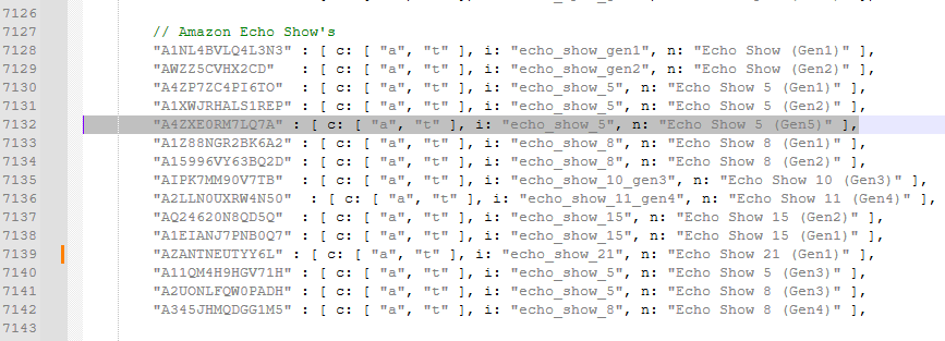

I have maintained my list of Echo devices and their devtype ID's and knew immediately where to look. Indeed, in the App code at about line 7132 the table lists the problem:
There is no table I know of where these can be looked up and verified (there must be!) but I've been adding new things over the years and was comfortable making the change:
I removed this line from the 'Amazon Echo Shows section:
"A4ZXE0RM7LQ7A" : [ c: [ "a", "t" ], i: "echo_show_5", n: "Echo Show 5 (Gen5)" ],
And added this line to the Amazon Echo Dot section:
"A4ZXE0RM7LQ7A" : [ c: [ "a", "t" ], i: "echo_dot_gen5", n: "Echo Dot (Gen5)" ],
saved. and reran the detection on Echo Speaks and the device correctly identifies.

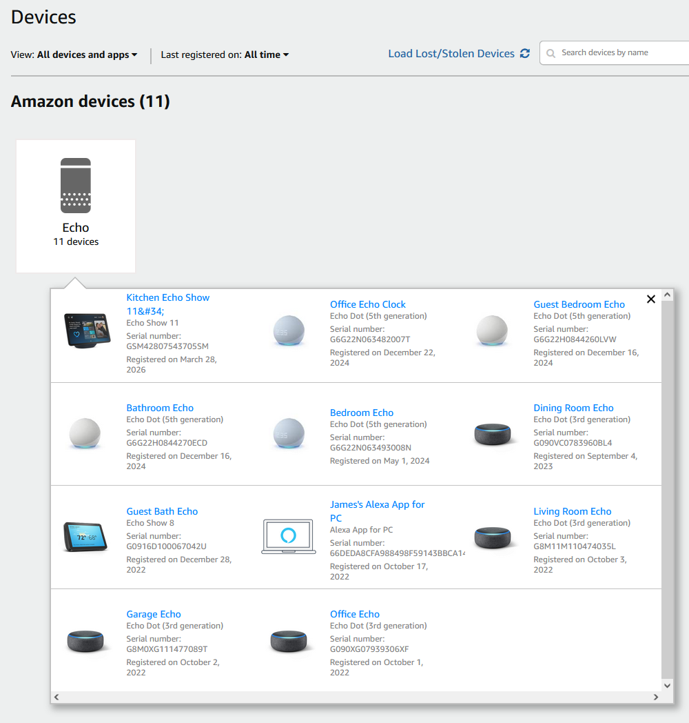

I'd like to add - just trying to find if a device is a gen 4 or Gen 5 is very difficult. It used to be you could hit the 'about' on a device in your alexa app. That no longer seems to work. Nor does the device itself have it embossed, and even asking it 'what are you' gets you stuck in Alexa stupidity responses.
What I did find, is the 'Devices' option on my Amazon page under the Accounts and Lists. It doesn't show the DevType code which would be really nice, but it does detail the identity of your device models including their Generations.

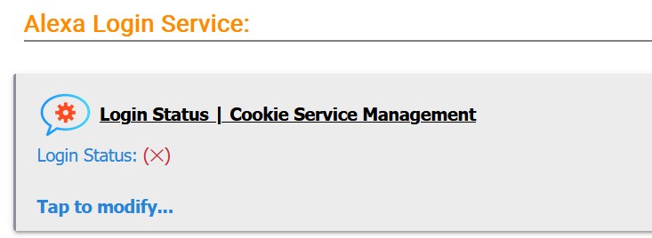

I get:
I go to the login page and log in successfully:
login success
But when I close that window (without hitting "save settings"), I still see "you still need to log in to Amazon."

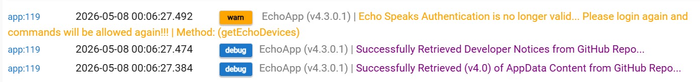

The log shows this:

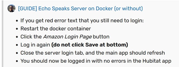

I have followed these instructions:
I have also reset the service data and recreated the server (which is running in Docker).
Again, this used to work. I get the idea from some of the previous reports that, although people saw this error, their Echo Speaks setup still worked, but mine no longer does.
Any suggestions? Thanks!

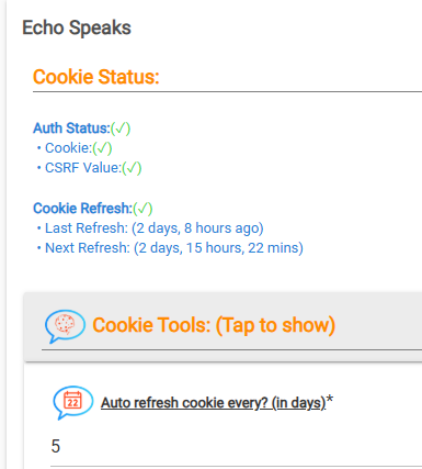

Mine shows online. However, it shows the cookie refresh was 41 days ago, with a red X, and the next scheduled is 328 days. But I have it set to 5 days in the app. :man_shrugging:
Manual Refresh did not fix and neither did logging back in.

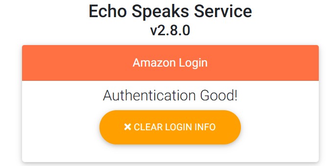

That means you have an issue with the cookie refresh. Echo Speaks often continues to work that way, but it isn’t correct. You should be seeing something like below if everything is working properly:

Try restarting the server again and then logging in using a private/incognito browser window. Login and make sure it shows that the cookie is OK (or whatever it shows, don’t recall off the top of my head). Leave that window open and go back to the app in Hubitat and see what happens.
