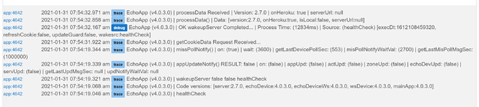

On new update seeing this error on the Websocket
2021-01-29 07:23:37.591 pm errorgroovy.lang.MissingPropertyException: No such property: cookie for class: java.lang.String on line 631 (updated)
I'm seeing that same error message on most current beta branch release!
[dev:557](http://10.0.0.79/logs#pastdev557)2021-01-29 07:25:39.633 pm [error](http://10.0.0.79/device/edit/557)groovy.lang.MissingPropertyException: No such property: cookie for class: java.lang.String on line 631 (updated)
[dev:557](http://10.0.0.79/logs#pastdev557)2021-01-29 07:25:39.483 pm [info](http://10.0.0.79/device/edit/557) Socket (4.0.3.0) | close() called
[dev:557](http://10.0.0.79/logs#pastdev557)2021-01-29 07:25:39.481 pm [info](http://10.0.0.79/device/edit/557) Socket (4.0.3.0) | initialize() called
[dev:557](http://10.0.0.79/logs#pastdev557)2021-01-29 07:25:39.462 pm [info](http://10.0.0.79/device/edit/557) Socket (4.0.3.0) | updated() called
I get the same error
Are you on 4.0.3.0?
I’m a little rusty, but if I read the code (Echo WS device) correctly it’s just casting the value as type String, and everything in that command appears to be of type string so not seeing how you’re getting that error.
Yes I am.

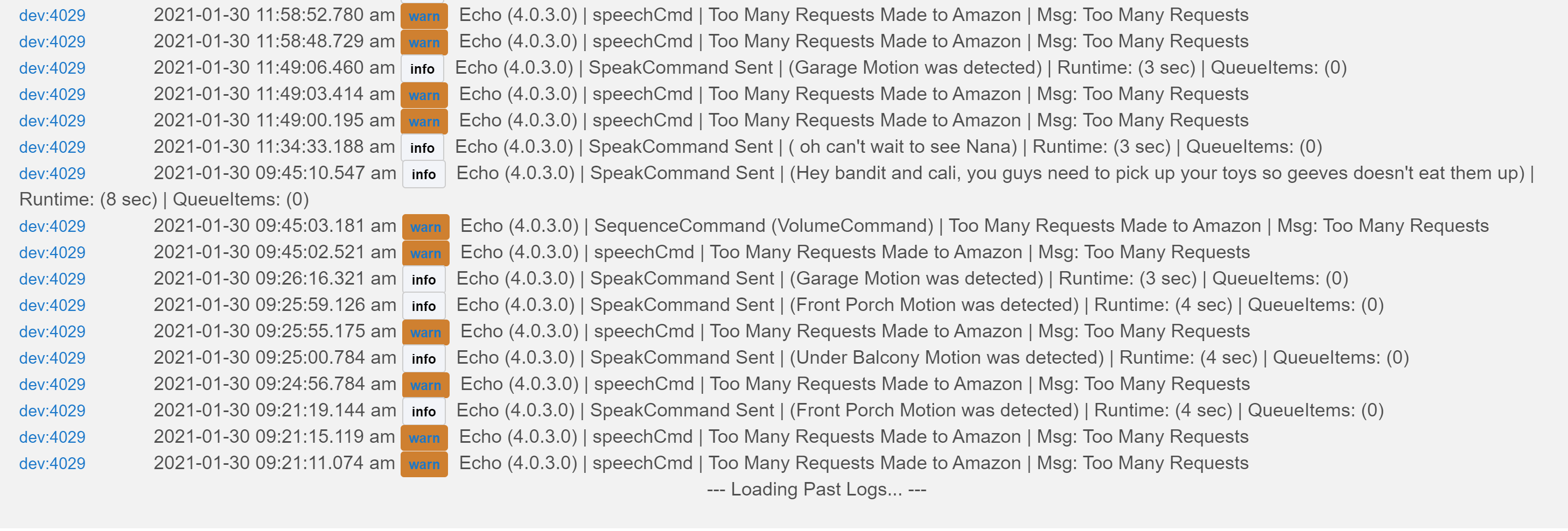

I seem to get lots of too many requests in my logs
Each use in RM has a 2 sec delay between speaking and/or setting volumes...
Is 2 sec just not enough, sure hate to add more delay or is there another solution?
The request limits are per account, not per device, so if you are sending to multiple individual devices at the same time it can cause this.
I ended up at 10 seconds delay between commands to fix this error.
Try creating zones for some of those and it will send one command which will play on all the devices in the zone.

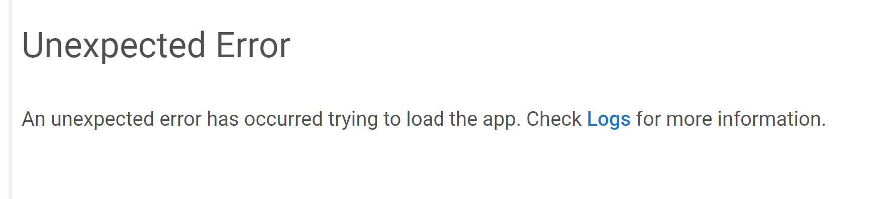

When I attempt to create the first Zone, I get this error and there is nothing in the logs
Thanks for having a look

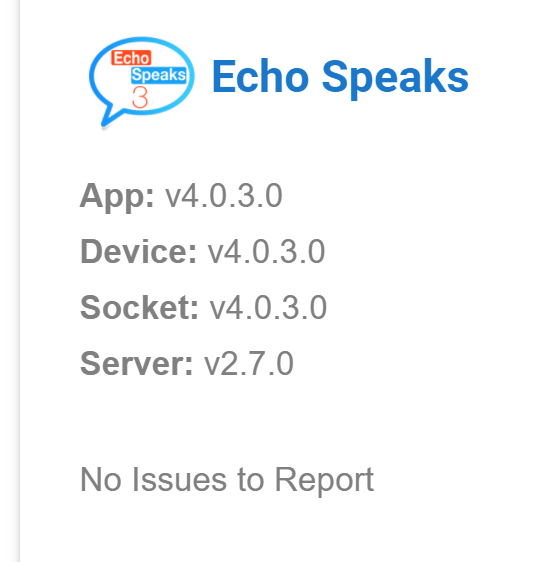

Hi all, I seem to be unable to see all / any of my Alexa's routines. I was able to see & pick them just a few days ago, but not the case any more. I thought I needed to update to v4.0.3.0, which I did, but that didn't solve the issue. Still cannot see any of my Alexa routines.
Any suggestions...?
