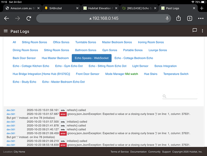

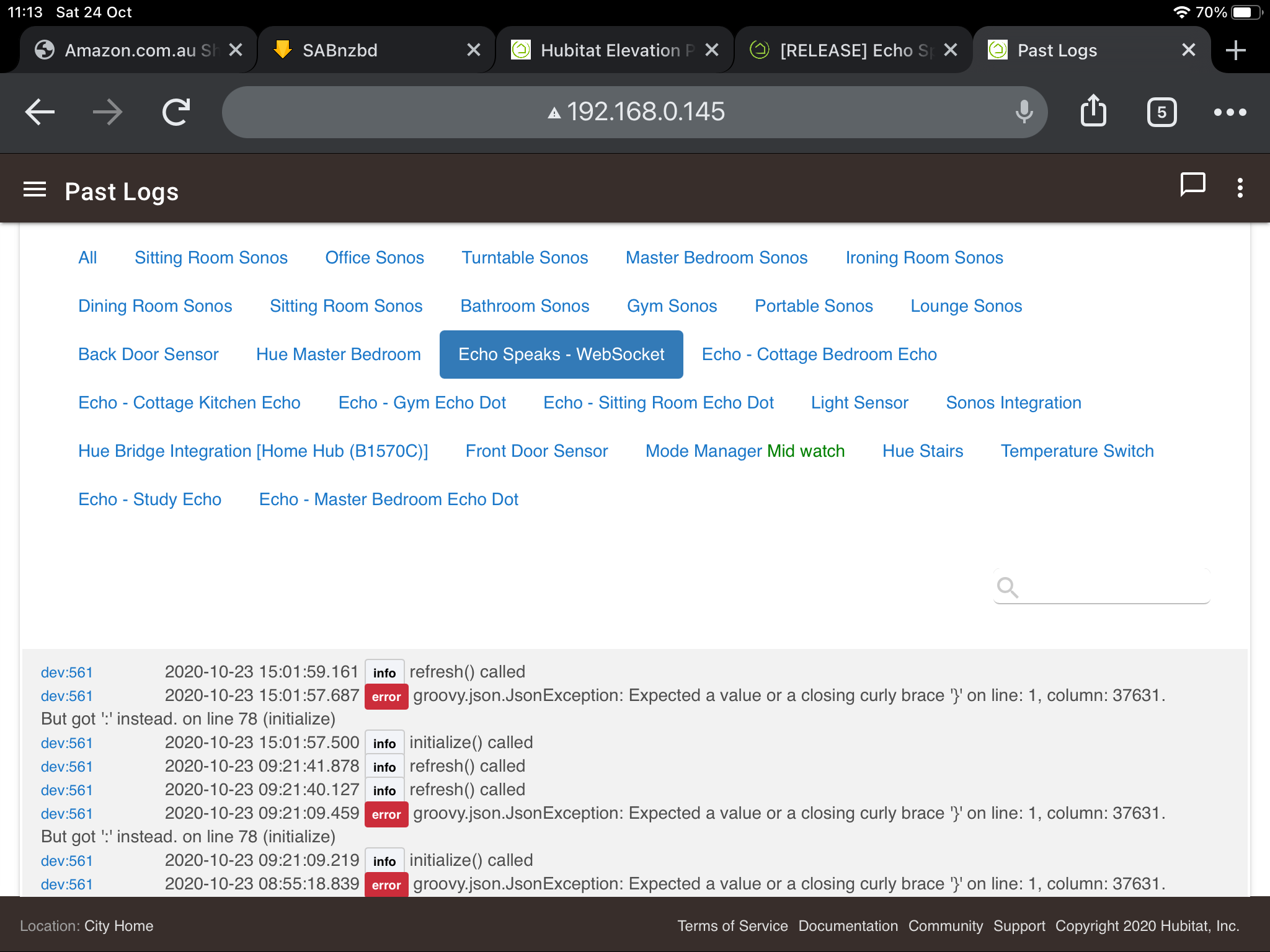

Everything had been working well but yesterday I added a 4th gen dot & renamed a few devices. Now the app won’t open & the log states
errorgroovy.json.JsonException: Expected a value or a closing curly brace '}' on line: 1, column: 37631. But got ':' instead. on line 78 (initialize)
Any clues?

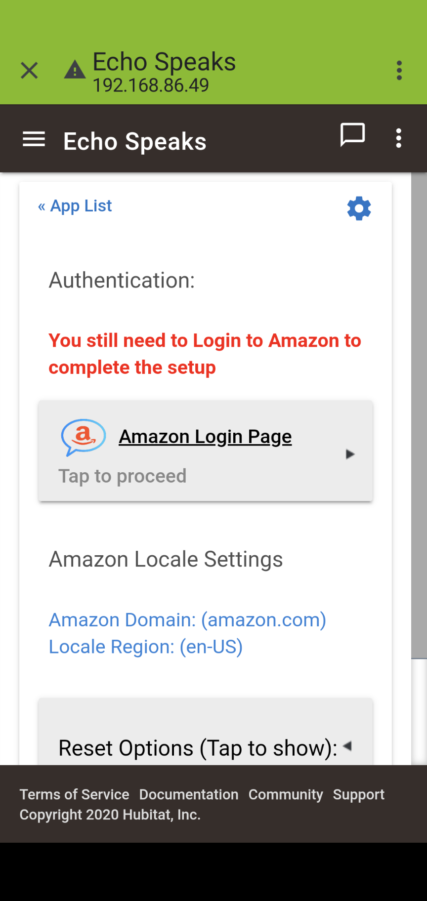

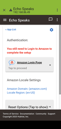

How do I log onto amazon.!
Screenshot_20201024-125635|236x500
Looks like you didn't do this?
https://tonesto7.github.io/echo-speaks-docs/configuration/hubitat/config_server/

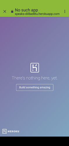

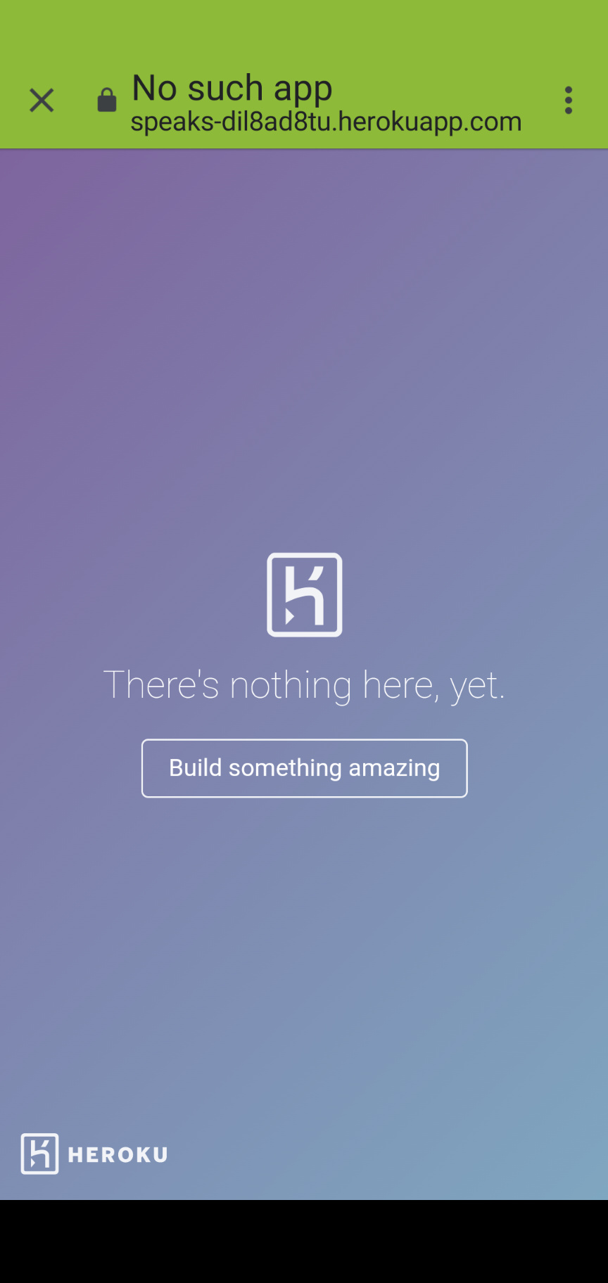

Does it ever actually let me use the name that I copied?
It just keeps saying name not available.
I think I got it now.
You have to paste the name, press the spacebar, and then press the back key. For some reason it doesn't recognize just pasting, it has to have that extra step of clicking forward and back once.
