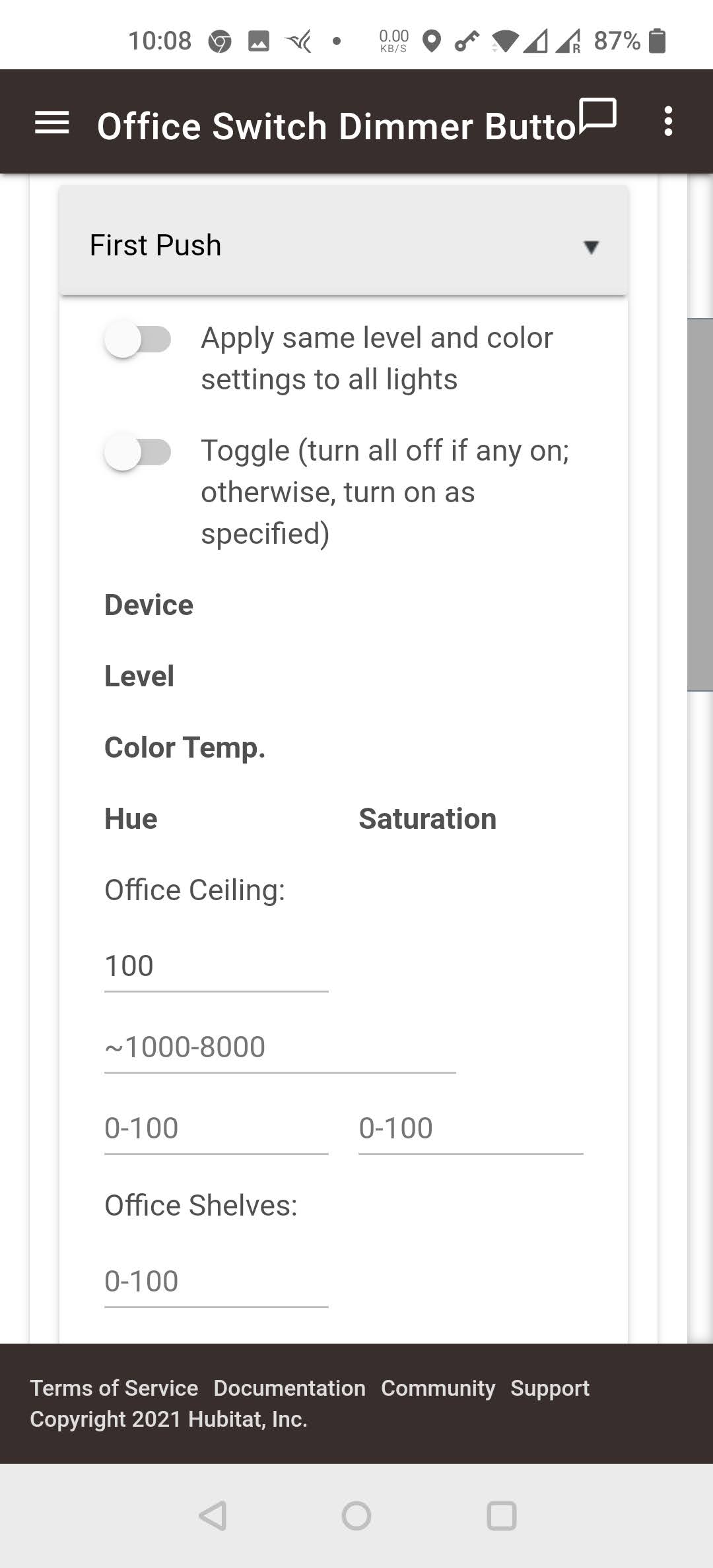

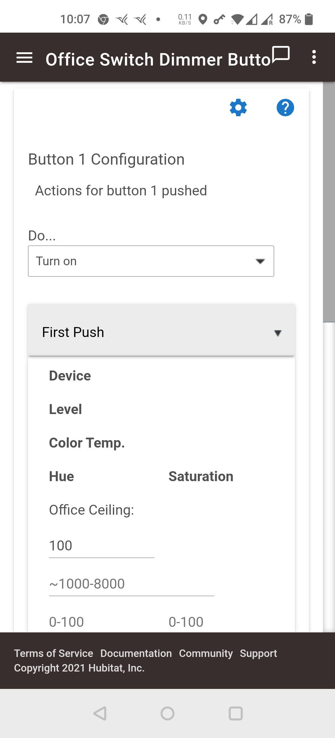

Thanks for this app, much easier to use than other ones, but...
I notice the "Toggle" switch only appears if I pick multiple bulbs. If I pick only one bulb then the Toggle action does not appear:
versus
Parent 2.0.2 according to app code.
Thanks for the report! I see where I misplaced a bracket/if and caused this oddity. I've fixed in in child app version 2.1.3, which I've just uploaded to GitHub. HPM should get these changes (via the "raw" files on GitHub) soon. The only update is in the child app, though I also took this time to update the parent app to add the documentation/help link should anyone try that (but no functional changes there, so no need to update if you're doing it manually).
