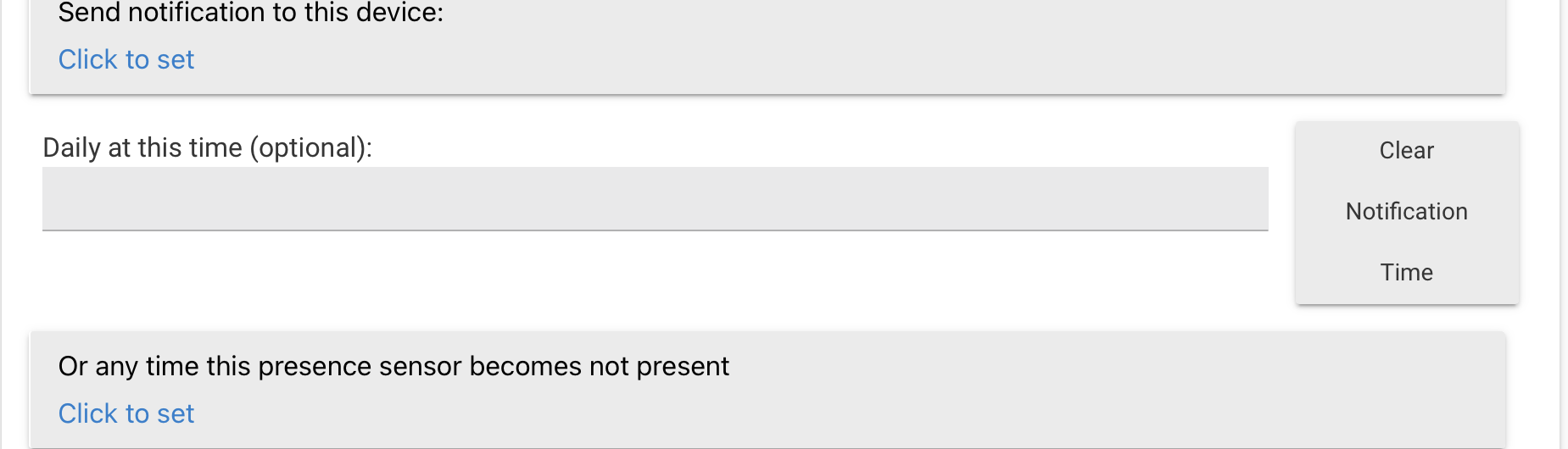

Must be an odd thing with Safari's date picker, though it's odd it doesn't render that way for me. This post is 7 years old but still accurate with a quick test (including the link to the demo) for me. :slight_smile: https://stackoverflow.com/questions/52218578/clear-html5-date-input-on-ios
If you can use a different browser, even desktop Safari, for this, that should work.
Not the prettiest.

Interesting that on the latest beta, the RESET button in the Safari picker now CLEARS the date/time and lets you save it a “empty’.
