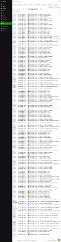

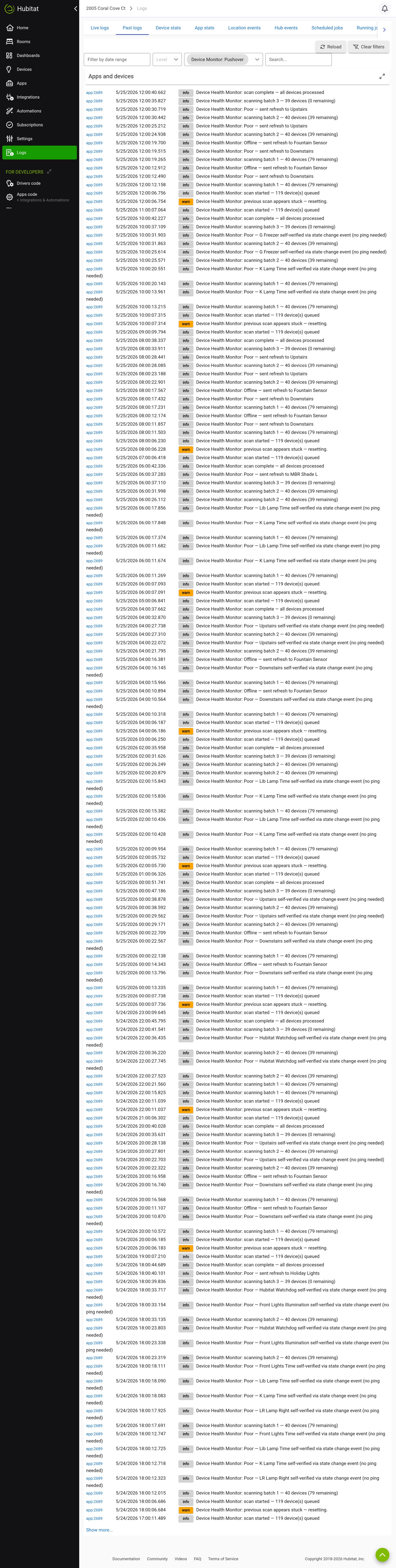

Since yesterday afternoon, the scan doesn't run every other hour. Seems to coincide with installing your last update.
- Enable debug logging
- Tap Done all the way out of the app
- Wait for the next scheduled cycle and share logs
Most likely the schedule got offset when you installed the update and a simple Done will fix it.
