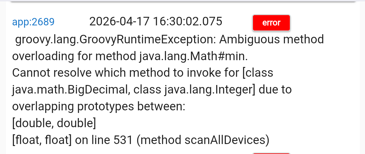

State persistence fix (critical) Samples were not being saved between scans due to a Groovy/Hubitat state mutation bug. Mutations to nested map collections (data.samples << value) modify the in-memory object but Hubitat doesn't automatically persist the change. The fix forces explicit re-assignment after every write. This was the root cause of devices showing 0 samples or "Never" for Last Seen even after multiple scan cycles.
Dynamic sample gate The minimum time between recorded samples is now dynamic instead of a hardcoded 10 minutes. The gate is set to half the scan interval, capped at 30 minutes. On a 3h scan the gate is 90 minutes; on an hourly scan it's 30 minutes; on the 30-minute scan option it's 15 minutes. This fixes devices like switches and contact sensors that fire multiple times in quick succession — previously all of those events were ignored, preventing samples from ever accumulating.
Clickable device names Device names in the Activity Summary and Problem Devices tables are now clickable links that open the device edit page directly in your hub's UI. Works on your local network only — same behavior as Battery Monitor 2.0.
I will repair this shortly... Override was suppose to stay unlocked after you made the entry.... When you fix, or add something, other things tend to break.
