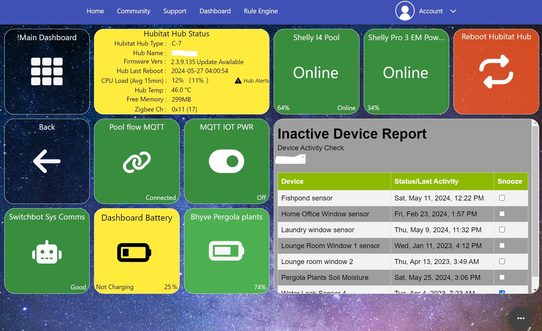

Thanks for all your hard work developing this App, I have been using this for a number of years and found it very useful. I have just been looking at integrating the Cloud report into my Sharptools Dashboard which works great, but I was wondering if there could be an option to show or hide the Snooze Column? As space is a premium on dashboards would prefer for it not to be using up space as intending adding another instance of Device inactivity for devices with Low battery
I will think about this for the future. However, is this really the easiest or best way to get that into this dashboard in the first place? (Legitimate question, not a doubt--I don't use dashboards of any kind much anymore.) Would a string variable or string attribute on some device be better? Those are things I've thought about.
In the meantime, if you are at all familiar with Groovy (or can work you way through enough to figure it out), customizing the createReportHTML() method in this app, starting around like 878 in the current version, can probably get you something like what you want -- and perhaps without other things you don't need, too. Entirely removing the td around lines 907-919 would take care of this specific request.
Thanks for your response, I must have missed the string variable option, I was originally after that type of solution until stumbling onto the HTML report. I'm not that familiar with Groovy but will take a look at your suggestion to edit it as string variable method will be a bit messy passing it to Sharptools and then formatting it.

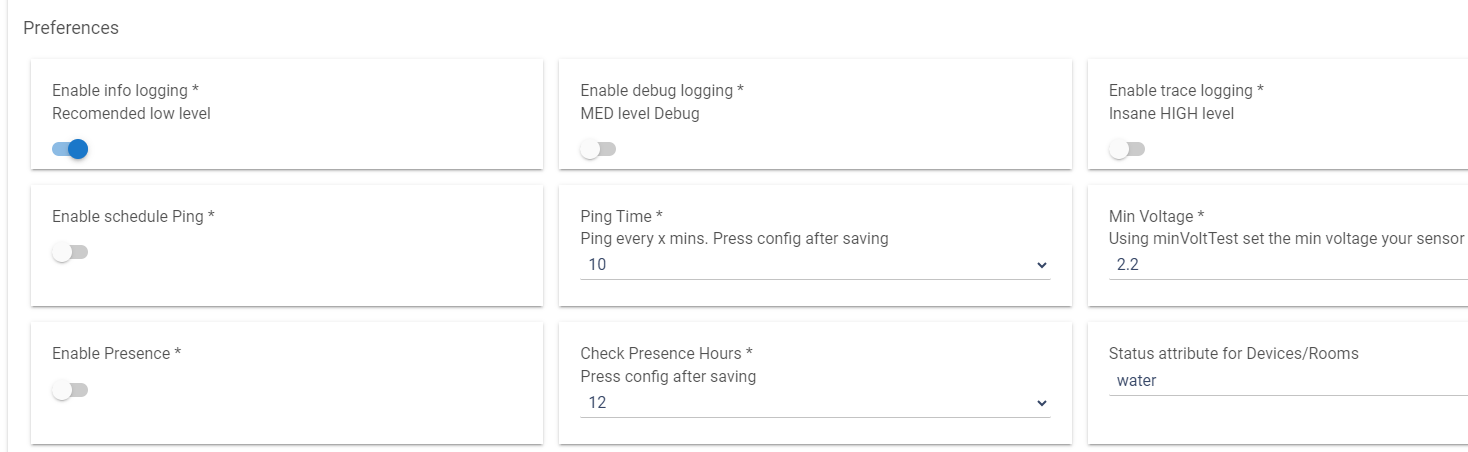

@Horseflesh I found that the driver you are talking about does work but you don't even need the Presence thing turned on. https://raw.githubusercontent.com/tmastersmart/hubitat-code/main/third-reality-water-sensor.groovy
This is the settings I use, I am not a fan of the fake presence attributes.
You could set the ping to whatever you want.
Save and then run Configure when settings are how you want it,
The device reports it state every hour which updates the Last Activity, so it works perfectly with this app. This is on the 00000038 firmware version.
