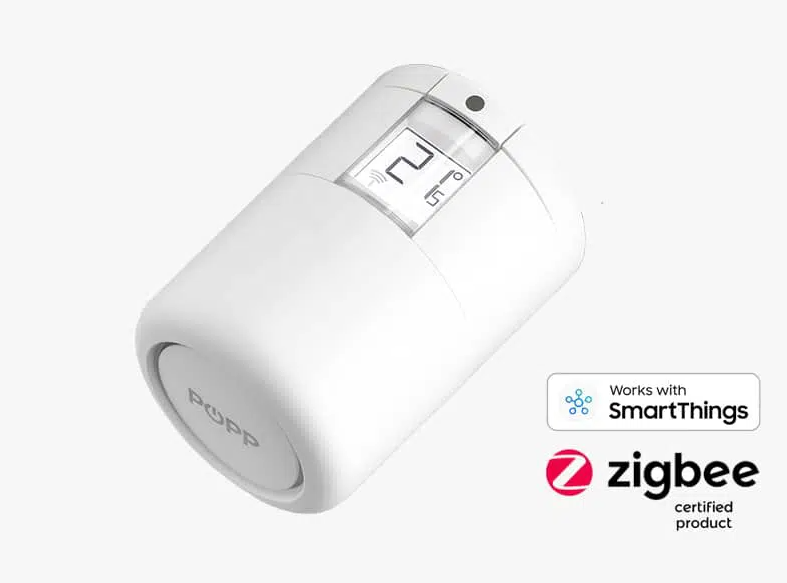

Hi guys, perhaps somebody could help me a bit with some issues I encounter with POPP 701721 .
I just installed a POPP 701721 TRV and paired with HE C-7 running 2.3.3.140.
  • After pairing I'm selecting the proper driver - so thanks to the Mark - (Danfoss Living Connect and POPP Radiator The...) - tried both the raw link and the version from GitHUB (think they are the same though) and save the device.
  • Then I press 3 seconds the button on the TRV (to exit pairing mode) and it's displaying correctly the temperature and zigbee network icon (not flashing). Then I set heatingSetpoint to 22C and click configure. Right now the device enters in Maintenance mode (and stays like that), so I press again the button 3 seconds to exit maintenance mode, it's exiting the maintenance mode but now the zigbee network icon is flashing and seems like there's no communication any more between HE and the TRV.
  • I try now to repair the TRV to the hub (without removing it as a device from HE), the hub sees it and then the zigbee network icon stops flashing - so communication established again.
  • at this point I don't touch any config any more but after about a minute or two, the TRV enters maintenance mode again. If I exit maintenance mode, zigbee network icon flashing again (left it like that for a night and in the morning still flashing) + no communication from the HE to TRV.
  • If I try pairing it again (without removal) the zigbee icon shows connected but the after few minutes it goes into maintenance again (like in a loop).
    I've also reseted the device according to manufacturer's procedure (removing a battery and pressing the button before re-inserting the battery + release button when stops flashing), remove it completely from HE several times and added it as a new device but I always end up in the same loop.
I have the device since about 4-5 days and in the first 3 days it was working properly.
Did any of you encountered such behaviour?
Should I try to control it via MQTT?
Any suggestions are welcomed!
Thanks guys!
John

There z-wave devices
Hi Mark and thanks for your reply.
You say I would need to pair it with Hubitat as a Z-Wave device?
It says clearly on the product it's a zigbee version.
The driver wasn't developed for that version, must be new
Have you tried any of the stock thermostat driver's
