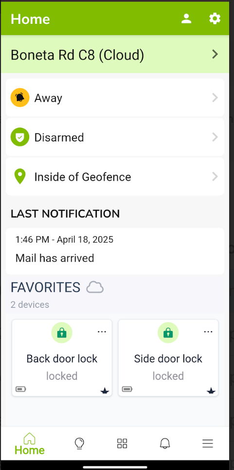

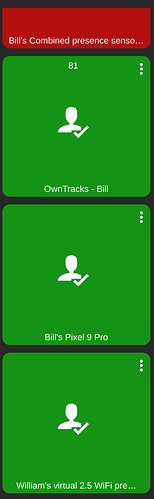

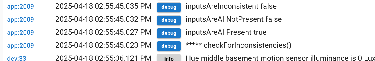

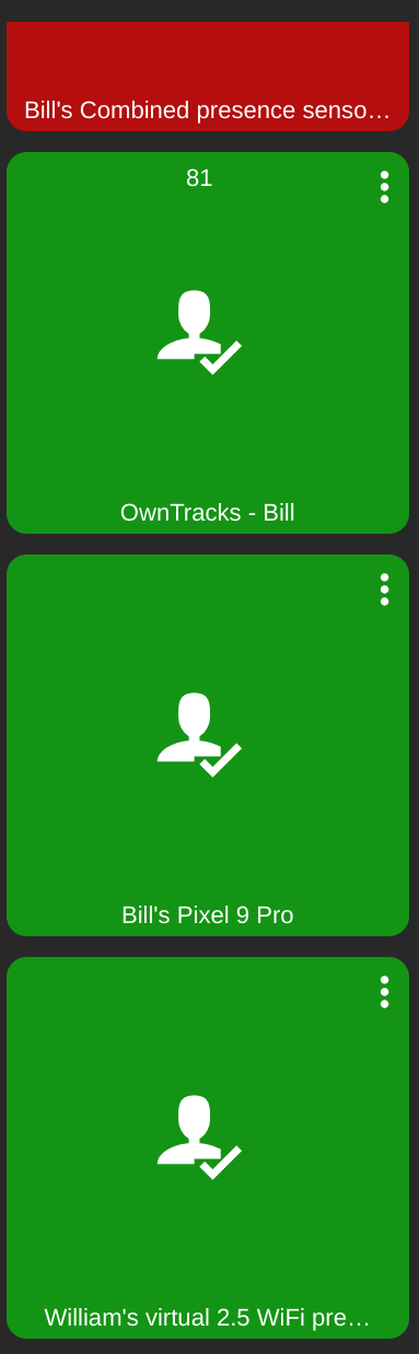

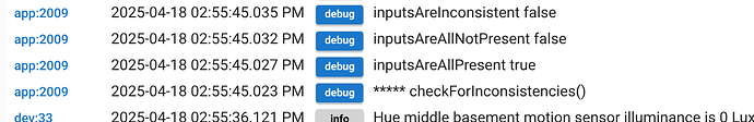

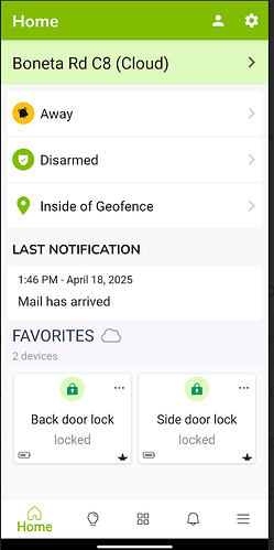

I'm seeing Not present for combined presence with this diag log info. This has always worked flawlessly in the past. Rebooting and rolling back a few hub updates made no difference. Mobile app shows inside geofence but Away.
I'm wondering if this is the intended behavior. I've only had this issue lately, like the last few months. Occasionally, when my phone GPS thinks I've teleported outside the geofence and reports not present, the combined presence also changes to not present. I thought the standard container was supposed to prevent that? I've used this app for years now with no issues until recently. Sometimes I'm at home and all my lights just turn off because Hubitat thinks everyone has left and no one is home.
I know the wifi sensor isn't used to detect departures but for faster arrivals. But does it not protect against erroneous GPS departures as well?

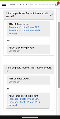

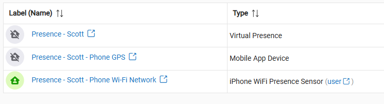

It's always hard to tell with intermittent issues, but do far it seems to have fixed it. I configured it the way I had assumed the standard container already worked, like this
Thank you this has been driving me nuts. GPS should NOT trigger a departure if wifi based sensors are still present. I don't know why this isn't the default because it seems the most logical. What happens is inside the home the gps can drop satellites so Google location reverts to cellular triangulation, which puts me about 1/2mi outside my home. I don't want the zone that large. I will give the advanced combiner a try

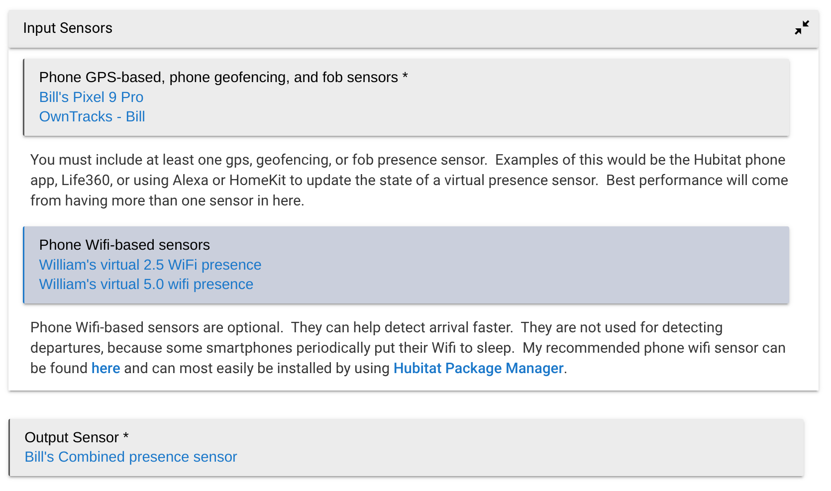

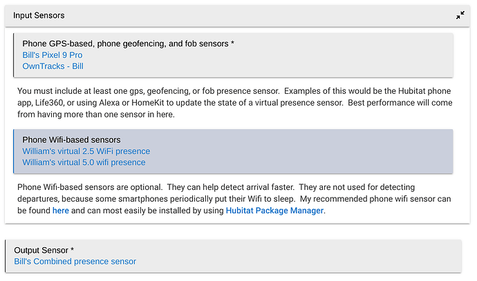

Original developer here. I'm not checking in on the forums as often as I used to, because my apps/drivers are mostly pretty stable anymore.
I hear what you're saying about "GPS should not trigger a departure if wifi sensors are still present". I understand your example case of cellular triangulation, and I agree that is not optimal in a "pure logic" sense. There are two reasons why it is not implemented that way:
  1. As the code is written, it responds instantly to state changes. It doesn't come back later to evaluate complex rules. So, let's take your example: your phone's GPS jumps to somewhere a mile away. Your phone reports departure. The app sees that we still have wifi. With your logic, we would NOT switch to departed yet. We'd need to wait until the wifi sensor triggers as departed, then re-evaluate all the sensors. Only if every one has departed now, then we depart. This could work. It still has some edge cases and holes in the logic. It could misbehave if your phone switched to cellular triangulation and also put its wifi chip to sleep sometime around then. There's always tradeoffs with these unreliable sensors. (I mean unreliable in the sense that the gps can switch to cellular triangulation and get position wrong. Or the phone can put its wifi chip to sleep and fall off the network.) The real reason I haven't implemented that is that I've never experienced it myself. But then there's a second tradeoff:
  2. Wifi-based detection is slow to detect departures. It takes several minutes before we can reliably say the phone isn't responding. So if I implemented this, it would add a delay before departure is detected. For some people, that's not wanted.
All that to say, I do look at pull requests. If someone wanted to code up this behavior in the standard combiner, and maybe put it behind a toggle switch, I'd review the code and maybe merge it in.

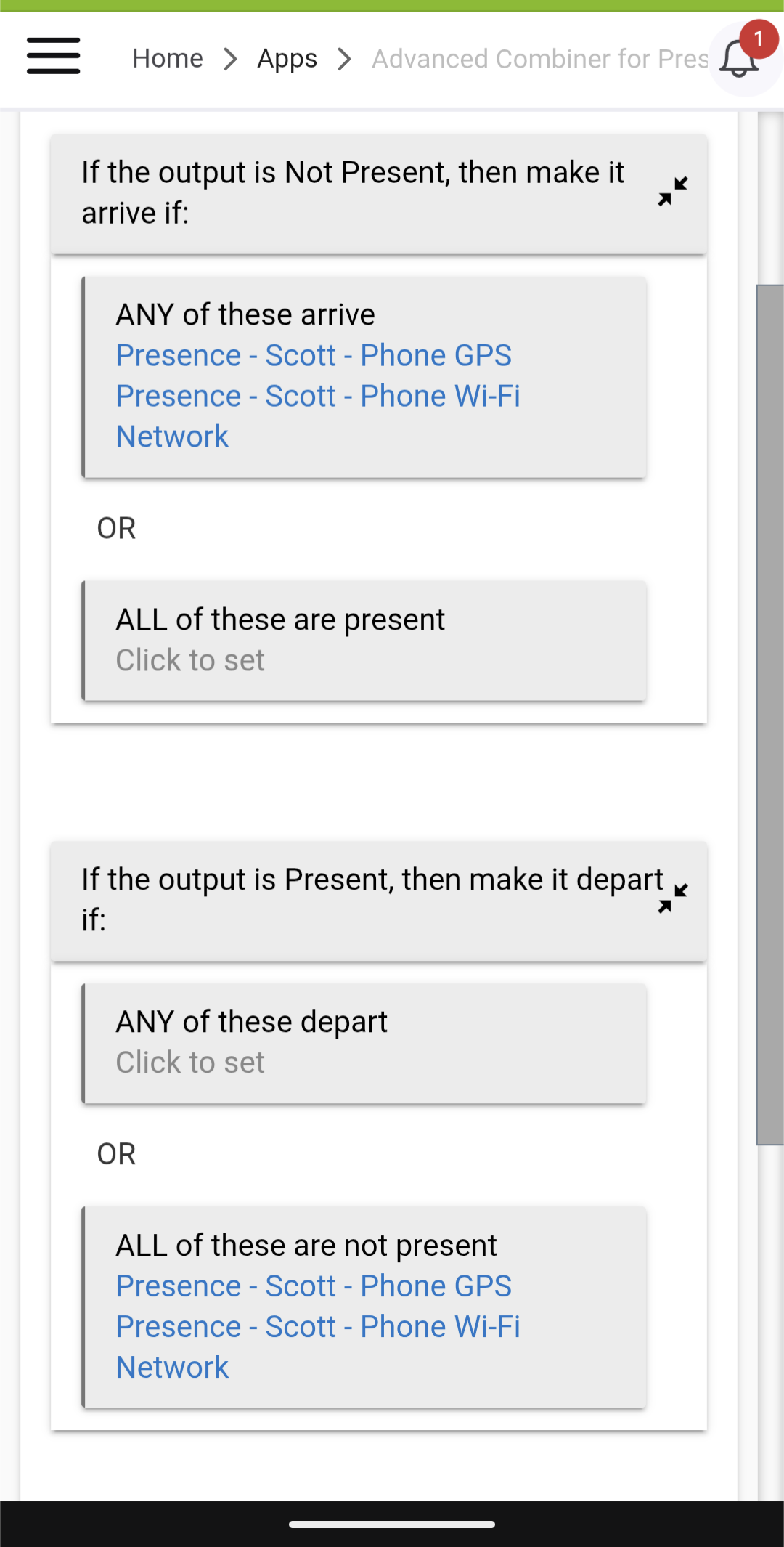

Or you might be able to get what you want from the standard combiner too.
Hi and thanks for acknowledging the issue it presented for my use case. I was able to get the behavior I am after by using the advanced combiner, and simply saying individual departure only occurs if both GPS and Wifi are not present.
