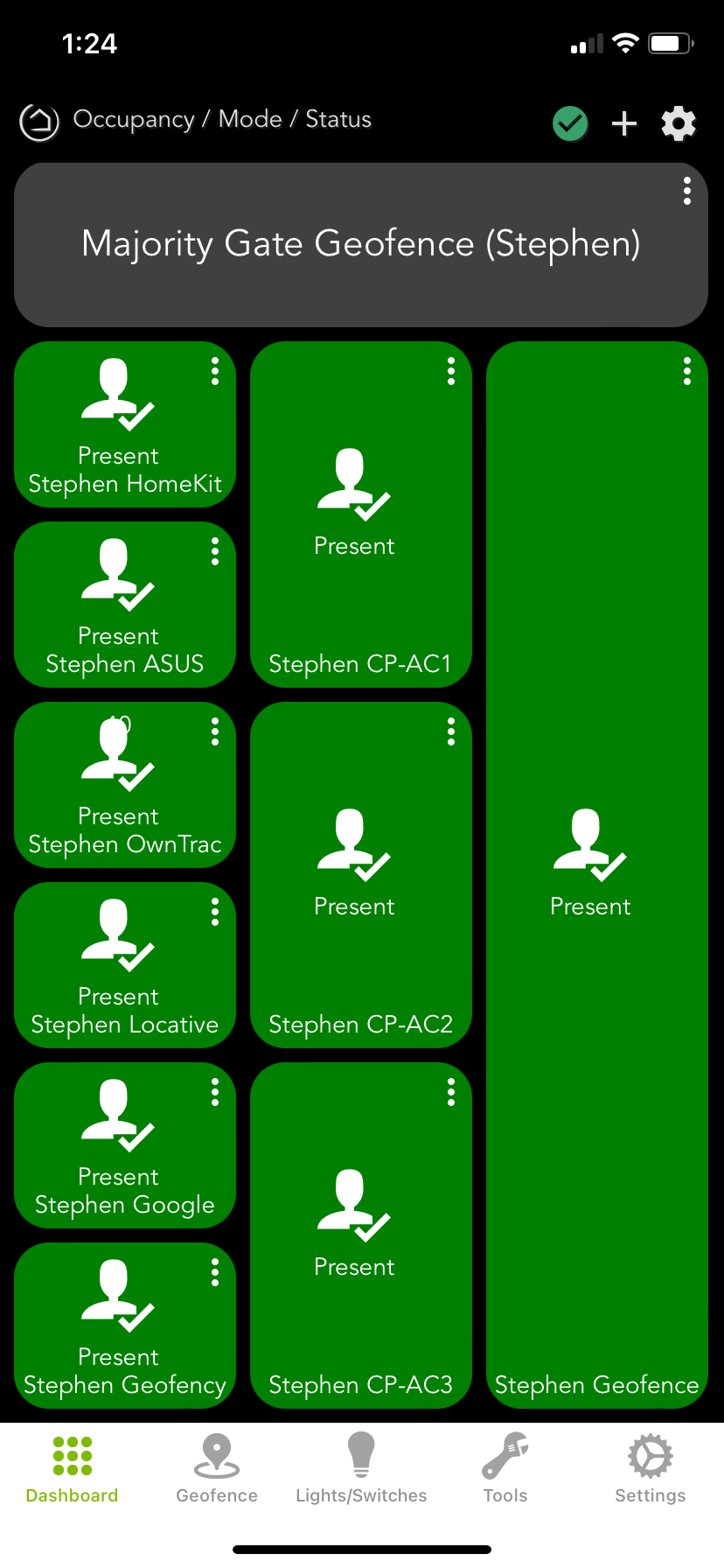

Joe, I currently use them. I have 6 geofence detection systems that are fed in pairs into a ‘best of 3’ majority gate giving a final geofence Present / Not Present per family member. The logic is represented in my dashboard view below (where CP-AC1 = Combined Presence-Advanced Combiner 1) for Advanced Combiners 1, 2 & 3. It may be overkill but provides multiple levels of redundancy and I have never had a presence failure in over 3 years. I did have Life360 in the mix until they pulled the plug, so replaced it with Google Home.
The geofence presence then is combined with WiFi presence via another Advanced Combiner to give a final aggregated Present / Not Present per individual (as shown in the second dashboard screenshot) and then a Boolean OR combiner to get the final Resident Home status.

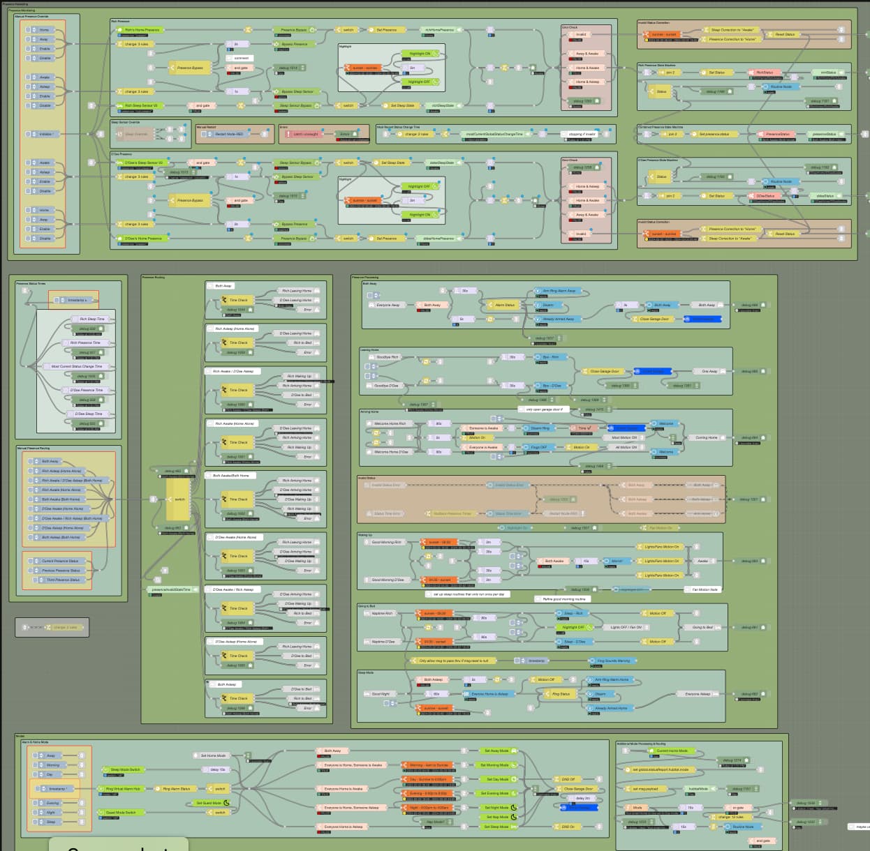

For a little background on my use, I'm using Node-Red to process all of my presence flows. The flows are very complex (see attached pic for an example of just my first tab of flows). Within the Hubitat app I'm using four different advanced combiners. Two of them track home/away presence for me and my wife using wifi presence, a virtual switch based on location reporting from the apple home app, and the hubitat mobile app. The other two track sleep/awake presence using Withings sleep sensors and the Sleep Number presence sensors (both of which have their issues, but work very reliably with advanced combiner).
Of course, the four advanced combiners report to one virtual output "sensor" each. Those four virtual sensors and their individual states are the very first nodes in my presence flows and are the bedrock of everything else that happens within my home automation. As far as I know, there is nothing else like it in the thousands of nodes available in the Node-Red library.
For me the advanced combiner has been bulletproof. I would be quite sad if it didn't exist. I could probably find a work around eventually, but it would be rather complex and probably require some coding. I'd rather not have to reinvent the wheel if I can avoid it.
