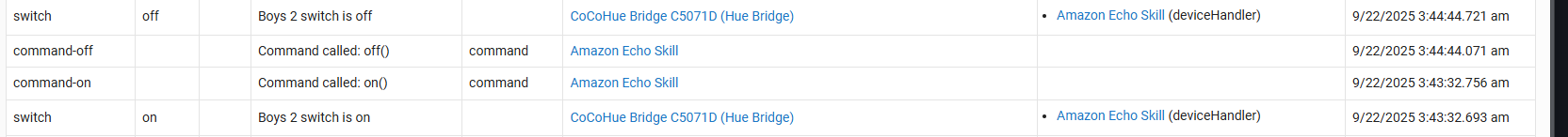

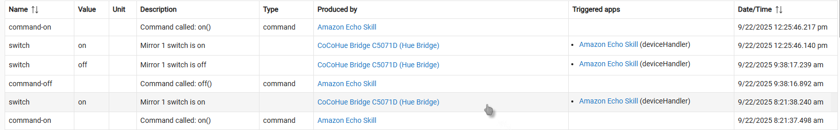

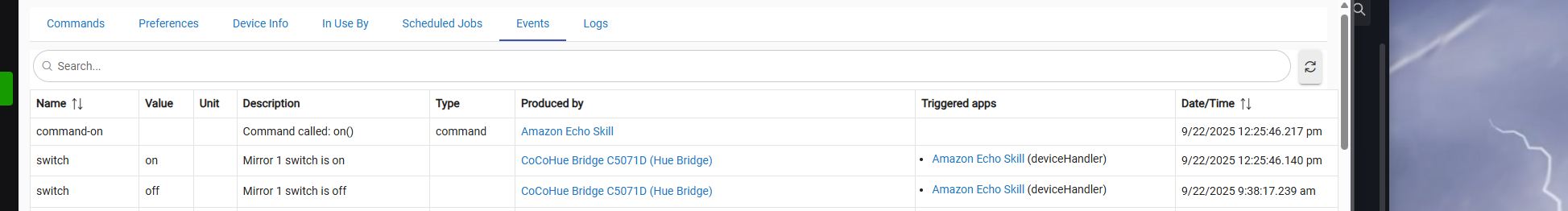

I am getting my lights flipping on all hours of the day and night on there own since I migrated to Hue Pro and CocoHue at the same time last week. I have verified no hunches or guard is running in alexa. Here are some logs showing produced by is cocohue. I am running the latest Cocohue just upgraded this morning by doing a repair. This is driving us crazy as its waking us up at night time. here are some screen shots of 2 bedrooms and the bathroom vanity mirror event logs. Any ideas would be extremely helpful. I am also on the very latest beta hubitat release. The top picture is the bedroom light going on int he middle of the night waking us up and using alexa to turn it off. The middle just happened at 12:25 and the bottom was another bedroom same time.
CoCoHue does not send on or off commands to devices on its own; that would have to be an app or driver on your hub -- or something else that integrates with your Hue Bridge. The screenshots you have show that it's unlikely to be anything on your hub (though it could still be if they are members of a Hue group you've added to your hub; check those for command history, too).
Since you mentioned Alexa, that's my #1 guess. Did you disable Alexa Hunches? This "feature" has been known to cause problems like this (and is on by default).
I have disabled hunches. routines, ultrasound and checked the Alexa logs in alexa privacy settings. There is no call being made by the app to turn on the lights. I have no saved groups or routines on the hue pro bridge. I have tried CoCo integration and Hubitat Native hue integration. I have removed and rebuilt Alexa and Hue integration. The lights do not turn on or off on their own till Hubitat is added to the mix. I am ready to toss the whole Hubitat system out the window. This has been going on for over a week.
Go to the "In Use By" tab of the device that is misbehaving. If the event is coming from Hubitat the list will have the potential sources.
Perhaps do a restart with a database rebuild.
And the device will also show the command in the "Events" tab of the device detail page, though with Hue devices it could be the light itself, a group (room/zone) it's in, or a scene it's a part of, any of which may or may not be added to Hubitat but would require looking at all possibilities if it is. From the above, I don't see any commands being sent, which means it can't be the hub -- at least not for the device in that screenshot.

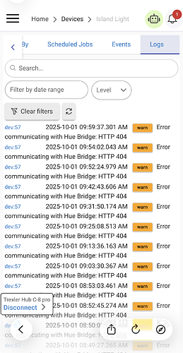

Hello, I’ve installed the latest code for Cocohue and even repaired it but I get a 404 error for just 1 device. How do I figure this out?
I can control the device just fine from the hue app, but not from Hubitat. All other hue devices work great.
Sounds like that device (on your hub) doesn't exist anymore (on the bridge). Go to the page to add/manage a light, group, sensor, or whatever kind of device this is in the CoCoHue app, and you'll see a match up of what you have and what is or isn't found on the bridge.
Brought it back in thanks!
Its on the bridge as a group that wasn't added. It was obviously added before because i had a fully integrated device in hubitat.
Seems like it just disassociated itself in some way
I've noticed that if you remove all devices from a room in the Hue mobile app, it creates a new ID when you add devices back into it -- even though you didn't remove the room in the meantime. (This would result in the outcome above.) This happened to be recently when I replaced some of my bulbs with the newer models. Just one guess as to what it could be for you!

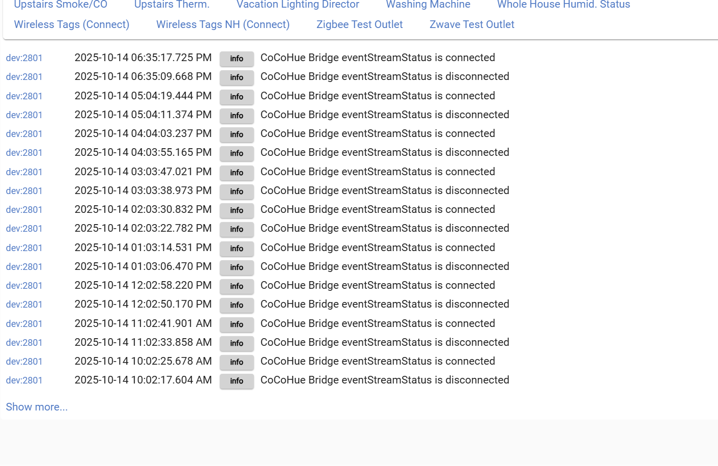

since i am having hue issues my one hub running std hue drivers built in.
i decided to check the other
using cocohue..
getting this message in the logs every 12 secs.
any ideas
There is some discussion of this above, but basically, it's more or less expected despite some effort the driver makes to suppress quick, seemingly spurious, disconnects.
