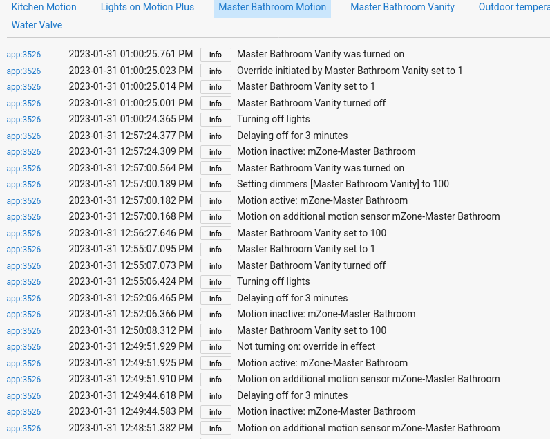

I finally had time to update again. As soon as ML turns off the Hue lights, they come back on at 1%. This happens with my Motion Lighting apps that have Hue light groups. It goes away if I downgrade to 4.1.2.
From the CoCoHue group:
From the ML app:
From the CoCoHue group events page:
I hope this is helpful.

I spoke too soon. Now instead of 1%, it is turning on to 0% as soon as ML turns off the lights, preventing them from visibly turning on with motion.
I'm not sure what could be going on there. The specific logs I was looking at were these:
From the bottom up, first it got the message that group 5 (Master Bathroom Vanity, it seems) was off, then it got level 0.0, which I was originally parsing as 1 instead of 0 because the v1 API never reported 0, and either the v2 API didn't in my testing or was changed at some point. But that will now get converted to 0. (Thinking about this more, I'm not sure that's the right approach; maybe it should just be ignored. Or, IMHO, not reported like this in the API; v1 didn't do this, and it seems unnecessary because "on" is what you can look at to get the switch state...)
Anyway, the very last/top entry here is something calling "setLevel." That's not CoCoHue but must be some other app. I'm guessing that's your ML instance, but I can't say why. Could something in that ML onfiguration be causing this oddity?
Seeing that it’s 100%, that was probably from me hitting the wall switch because I couldn’t see. My ML instance has been very reliable (I try to stick with the KISS principle). I’m having the same issue on my other hub (also a different Hue bridge) with another ML rule using Hue lights. This did go away when I reverted back to 4.1.2, so it was something in 4.1.3 that broke my setup.
If you need me to experiment, let me know, I just don’t know how to code this.
