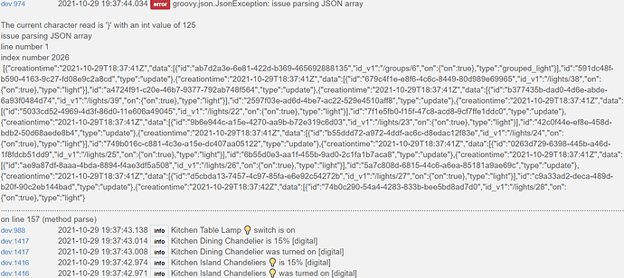

Ok, I'm able to reproduce:
If I use a rule to turn on my Kitchen Group + Kitchen Table Lamp (so one group and one bulb), I get the json error and the kitchen group status doesn't get updated. Here are the logs:
What's even more interesting is that if, in the rule, I first give an On command for the single bulb, then for the group, there's no errors. The error is triggered if the group is turned on before the bulb.
