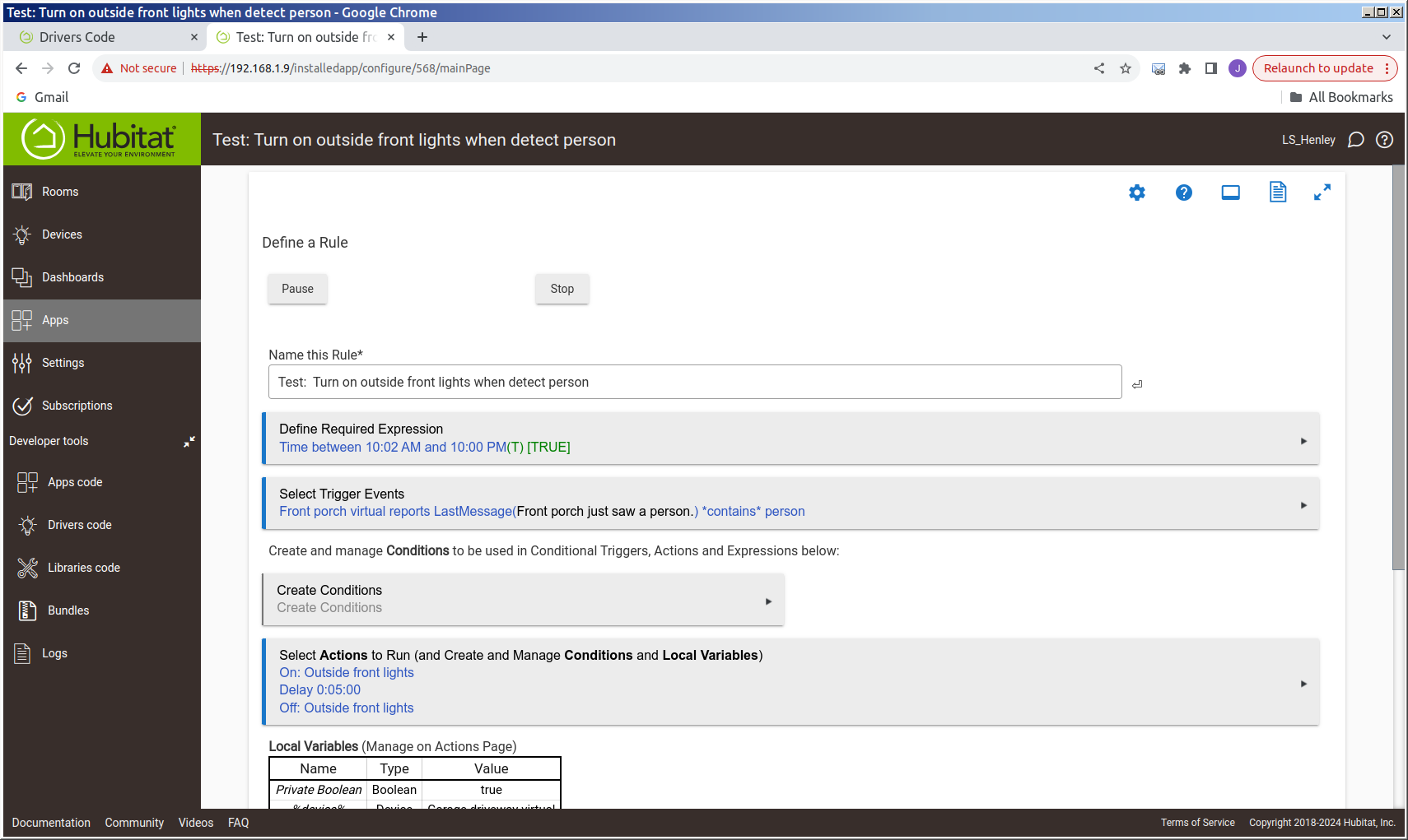

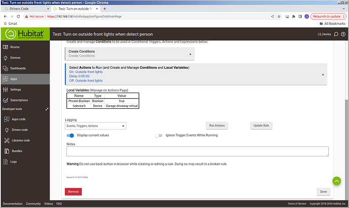

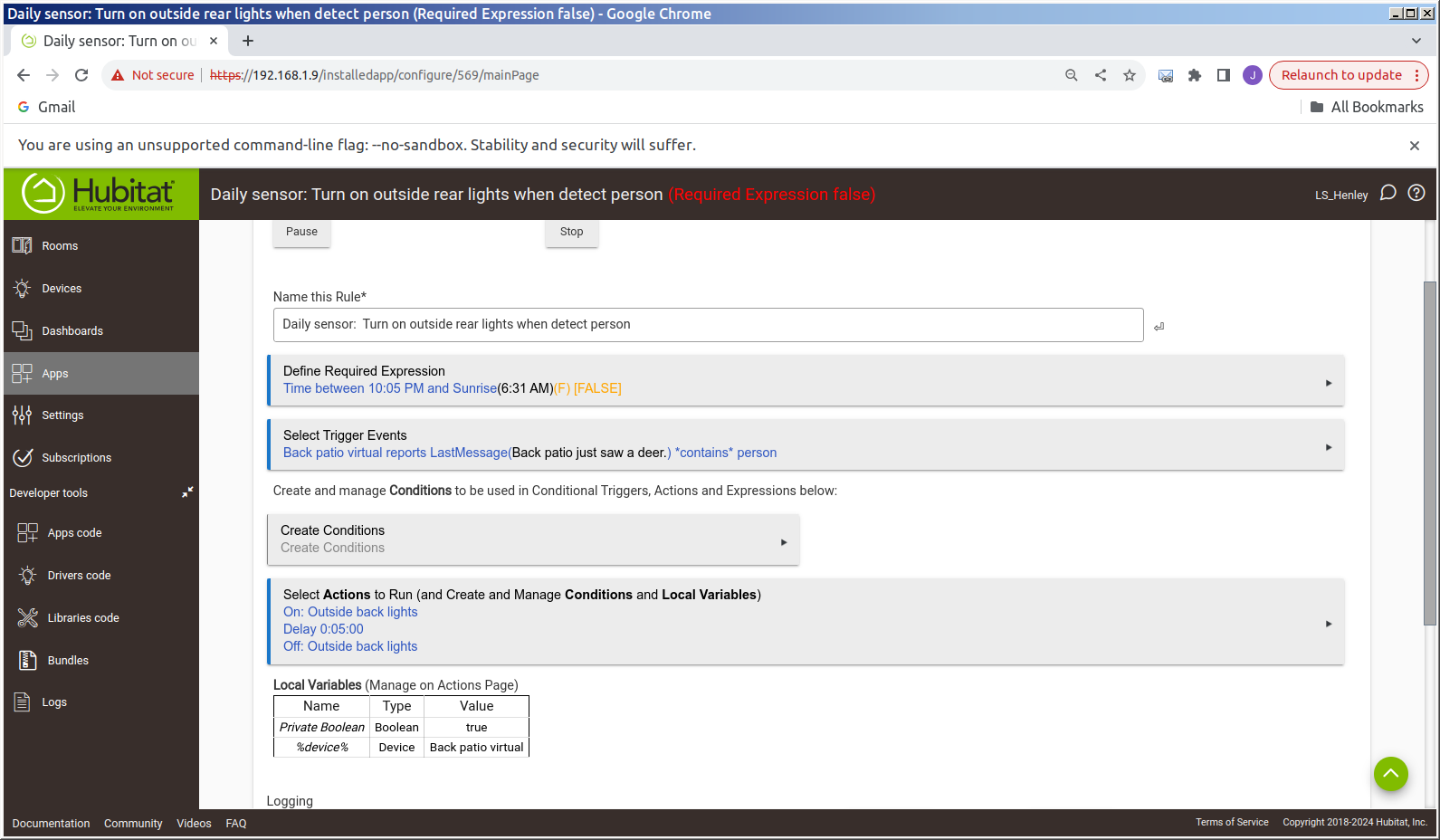

A couple of years ago, I set up and successfully ran Rules using the Camect to Hubitat drvers and apps. My Camect NVR would spot movement (via web cam), determine what was moving, and pass that info to the Hubitat to use in Rules. For example, I could have the web cam over my front door porch detect motion, the Camect would determine the motion was a person (not a wasp or a rabbit or etc.), and the Hubitat would turn on the front porch light.
A couple of years have passed and I recently realized the web cam-to-Hubitat-light-control was no longer working. I have updated my Hubitat firmware many times over that period; the Camect/Hubitat linkages (from Brian Wilson, bubba@bubba.org) has only had one very minor update in that time. While I have some notes from when I set it all up, I'm sure I've forgotten all the exact steps.
Since (it appears to me) the firmware changes for the Hubitat "Rules" have undergone the bulk of the updates, it is probably the source of why the Rule no longer works. In trying to debug the issue, I have determined the web cam to Camect are working and passing the info to the Hubitat. The Hubitat "gets" the info, but just doesn't respond to it (turn on the porch light).
In the following screen shots are what I found. Maybe someone can spot what the problem is. All comments and suggestions are appreciated.
Screen shots:
Rule_info
Device_front-porch-virtual_info
Device-log_front-porch
DFevice-log_rule-for-Camect-connect
Notes for screen shots::
  • It took several screen shots to get all the info in several shots; so they're marked *-1, *-2, etc.
  • All of this info was collected a few minutes after walking out onto the porch to (hopefully) trigger the porch light.
  • The porch light is a member of the "Outside front lights" group.
If you need further info or see other tests I should run, please let me know. Thanks!
Joe Henley

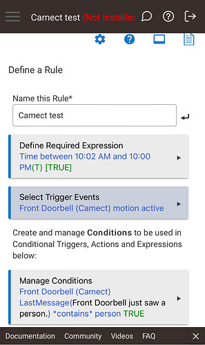

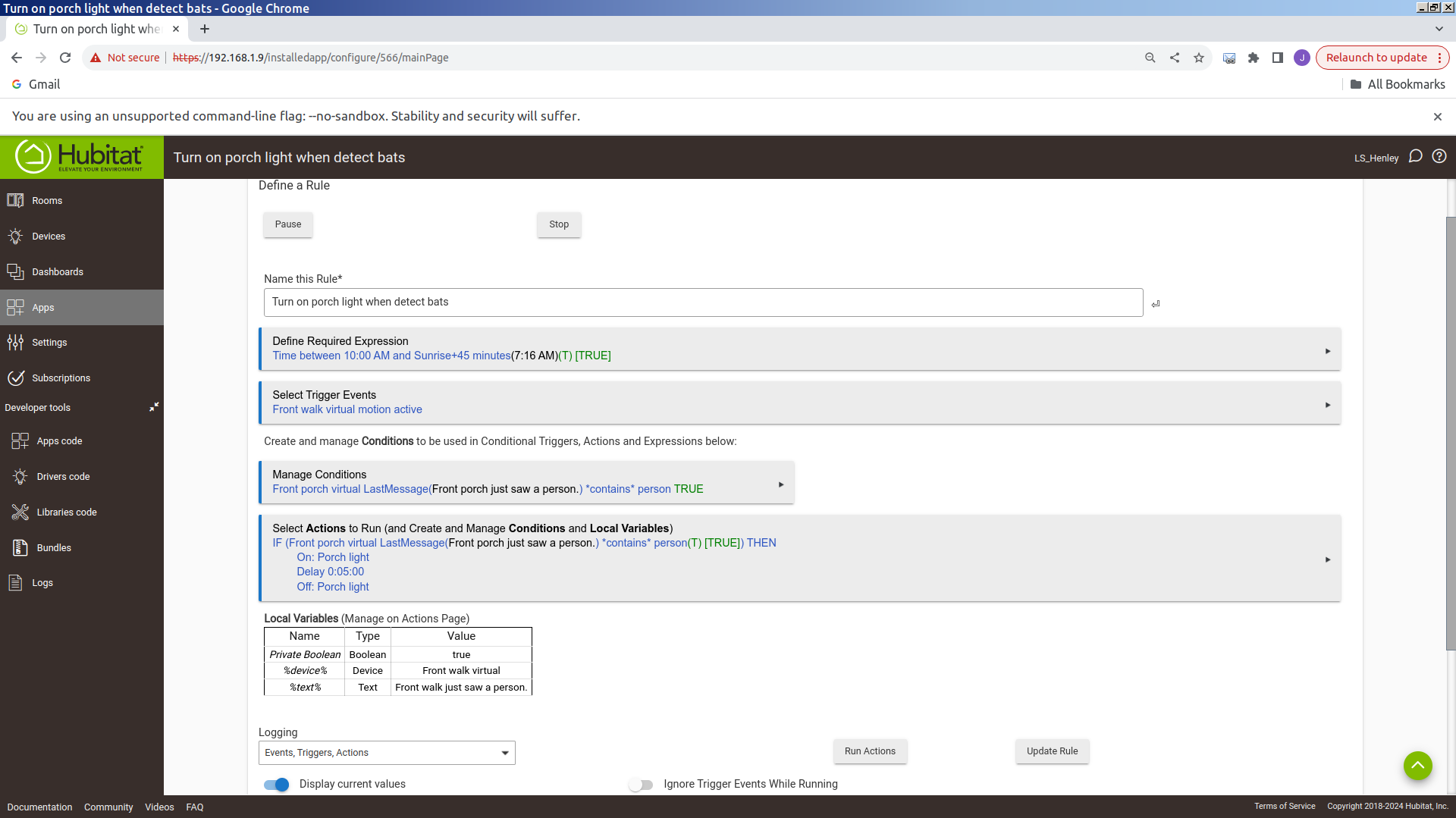

It’s hard to say what’s going on with the rule you created from the screenshots, please post a screenshot of the rule itself.
@user2318
I am going to merge this to this thread [Release] Camect Connect as @brianwilson still maintains this.
I was limited to only 5 images; relevant rule image is attached now.
Hi
Thanks for response. I was not sure where the problem lies, Camect Connect or Hubitat Rules. My guess is it's in the Rules. But however you folks want to point me is fine. Again, thanks!
Joe Henley
I’m no rule machine expert but I don’t think this rule will behave as intended because of the trigger.
A trigger needs an event to occur. Let’s say your Camect sees a person at 10:01am. That will cause the LastMessage attribute to be updated to read “front porch just saw a person.”
Your rule won’t trigger, because of the time restriction, and that’s fine since you configured it that way.
But if the person walks away, and then Camect sees them again at 10:02am, the rule still won’t trigger.
Why? Because the LastMessage attribute didn’t change.
At 10:01am, it was “front porch just saw a person,” and at 10:02am, it was still “front porch just saw a person.” Even though it was two separate motion events.
If the attribute doesn’t change, no event is generated by the hub, and there is no trigger for the rule to execute.
So the rule might work sometimes, if the last thing Camect saw on the front porch wasn’t a person.
In that case, when it sees a person, the attribute will update, an event will be generated, your rule will trigger (if it’s between 10:02am and 10pm), and the actions will execute.
Does that make sense?
Mark,
Thanks for the ideas. Yes, it makes sense. I always thought the "event" was the Camect sending the message (then it was tested to see if it included "person"). But let me test your idea a bit. I'll be back to you.
Joe Henley

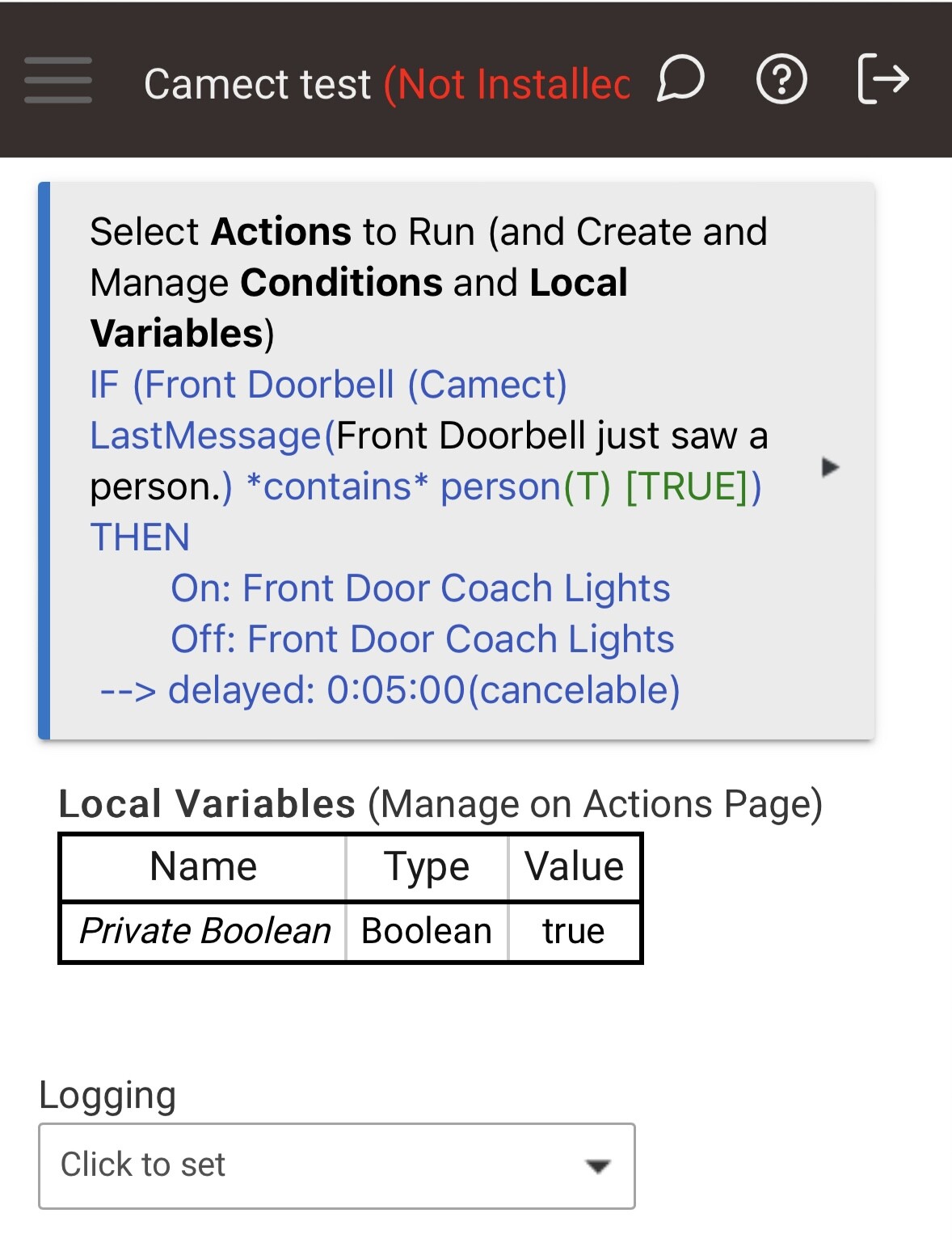

I think something like this would do what you want.
Between 10:02am and 10pm, the rule will trigger every time the motion sensor on the Camect virtual device becomes active (i.e. when Camect sees something new), but the actions will execute only when LastMessage contains “person” (i.e. the last thing Camect saw was a person).
Mark,
I recreated your logic on my Hub, see screenshot below. Unfortunately, it doesn't work.
As I recall, the Camect drivers are such that they work as motion detectors, and the need to work around the "triggering" problem was eliminated. One had only to use the Last Message in the trigger (see example that used to work).
So I'm back to wondering where the problem lies. That example above of "that used to work" actually used to work. But no more. I can no reason why. Thus my concern that with all the updates (a good thing) going on with Hubitat, something critical for my Rule logic got "thumped."
Further thoughts appreciated. Also hoping Brian Wilson might weigh in on this.
Thanks!
Joe Henley

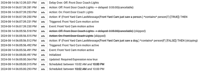

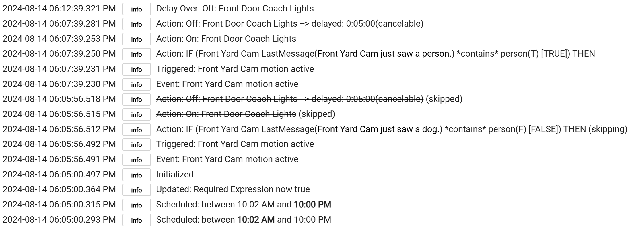

I don’t quite follow what you mean by this.
Can you post logs of your new rule when a person walks in front of the camera?
I’m actually on my way home as I write this, so I’m going to test out my version of the rule as I approach my front door.
From what you’ve posted so far, I believe your Camect integration appears to be working as intended.
Here's a log of the rule initalizing, triggering with camera motion, but not turning on the lights because the first motion event is a dog; the subsequent motion event is a person (me), so the rule not only triggers, but the actions execute, the lights turn on and turn off five minutes later.
The rule you originally posted won't work consistently, for the reason I explained. But this rule should act this way every time, I think.

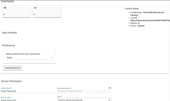

What does the Front Yard Cam "Device Information" (on the Device pasge for Front Yard Cam) look like for your set-up?
Joe
Like this:
