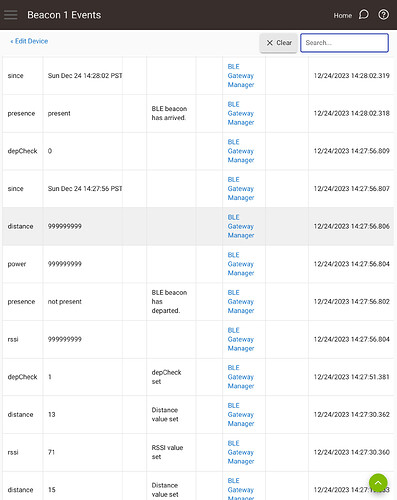

Unfortunately it doesn’t seem like the latest code change fix the behavior as I still see beacons going from present to not present when they’re actually not moving.
Any idea what’s going on? Let me know if you need additional data.

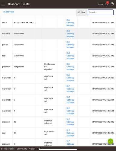

Do you see the depcheck variable on the beacon device being incremented in the logs? How often is your gateway transmitting data to the hub?

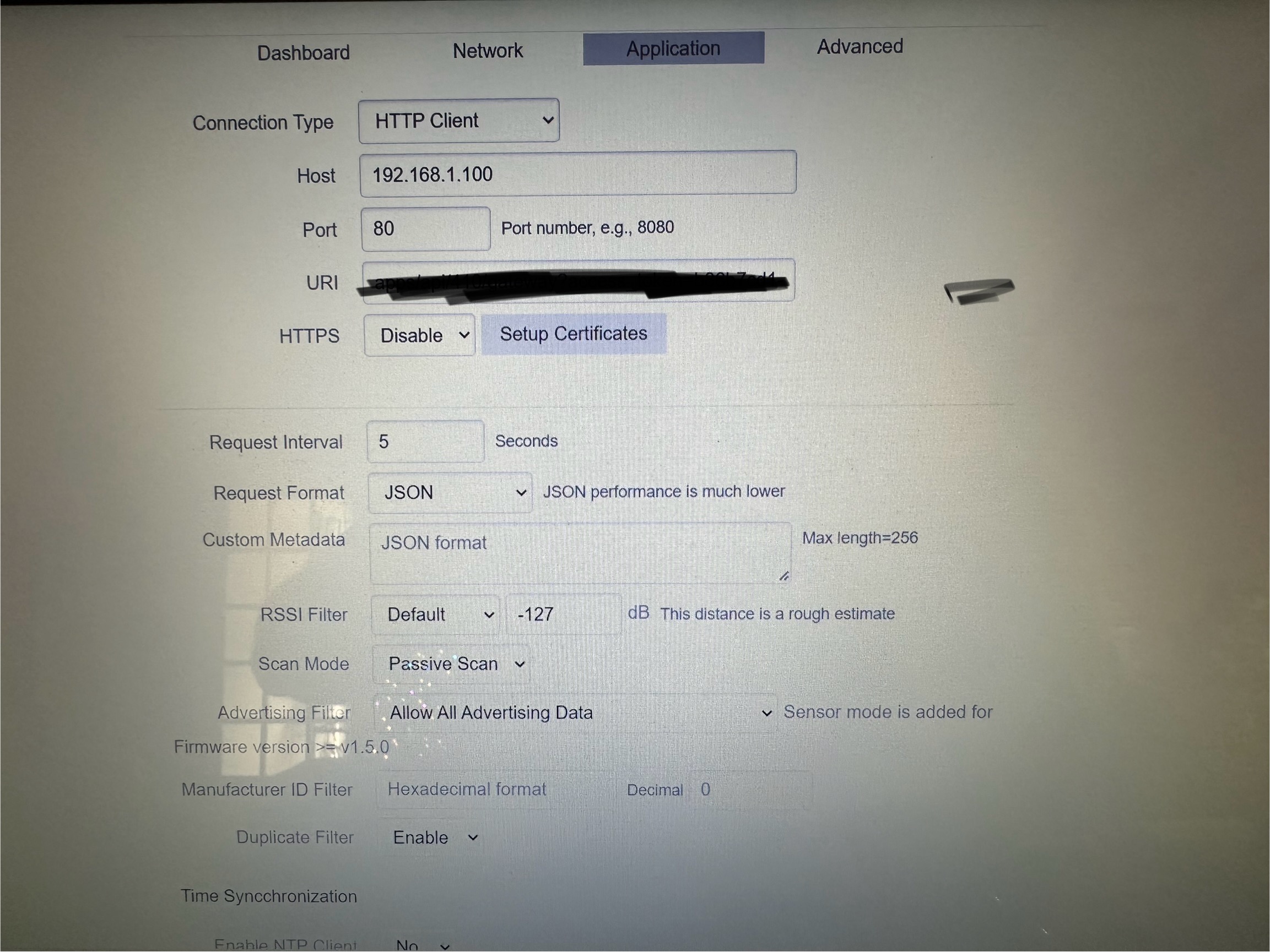

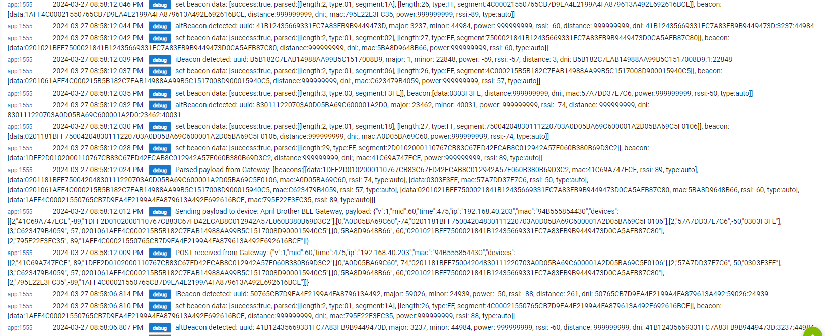

Below are the gateway and beacon settings, as well as a recent log where the beacon incorrectly shows as departed (with the dep check incrementing to 5).

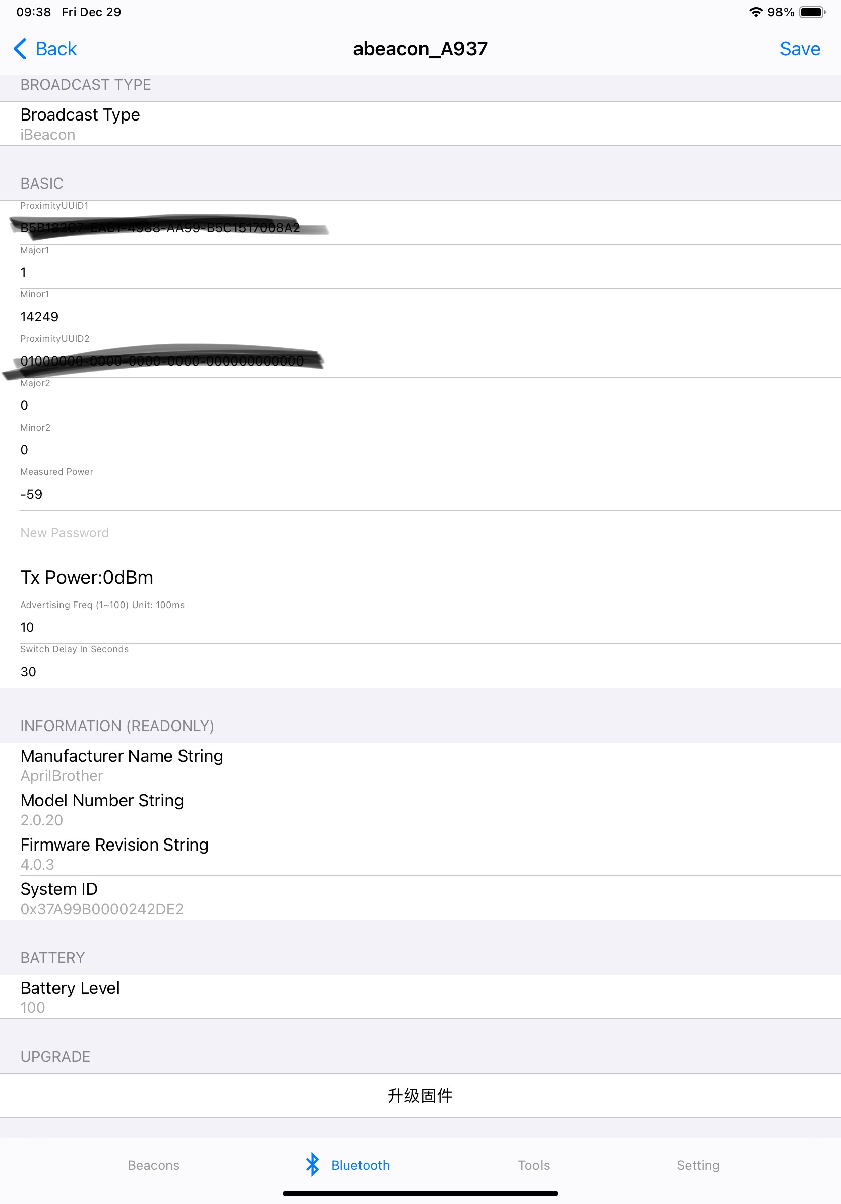

  2. Setup the beacons to broadcast every 2.5s to ensure a new data set is available when the gateway push the data to the app (every 5s)

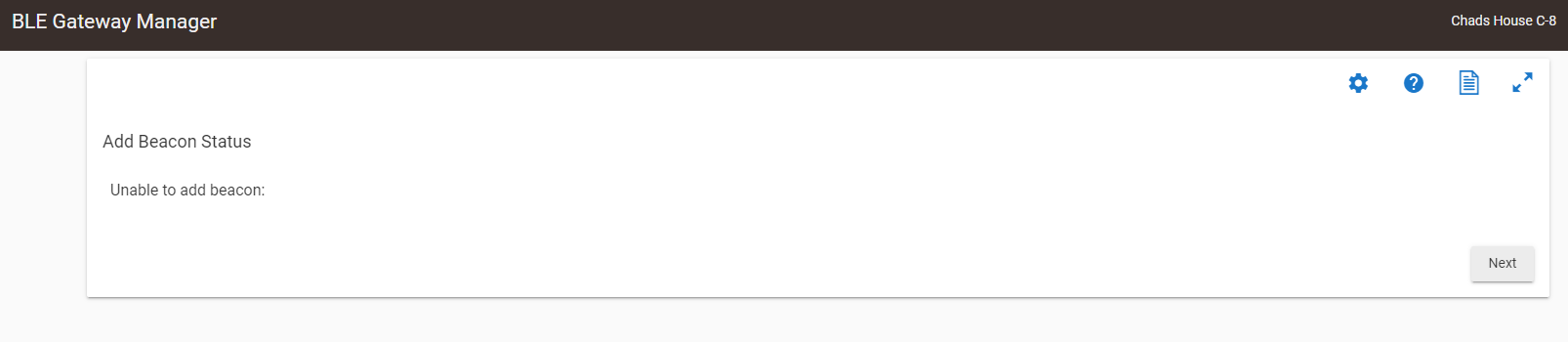

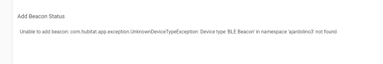

Hi @ajardolino3 , I recently purchased the AB BLE gateway and some N06 BLE Beacons. App and driver all installed fine, I can see data going to HE from the Beacon as well. When I go to add the beacon however, in the app, I get an error "Unable to add". I assume a child device should be created during this step? In my case it isn't. Looking for some advice as to what I could be doing wrong.
Hi Chad, can you please check the hubitat logs and see what errors you may be getting? Also, can you please provide a screenshot of the error. That will be helpful in troubleshooting, thanks.

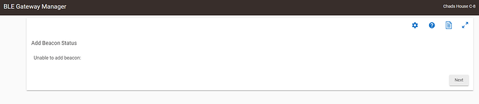

Hi, this is the only message I get, right in the app itself...

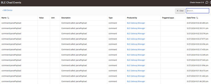

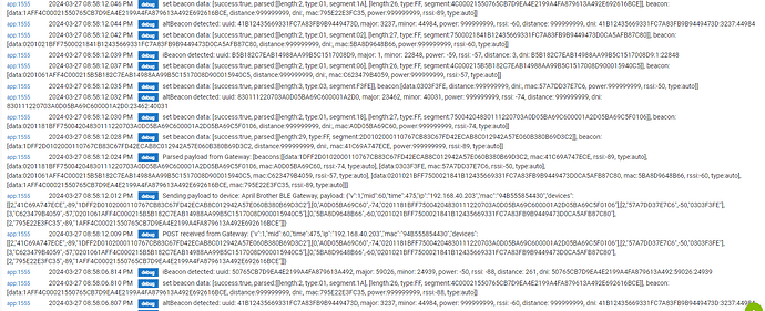

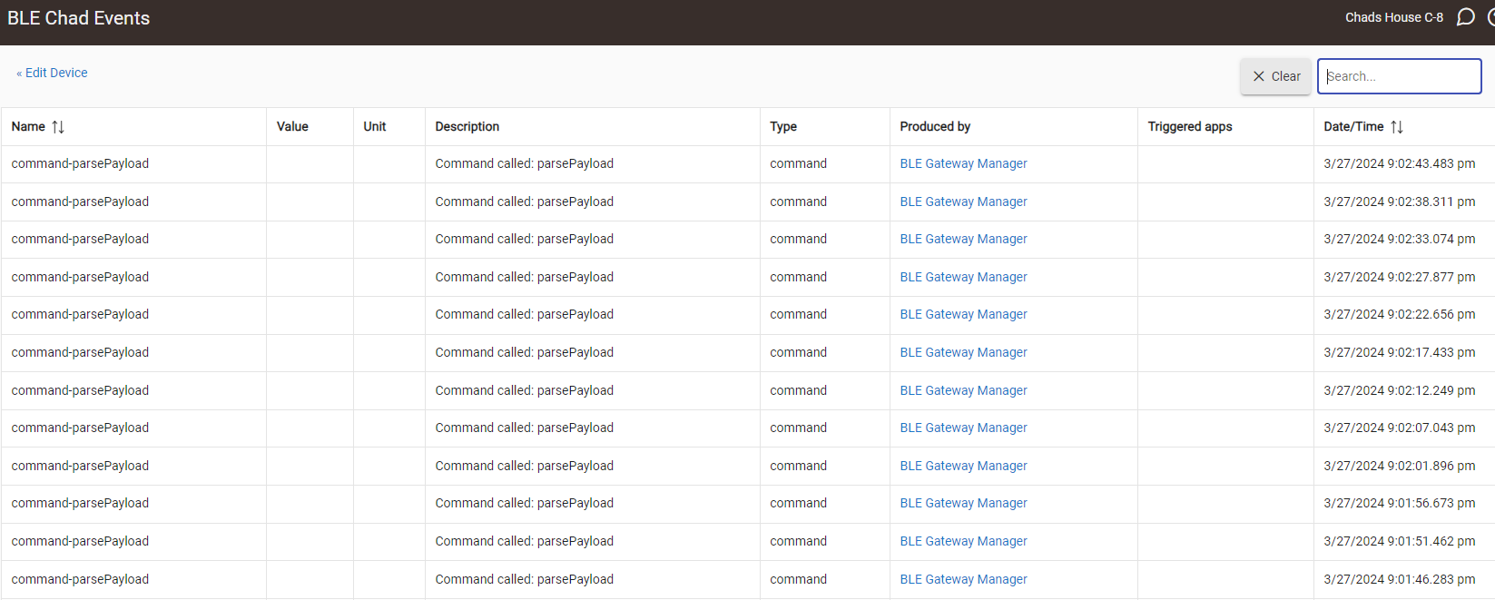

I am getting streams of continuous data like this...But no errors
Events are showing up in the device driver...

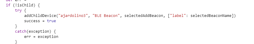

I see a bug in the app code on line 97. It currently is:
catch(exception) {
error = exception
but it should be:
catch(exception) {
err = exception
As a result, its not showing the error. Can you please update the code to match, and then try again? Hopefully that error message will help identify the issue.
ok, we have a clue,,,
I think its the title of the driver not being exactly BLE Beacon...
Two driver options on github, but neither has the correct name to become a child. Could that be it?
Did you install using the Hubitat Package Manager? It should set this up all automatically for you the correct way. I’m guessing that’s your problem.
I am sure I did initially, but that's when it didn't work. I have it working now, name: "BLE Beacon Modified" needed to be changed to "BLE Beacon" to comply with the apps call out for the child. In the app it is specifically looking for the "BLE Beacon". On GitHub it still has "BLE Beacon Modified"
