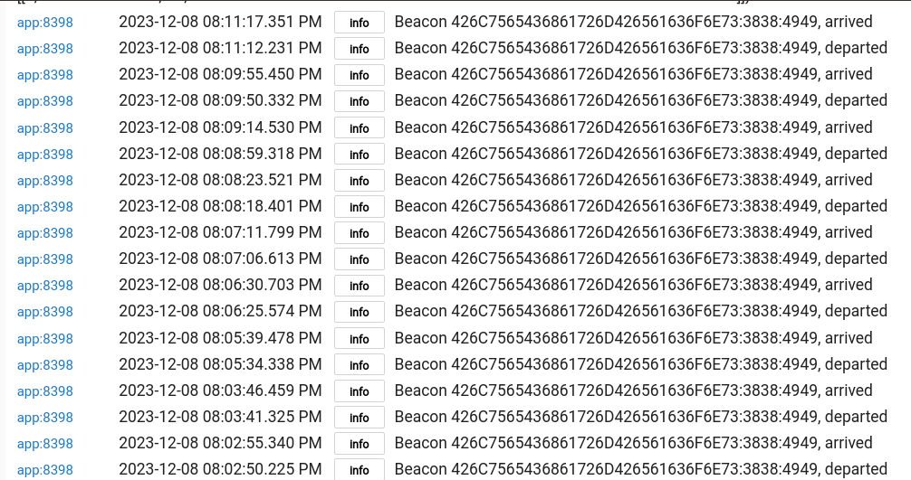

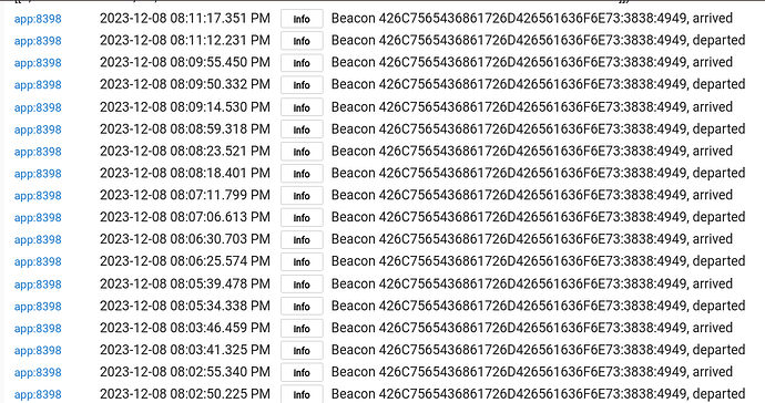

For testing I have the gateway in position towards the back of the house and I just have the beacon next to me in the Living Room. Maybe 20 ft or so apart and it just goes back and forth - present, not present, present, not present
Looking at this screenshot - is this normal for a battery powered beacon? What battery powered beacons do others recommend? Looking to see if I remembered to put the barrels on the street or not. Not critical but as is, won't work.
I see that in my logs for the gateway. The associated devices, looking at their events (I'm not seeing where to turn on logging) are behaving normally.
My device is reflecting the present/not present which would trigger any rule associated with it.
I'll probably just add some code to the driver to only display 'not present' after a certain time has passed without a 'present' signal.

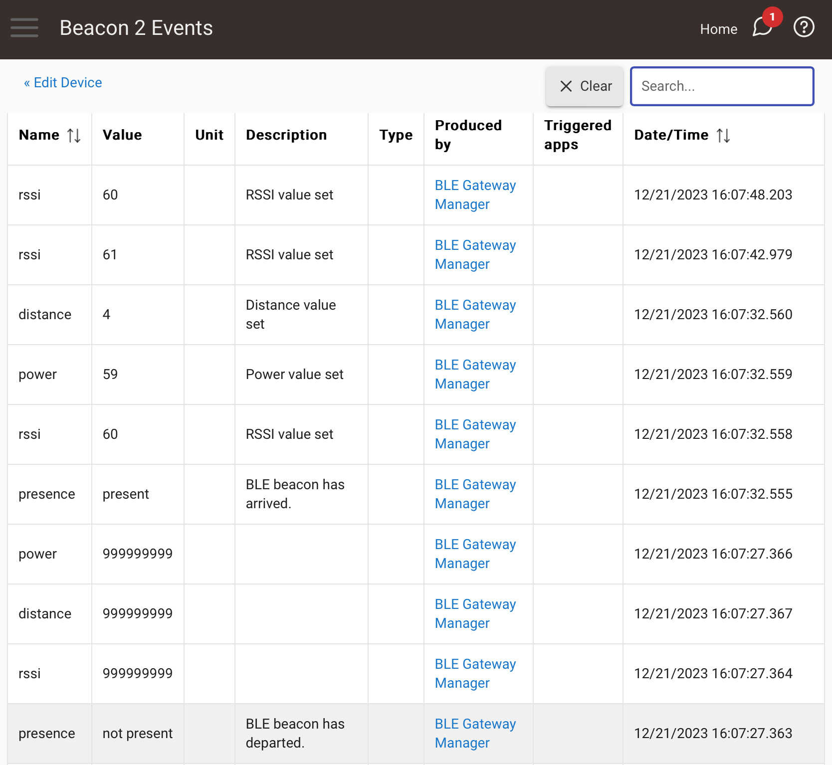

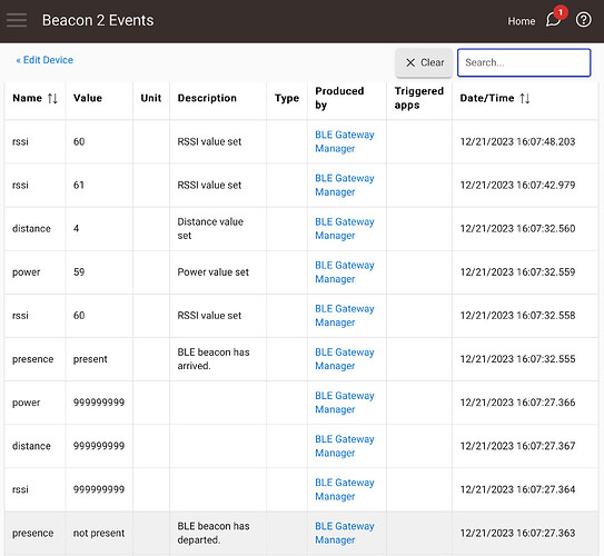

@ajardolino3 I discovered that thread few weeks ago, and immediately purchased gateway and beacons. Following your great instructions, everything was setup in few minutes. However, I notice that the beacons are reporting as not present every minutes or so, while they remain few feet from the gateway (see event screen ■■■■ below).
What is going on there?
Thanks!
I submitted a pull request that fixes this exact issue a week or so ago. Not sure of the status.
Thanks for the feedback. I’ll wait for @ajardolino3 to chime in.
Sorry forgot to merge, its merged now. It may take a while for the Hubitat Package Manager to pickup the update.
Doing a repair in HPM should push the update, right?
I don't think that's necessary. And actually, as soon as I merged the pull request, I was able to go into HPM just run an update, and it found and installed the new version.
