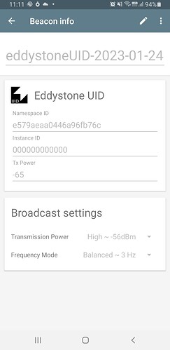

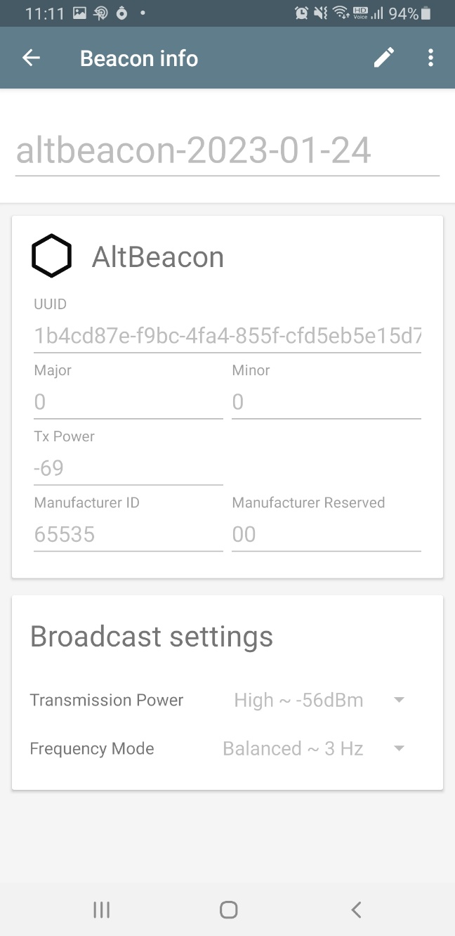

Can you do me a favor? Please simulate an AltBeacon and an Eddystone-UID beacon (if possible) from your android app, and then reply with the "POST received from gateway" from the logs with the device data (containing the UUID, and bold the UUID like you did for the iBeacon). I would like to see if the other simulated beacon types are also missing broadcast data. Then, I can add an option in the app that you can turn on, e.g. "Enable Compatibility for Android Simulator Beacon App", and can make sure it works for all 3 beacon types. Thank you.
altbeacon
dev:272 2023-01-29 11:00:03.128 PMdebug[type:auto, mac:************ , rssi:-76, data:1BFFFFFFBEAC1B4CD87EF9BC4FA4855FCFD5EB5E15D700000000BB00]
app:89 2023-01-29 11:00:03.095 PMdebugSending payload to device: BLE Gateway, payload: {"v":1,"mid":4394,"time":24226,"ip":"192.168.86.49","mac":"************ ","rssi":-70,"devices":
[[2,"4E02198DA251",-76,"1BFFFFFFBEAC1B4CD87EF9BC4FA4855FCFD5EB5E15D700000000BB00"]]}
eddystone uid
dev:272 2023-01-29 11:03:56.299 PMdebug[type:auto, mac:************ , rssi:-61, data:0303AAFE1516AAFE00BFE579AEAA0446A96FB76C000000000000]
app:89 2023-01-29 11:03:45.137 PMdebugPOST received from Gateway: {"v":1,"mid":4434,"time":24448,"ip":"192.168.86.49","mac":"************ ","rssi":-72,"devices":
[[3,"EC6426EF155D",-38,"07FF4C0012020000"],[2,"518F7ECEB790",-56,"0303AAFE1516AAFE00BFE579AEAA0446A96FB76C000000000000"]]}

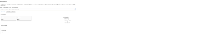

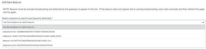

altbeacon and eddystone uid do not appear in the list.

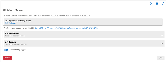

I released a new version 1.4.0, which should be available later today within the Hubitat Package Manager. This new version adds an option that you can turn on called "Enable non-compliant device support". When enabled, it allow the app to detect iBeacon, altBeacon, and eddystone-UID beacons broadcasted using the Android Simulator Beacon app. I tested with the beacon data you provided and they now show up. If you install this new version, you can revert the changes you made to the gateway driver (although if you leave them, it will still work, since the data is already augmented correctly). Updating from the package manager should also revert the changes you made for the device.

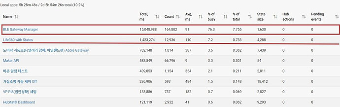

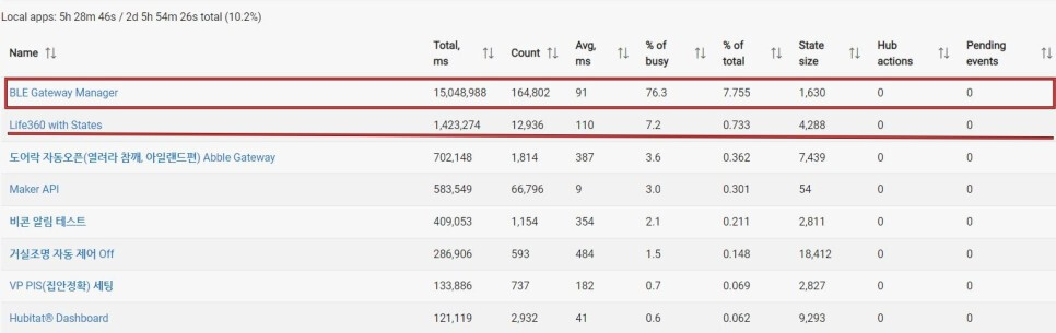

The problem of sending too much data to the HE hub is actually difficult to use in HE.
I think it would be good to receive only connected and non-connected data like contact sensors in HE.
Is this possible?
The link below is the user I set up using your Apps & driver. It's in Korean, so you'll have to see it after you translate it.
All of that data comes from the gateway. You can adjust your gateway settings to control what data is sent to the hub. You can also control how frequently the gateway sends data to the hub.

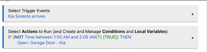

Not sure what you mean by difficult to use. The app will track when the beacon arrives and departs. If you trigger your home automation on either the arrival or departure of your beacon, that should be pretty easy to configure. If you can explain what you are trying to do, perhaps I can suggest a way to setup your home automation rules.
Here is a simple example of how to setup a rule upon arrival of a beacon:
