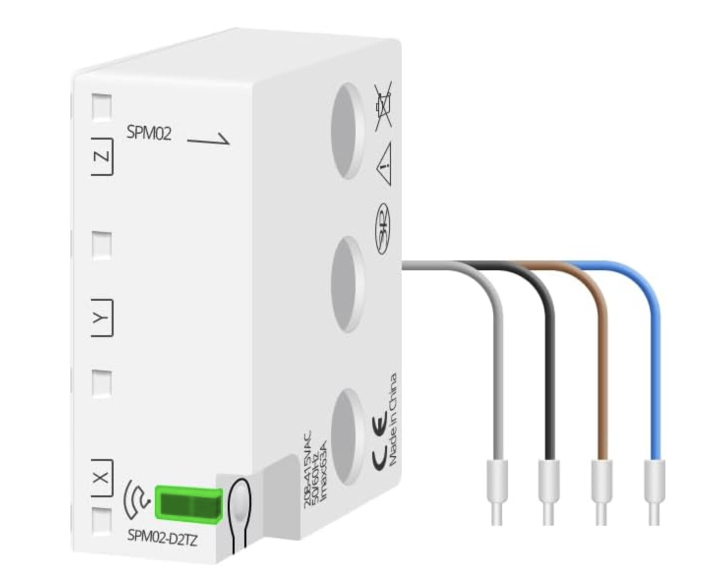

This is a custom driver for the BITUO TECHNIK SPM02X001 smart energy monitor for 3P+N systems, a Zigbee 3.0 clamp (CT) meter also sold as SPM02X and as the Zemismart SPM02-3Z3. The device implements the standard Metering and Electrical Measurement clusters (no Tuya data points), but Hubitat has no in-built driver for it, so out of the box it pairs as a generic "Device" and shows nothing.

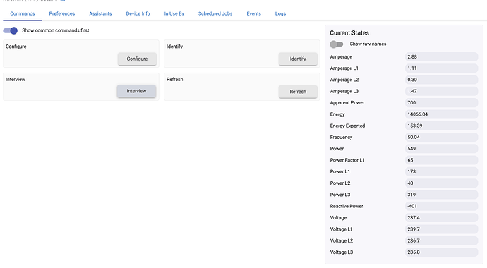

  • the driver binds both clusters to the hub and configures attribute reporting on the device, so the hub is not polling - the device reports on its own whenever a value moves by more than a threshold and at least once per maximum interval; intervals and thresholds are configurable in the preferences,
  • multipliers and divisors are read from the device instead of being assumed; the one known firmware quirk (power divisor advertised as 1000 while the power attributes are already in watts) is handled by an auto-detecting "Power scaling" preference that can also be forced either way,
  • every Configure Reporting response is checked and rejected attributes are logged as warnings,
  • an "interview" command discovers the attributes and commands the device actually supports on every cluster, reads the Basic cluster and reads back the reporting configuration - results go to the log at info level.

Screenshots
