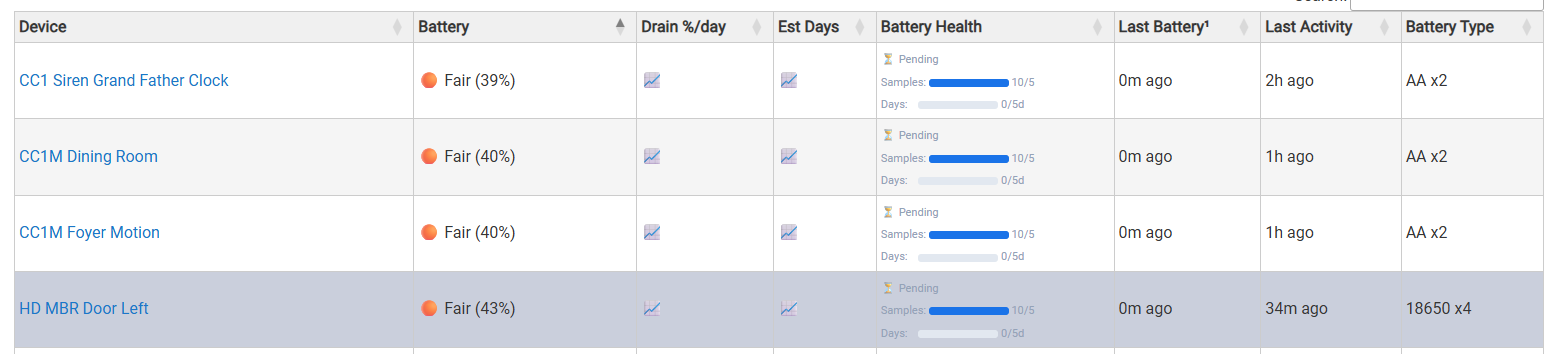

The battery report continues to show 0-days under battery health for all but 2 devices. I upgraded to version 2.4.15 a couple of days ago, so I am not sure why it continues to show 0-days.
Any help would be greatly appreciated.
Marc
@marcaronson408 Send me your application state details.
click the (i) up top right. Scroll down to state details. copy and send to me via DM.
Verify the version your on as well.

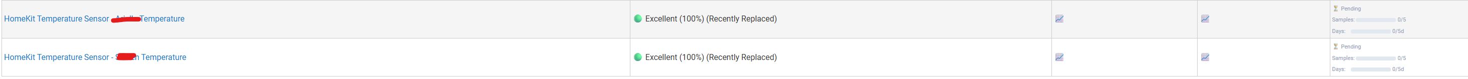

@JdThomas24
Something changed with this last release. I have 2 devices that now show that their the batteries have been replaced and stats are now pending. The app shows that this was an automatic replacement. The thing is, I haven’t touched these devices at all.
  1. What protocol are the two affected devices (Zigbee, Z-Wave)?
  2. Did anything happen around the time it triggered β€” hub reboot, mesh heal, power outage?
  3. What does the app show as the "before" and "after" voltage/percentage for those devices?
They are Ecobee sensors brought in via the HomeKit Integration.
I have 2 others and they are showing as expected.
Only thing I did today was update the app and my hub.
It's not a huge deal. It's possible something may have occurred while I was not home earlier, but I have no indications of such. I will leave things as is and see what happens when the 5 day period passes.
Releasing .22 to add safeguard for this behavior. It will not be retroactive, so the 5 day period will need to run for those devices.

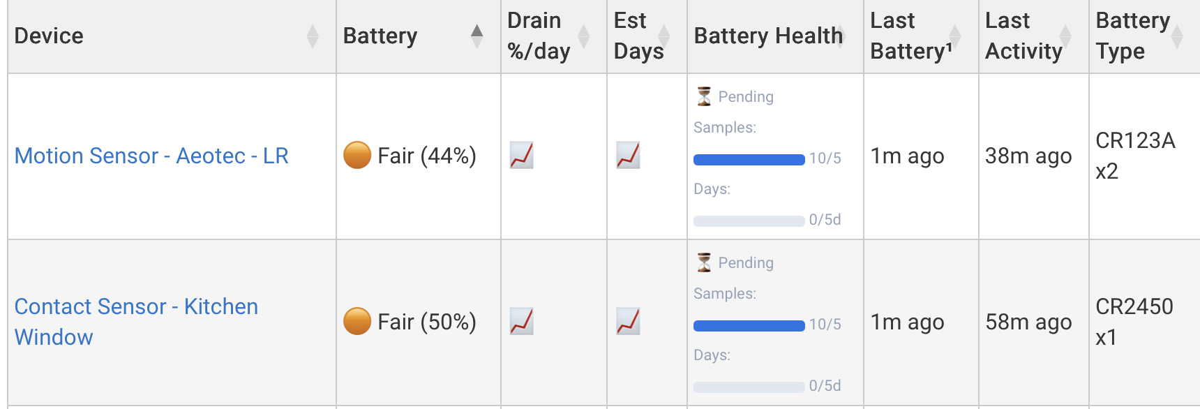

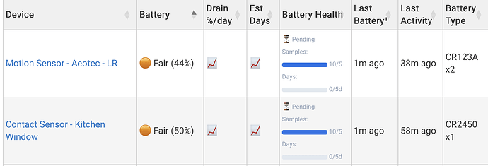

All of my devices are showing 10/5 samples, 0/5 days, no drain %, and no set days. Some of the devices have had the number of samples increase until they are now all at 10/5. But days always remains 0. This has been true for the last several updates of the app.
Can you just confirm that this is correct and I need to keep being patient?
Send me the Application State from your app.
Go to the (i) in top right and got to Application State.
Copy all of that and send it to me.
