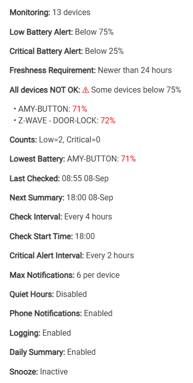

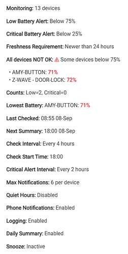

Battery Level Reminder How this app works:
Made By: WW & Claude Ai
• Checks every X hours starting from the user-specified time.
• Sends phone alerts if the battery is below the threshold
• Sends alerts including critical alerts for very low levels.
• Only alerts if the reading is fresh enough or has changed since the last check.
• Supports individual alerts with customizable maximum repetition control.

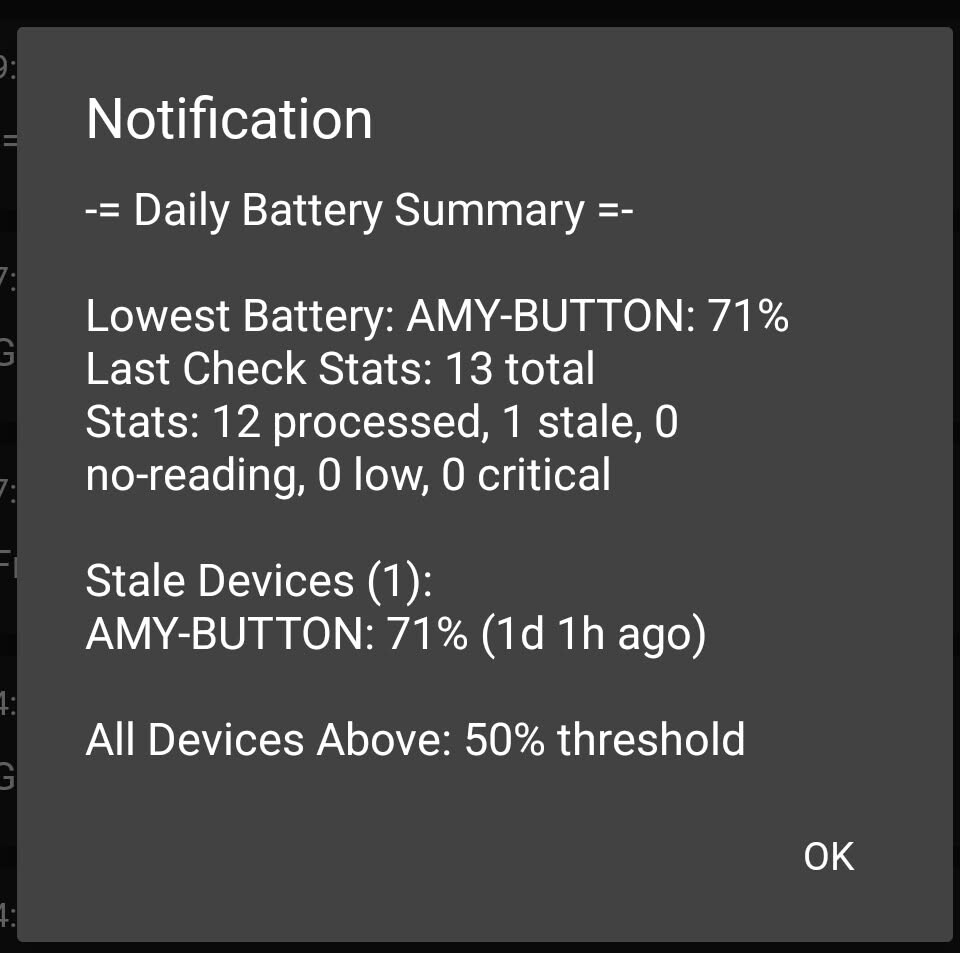

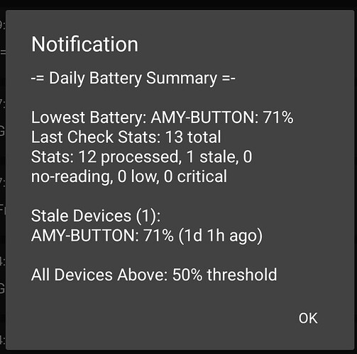

• Provides a daily phone summary report at the chosen time.
• Automatically resets counters when battery level returns above the threshold.
• Includes optional quiet hours to suppress notifications.
• Phone notifications can be turned on/off .
• Stale Devices in daily report and App Page.
• Offers optional logging.

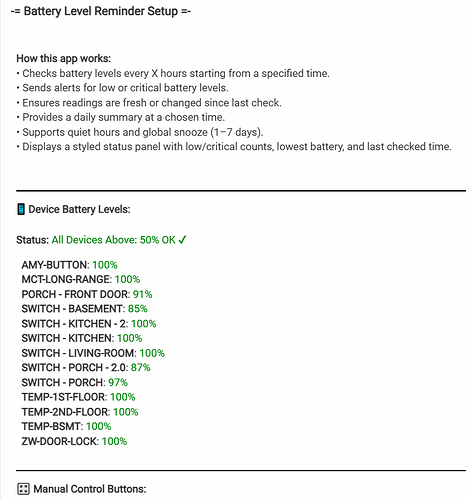

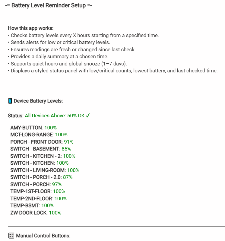

    page(name: "mainPage", title: "<b>-= Battery Level Reminder Setup =-</b>", install: true, uninstall: true) {
        section("<b></b>") {
            paragraph """
<b>How this app works:</b>
• Checks battery levels every X hours starting from a specified time.
• Sends alerts for low or critical battery levels.
• Ensures readings are fresh or changed since last check.
• Provides a daily summary at a chosen time.
• Supports quiet hours and global snooze (1–7 days).
• Displays a styled status panel with low/critical counts, lowest battery, and last checked time.
        section("<hr style='background-color:#000000; height: 2px; border: 0;'><b>🎛️ Manual Control Buttons:</b>") {
