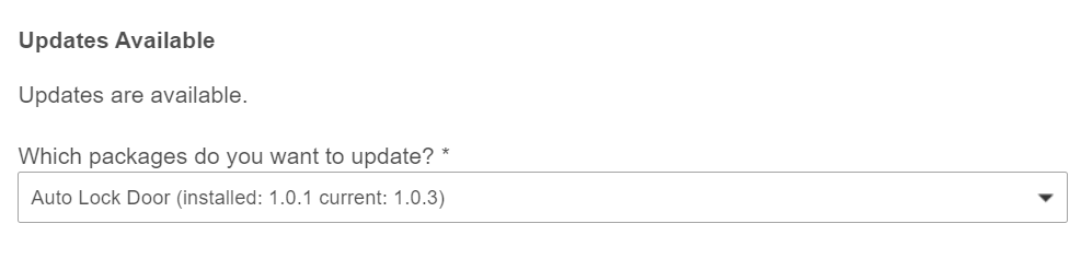

Just in case you may have followed suit and forgot to click Submit, just wanted to let you know I'm not seeing an update in HPM.
I assume it just takes some time, and not in a rush, but wanted to follow up just in case.
Thanks again for this app.
He'll have to change the version number for HPM to push the update. I didn't want to do that in his code though because I didn't want to break it. You can just import it from GitHub if you want the changes now. A repair might also do it for you.
Thanks...no hurry, just mentioned it in case a step had been accidentally missed.
